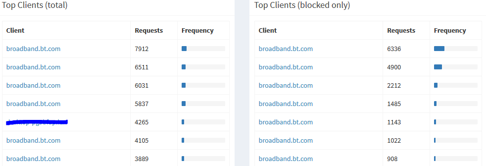

1. "broadband.bt.com" is showing up as the domain name for all ipv6 IP addresses (ipv4 IP addresses show the domain name just fine).
My setup consists of the BT Smart HUB 2 with DHCP disabled and using my rpi as the DHCP server. Does this have anything to do with the stateful/stateless mode in the router ipv6 settings?

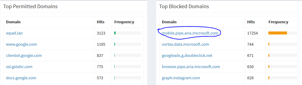

2. 17000 hits in 24 hours seems a bit high for this Microsoft address, is that normal?
