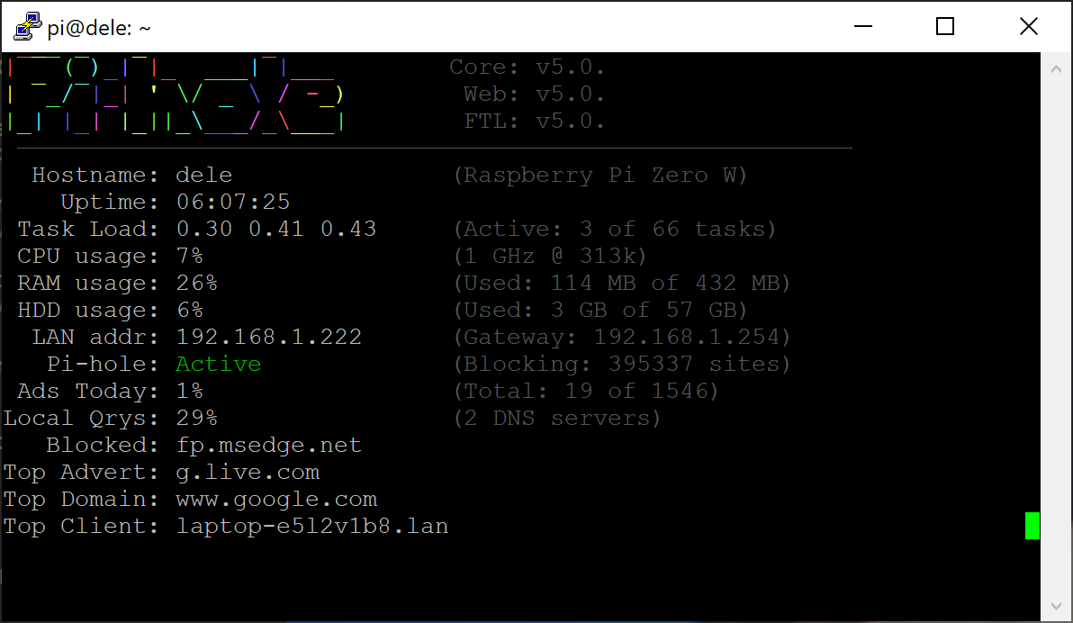

I'm running it on a pi zero w, seems happy enough.
