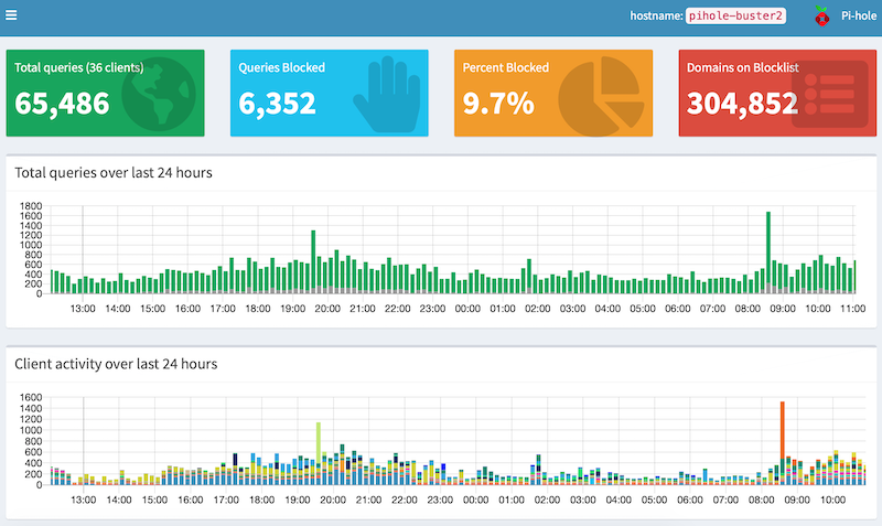

On a plus side, I have two spanky rebuilt pi-holes, both on buster and both configured identically.
DHCP range split between the two, each one gives out itself as primary and the other as secondary.
I know, right. I've spent all day with the two dashboards open on a screen, it's just fascinating to keep an eye on what's happening.
