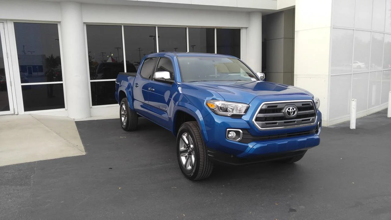

Lets put it in here too! Pictures at dealership, will get some better ones.
2016 Toyota Tacoma Limited
