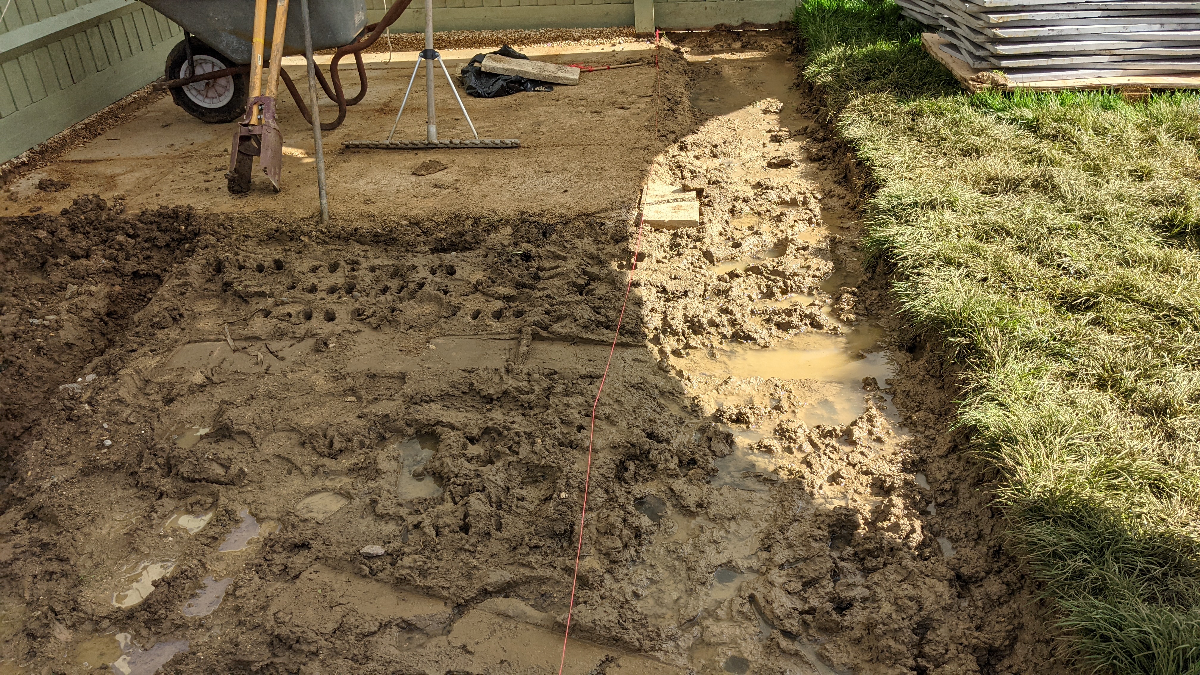

Went about 50/60 cm down, not draining so far
(I made a seperate hole for the test)
This doesn't even look this bad on this pic :p
Do a test hole at least one foot deap by one foot wide put some water in and ses how long it takes to drain.
Yep, just took the post hole digger to an area, filled it some way and its not gone anywhere yet..I'll check it in a couple of hours.
Thinking out loud i either need to go far far down or I really don't know, go too far down and it all needs to be reinforced I believe?

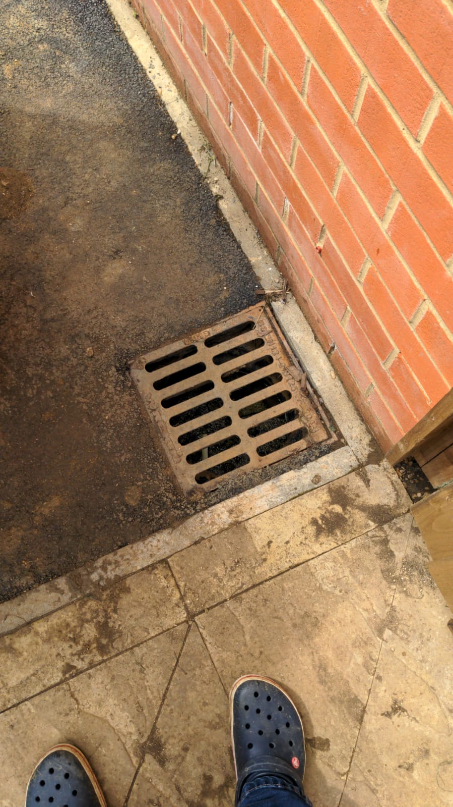

I mentioned this the other day:
(Yes yes, I have Crocs)
From what I can tell looking at it its just a small pit, there is a bit where it shoots off to the left (this appears to be covered with something, may just be a filter of some type) that goes to a small cover, under that is some form of piping, no idea where from as theres no pipes there down the house....
That is right next to the house, embedded in tarmac, along with a laid path out the back of the house.

You need to do that test hole to see of you can break threw the clay layer.
Take a look at the plans for your house it mite give some indication of where the pipe runs.

I've done the test hole, I'm waiting to see if it drains :) Which was done well over an hour ago, not moved at all yet.
Nothing in the plans.
Soakaways don't work in clay. It's too impermeable. It's why they line canals with the stuff. The soakaway designs I've seen have required permeability and infiltration testing to confirm the discharge rates are suitable, and the strata into which they will run. I've not seen one work into clay yet. It's always been sands or gravels. Going deeper won't help you unless doing so reaches underlying strata with more porous material to drain into. Then you need to confirm the water flow into this strata is acceptable and not contaminating an underground watersource or similar (protected aquifers and the like).
Yep, that's why I've done a test hole. :)
There are places it drains more, and places it just sits there for ages

Try a hole tight to the wall of your house, see how far the foundations are, if it's high, dig down the side of the foundations.
Test for water drainage, if it drains away at a decent rate, then maybe just use a French drain along the house?
As above, try this first - technical name is a percolation test (have a read of Approved Document H, there are a few details in there that provide further guidance) - but from memory it's more geared to the provision of a drainage field for a septic tank (where the clean end of the tank discharges into the ground), rather than general land drainage.

Personally I wouldn't even bother doing that test as I suspect that your time will be over 6hrs to drain meaning your test has failed since it's clay ground. As soon as the surrounding ground is saturated any water in a soakaway won't have anywhere to escape to so you'd effectively have an underground rock filled pool in your garden.
Do you know where your current house surface water drains to? Is it into the mains whether it's separate or combined or does it go off to something like a SUDS pond located somewhere around your development? It may be possible to connect into this providing there's still capacity or if other measurements could be taken to reduce the flow into these existing drainage solutions
