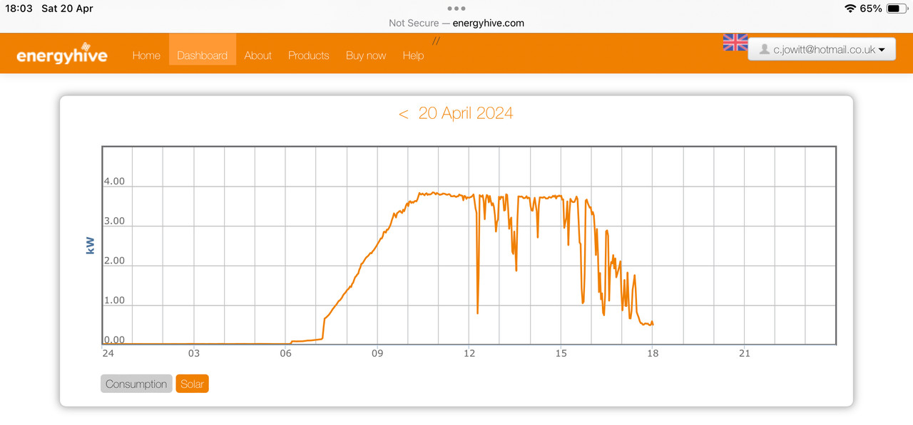

Are you clipping?
The other issue is that it generally rewards dead-south facing panels. Any panels further around than south-east or south-west and efficiency always suffers.Ah, but as @katie279 would say, generation is what really matters
I do agree efficiency is a better comparison, but it's still very much depends on the weather.
Yes, it clips to 3.6…..which is my inverter size, standard string inverter, no batteries and 4.8kw of panelsAre you clipping?
That's pretty good considering. With my 4.8kW facing south east a perfect day in June was 34.5kWh, so you probably lost less than 3kWh there in total.Yes, it clips to 3.6…..which is my inverter size, standard string inverter, no batteries and 4.8kw of panels
I was about to ask if you'd now got batteries then you could offset some of that clipping.Yes, it clips to 3.6…..which is my inverter size, standard string inverter, no batteries and 4.8kw of panels
I only use on avergage 5kwhs a day……battery just not worth it for me. Today so far i have imported 0.8wkhs and its nearly 7pm and im still exporting on 400watts productionI was about to ask if you'd now got batteries then you could offset some of that clipping.

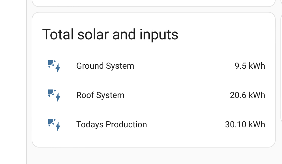

Ive lost about 6kwhs……today. My best day on roof mount only is 24kwhs and based on current figures my ground mount should produce 12+ on a good dayThat's pretty good considering. With my 4.8kW facing south east a perfect day in June was 34.5kWh, so you probably lost less than 3kWh there in total.
Nifty Fifty achievement unlocked.![]()
