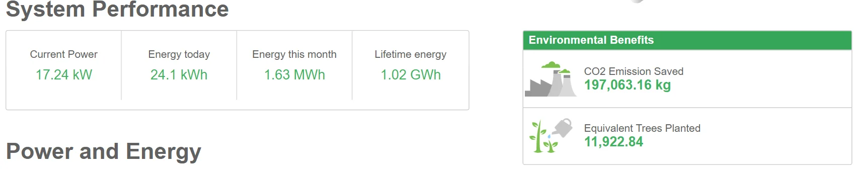

3kwh today
No sun but fairly bright, until just after 3 when we finally saw the sun for a little while before it dropped
Crept my average up but still a fair chunk needed to catch December.
The sun is deffo higher though and wont be long before its above the houses to my South, a week or so I would guess.
Not quite at 1.21 Gigawatts!
That is a lot of energy! How long did that take? Any details on your setup?
