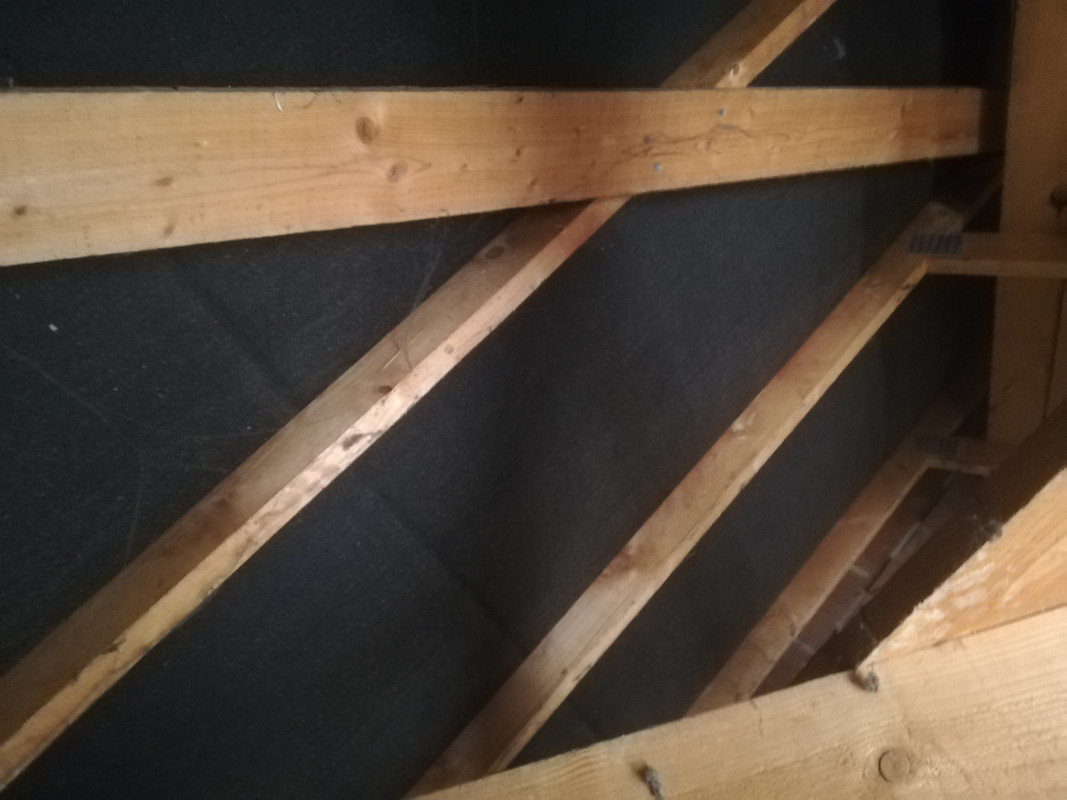

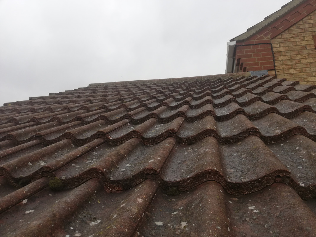

I roughly measured the roof, it's about 2.5m wide, and 3m tall (probably 10% more each way) the type of tiles as per the pictures and the underside is exposed already as it's a garage so it has the wooden supports running down with a membrane in between. The lower photo was taken at a dodgy angle but it is all straight.
You'll want to leave a good 30-50cm on any edge if you can, so once measured you'd have a central bit to play with in terms of space. I have 40CM to the edges on my roof but it's a little tight if you want to be able to traverse the edges once they're up.
Top and bottom I have less but it's just due to space constraints, I probably went a bit too close for comfort but it seems OK.

The most tricky bit will be mouting the panels, its a garage roof so only single story so wouldnt need scaffolding, but would need the right mounting kit for "wavy" roof tiles and ive never done any kind of roofing work before - you can tell as I am sure they are not called "wavy" lol.
For roof mounting, then you would use proper mounting hooks and rails. You need to remove the tiles fasten the hooks to the roof rafters, and then cut a gap in the tiles for the rail support, then put the tile back in place. It really isn't hard, you just measure 37 times cut once, and make sure you've got the correct amount of hooks per panel row.
When I saw the roofer doing the original intall he was using a multitool I guess to chisel/file away a bit of the roof tile underneath so the metal support will fit under without pushing the roof tile up out of its normal angle.
Yes that is the idea, you keep the integrity of the tile/roof covering but have access to the hook for the rails. When I was doing mine I used a small 18v grinder, and that was for two full roof sides worth of tiles, but you could use a multitool with the correct fitting.

The roof is about 3500mm tall. Thats from the very bottom of the bottom roof tile up to the point at the top. The only thing is though, I am not sure how easy it would be to moved the very top roof tile if I needed as its set in concrete/morter to the point of the roof (you can see on the photo earlier), I will have to see if I can find panels that ideally are a meter wide or less and might squeez 3 on in a horizontal orientation, there would be plenty of room down the sides thoough.
