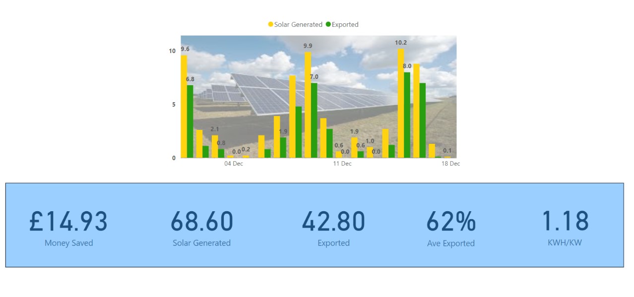

Could this be my worst December yet, so far55.7kWh for the month, and the weather's not looking good. Last December was 79kWh
