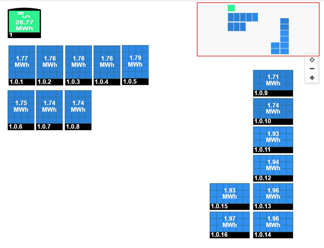

Would that small shadow really make a noticeable difference?
I think its because it would affect the whole strings efficiency and this would be most during the shorter days when the shadow is longest.
With micro inverters, or optimizers - no. However if the panels are wired in series then the section of the panel in shade acts against the whole set of panels it's wired in with.
With 6kw at hand, you could argue it makes very little difference. However seeing how easy the fix is, you may as well do it now.
Watch some of the Ozzy installer guys busting this myth exaggeration. Well I watched a few and came to the conclusion it was not as bad as the guys selling the optimisers are making out. You also have optimisers to maintain once installed. Installer folk may be elsewhere globally like U.S but the two I recall being Australian made me rethink the advertising/marketing angle.
It makes a difference even with optimisers, but its really quite small, but adds up over time. Without optimisers the effect would be higher due to being spread across the entire string.
The below shows totals per panel of our Solaredge system installed in December 2015, the two panels at the top on the right have our boiler flue cast a shadow over them during the day, hence why they are the lowest pair on that roof.
