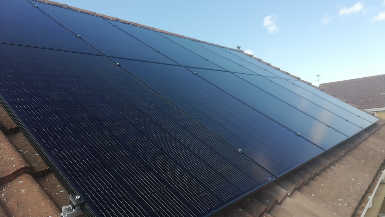

Awesome. Let us know, also the cost. Maybe a picture or make and model so I can look it up. Cheers :)
Those are the panels, they are coming back to put the end caps on the end of the aluminium rails tomorrow.
The hot water tank is 210 litres, that was already part of our heating system I hasten to add, we have oil fired heating because we live out in the middle of nowhere but the hot water tank has an imersion element as a backup, so we got a diverter installed that puts the excess generated into the hot water tank first before exporting it, for which we are getting nothing, at the moment.
Its a 4.5kw system, 5kw inverter, no battery, £7k.
Bit dissapointed with the inverter, its a bit basic in terms of features.
No anti-bird stuff installed?
