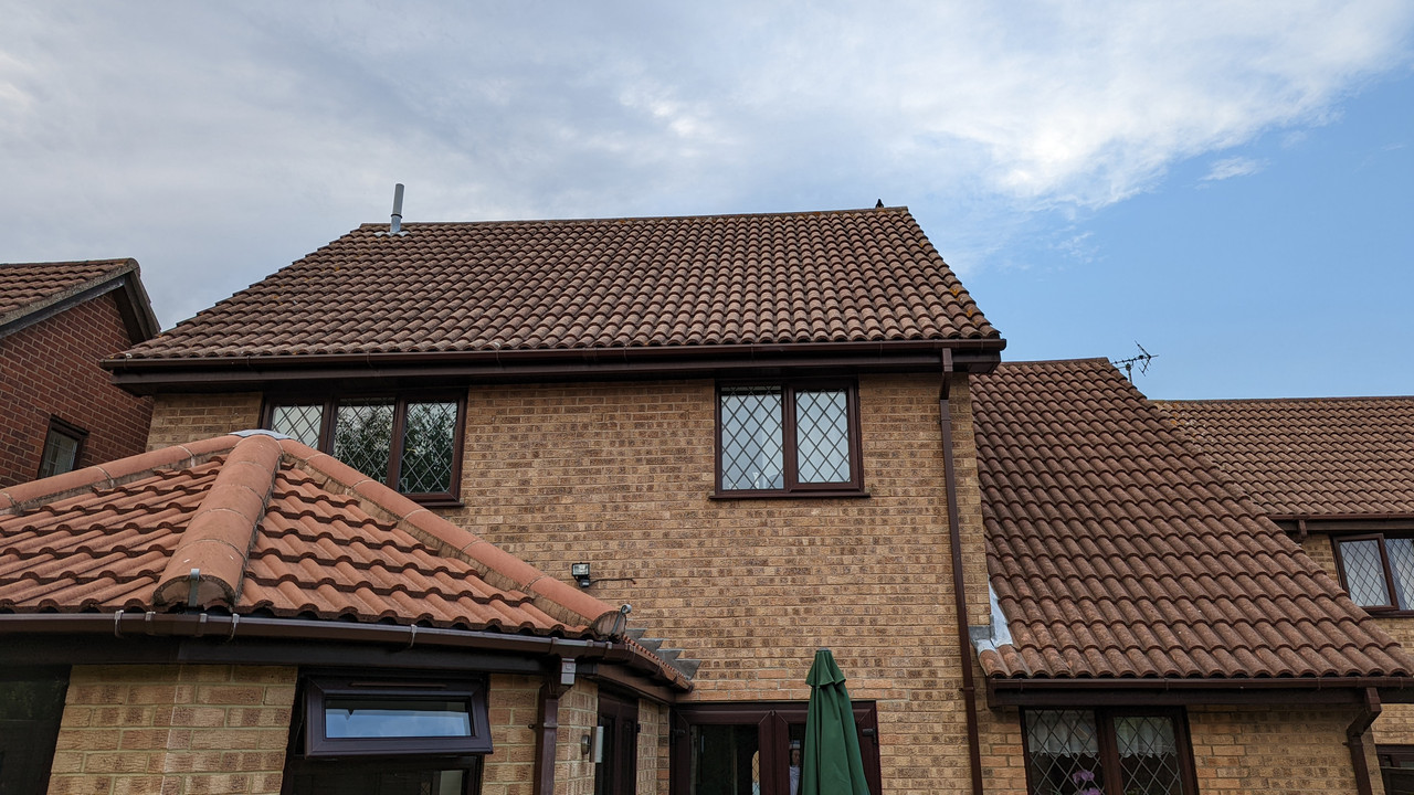

How much are you talking for a decent solar install without battery at the moment?
And can you add a battery at a later date?
Maybe £7k, 12-14 panels. It vastly depends on your roof space.
You can add a battery later, but as I have discovered you need a hybrid inverter for a battery.
We went solar no battery I don't really regret it.
Yeh, was thinking 7k would probably be the ballpark figure.
Not sure how many panels would fit on our roof.
South facing which helps.

Lower roof would get shading on it from the house, I'd be tempted to go higher one only depending on install size that affords.
Yep, I was thinking this would impact the amount of sun they would get. Probably not the ideal design of house for solar panels :(
Might just squeeze enough panels on the main roof to be worth it though.
House is about 30ft wide in total and I think the smaller roof is about 8/9ft.
You can chuck on optimisers or whatever to help out but it will get less sun by virtue of shading than the main ones would.
