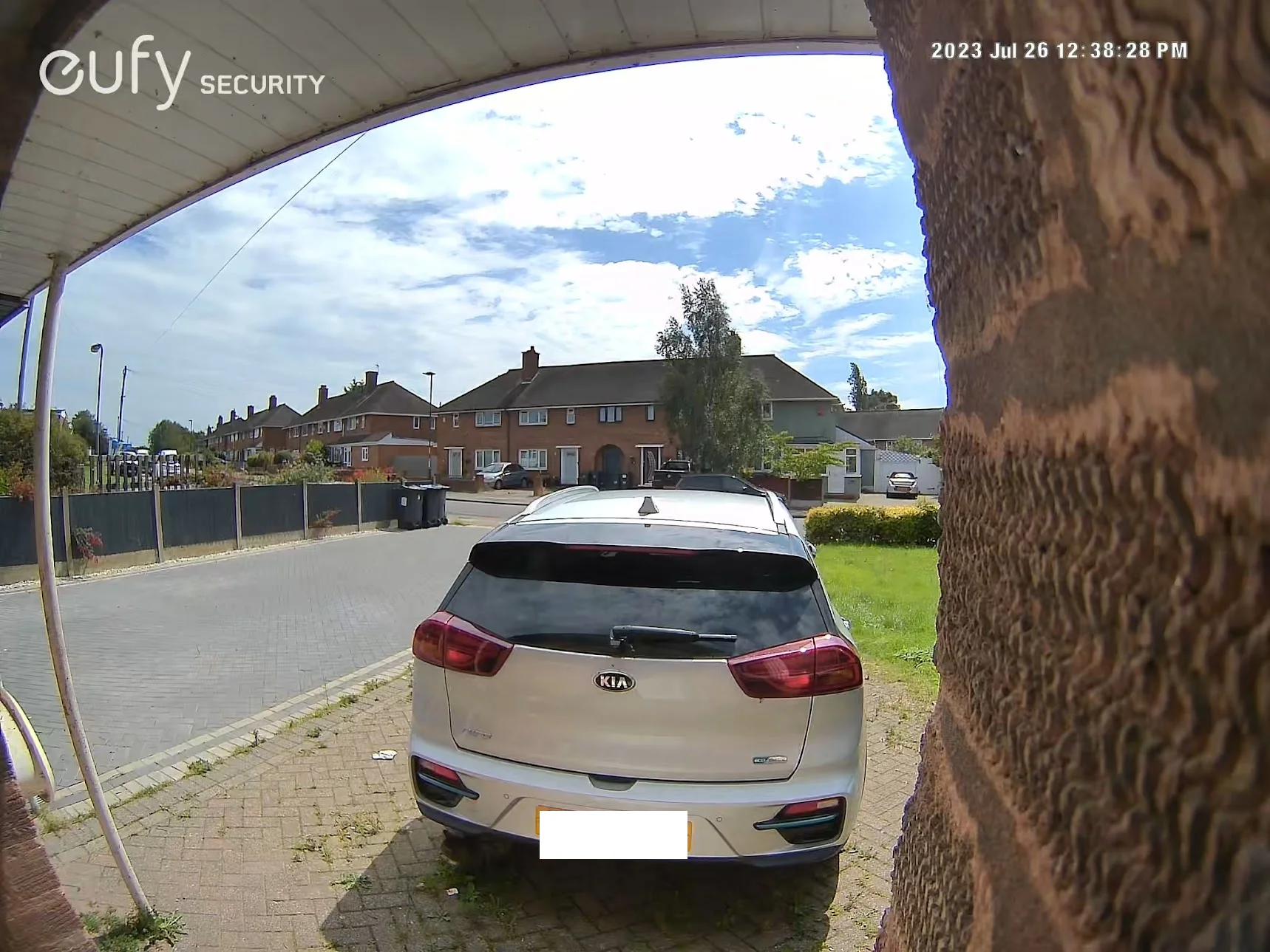

Woke up to a notification from the doorbell camera, to see the neighbours coming in with a couple of bikes at 4am. Thinking "random time to go out for a ride", until they popped over this morning and told me some local darlings had hopped their fence and tried to nick their girls' bikes...
Have been thinking of adding a couple of extra cameras for a while, so now seems a good time to actually get on with it.
We currently have:
Eufy 2k doorbell camera
"SV3C" branded (basically some generic Chinese brand) standalone camera overlooking the drive (see photo below).
I picked up a couple of additional Eufy cameras in the Prime Day sales - an outdoor cam pro, and a floodlight cam. The idea being to replace the existing dumb PIR floodlight and generic camera with the floodlight cam, and put the outdoor cam under the eaves for 24/7 recording (which the floodlight doesn't do :mad:), unfortunately the car blocks a lot of the view from the doorbell. However I've been "um"-ing and "ah"-ing about whether this is the right solution, so they haven't yet been opened and so can still be returned for another 2 weeks.

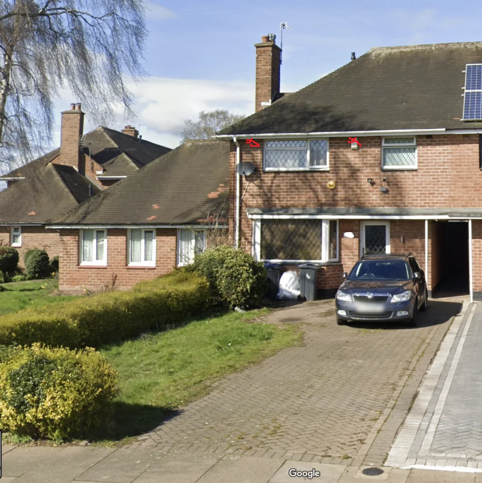

This is the front of the house, where you can see the existing position of the camera & floodlight. The doorbell is mounted to the left (the bay window side) of the door angled towards the right - so it doesn't cover anything on the left hand side.
The new floodlight cam was going to go where the grey junction box is below the existing camera, and the 24/7 outdoor cam in one of the red squiggles.

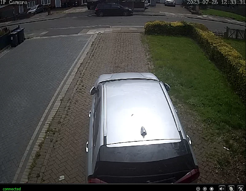

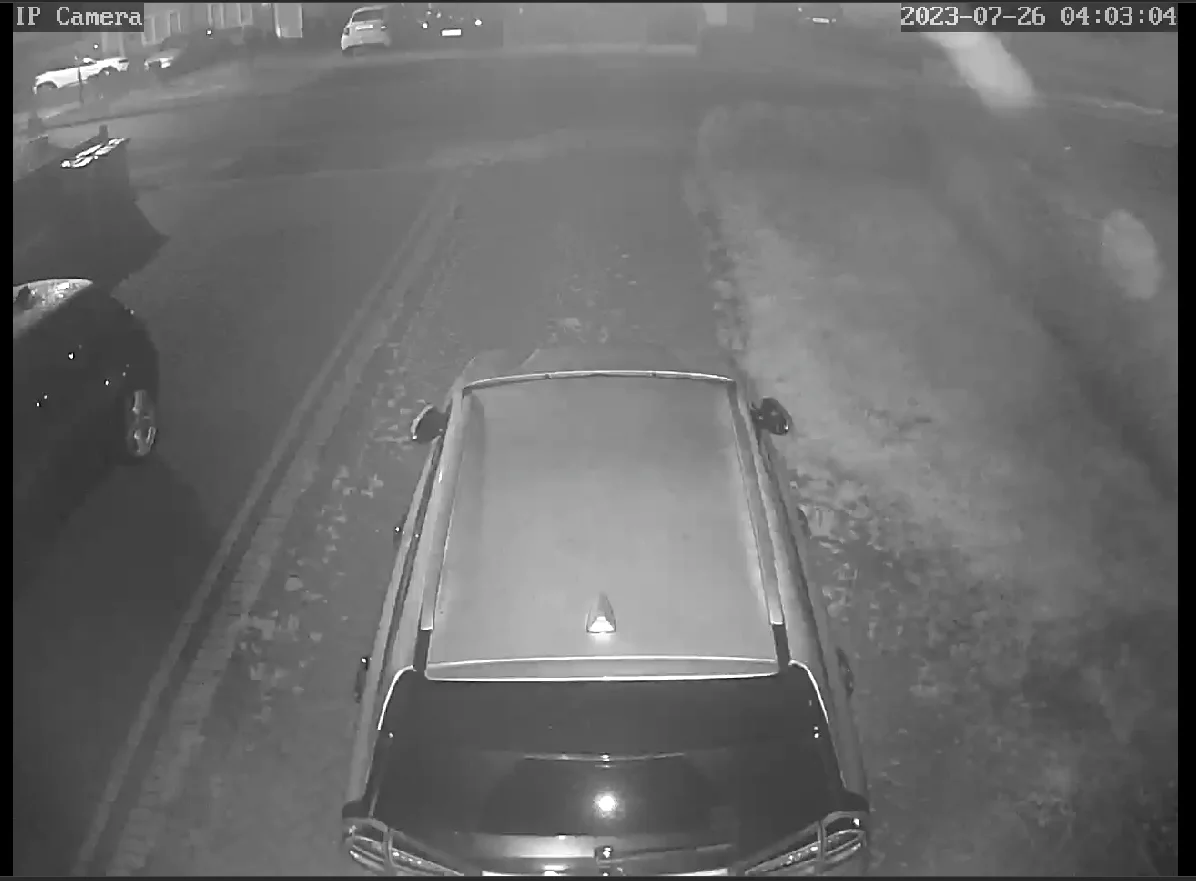

What we can see currently:
From the camera (as you can see, the quality isn't great):
Doorbell in daylight:

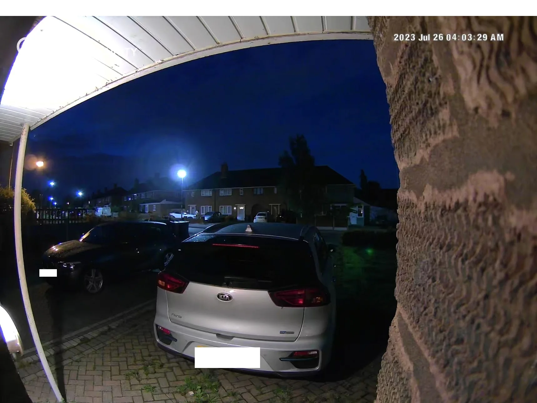

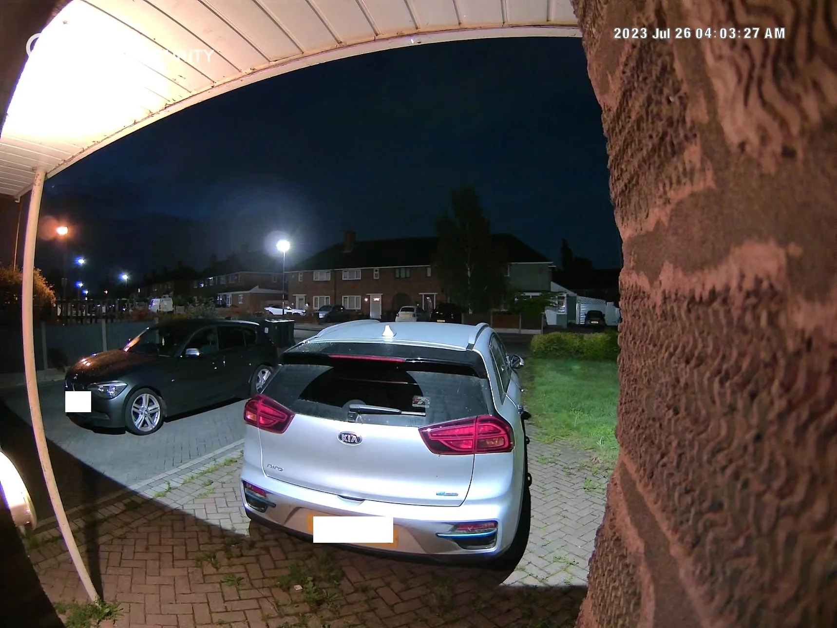

Doorbell at night with floodlight on:
Doorbell at night with floodlight off:

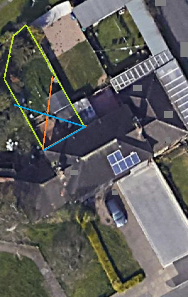

Possible camera positions for back garden.
Lime green shows the boundaries.
On the right/NE side, the fence is ~7ft tall (this is the neighbour whose bikes got nicked).
On the left/SW side, the fence is ~4ft tall, about half way along (within the blue arc), and past that point there is a huge bush (no way anyone could get through it).
At the back, the fences are ~4ft tall - this is probably the easiest access point.
At the apex of the blue arc, there is the back gate, and the square you can see below that is a flat-roofed shed - probably climbable, so another potential access point.
