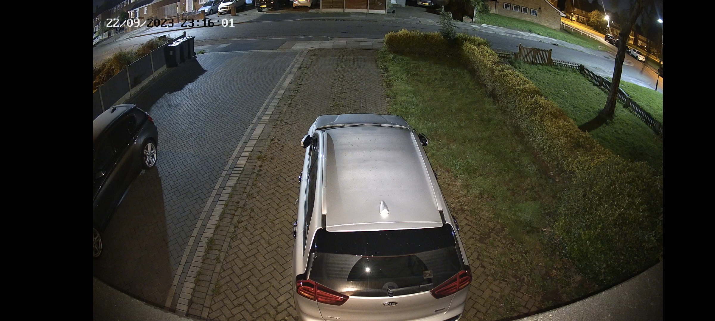

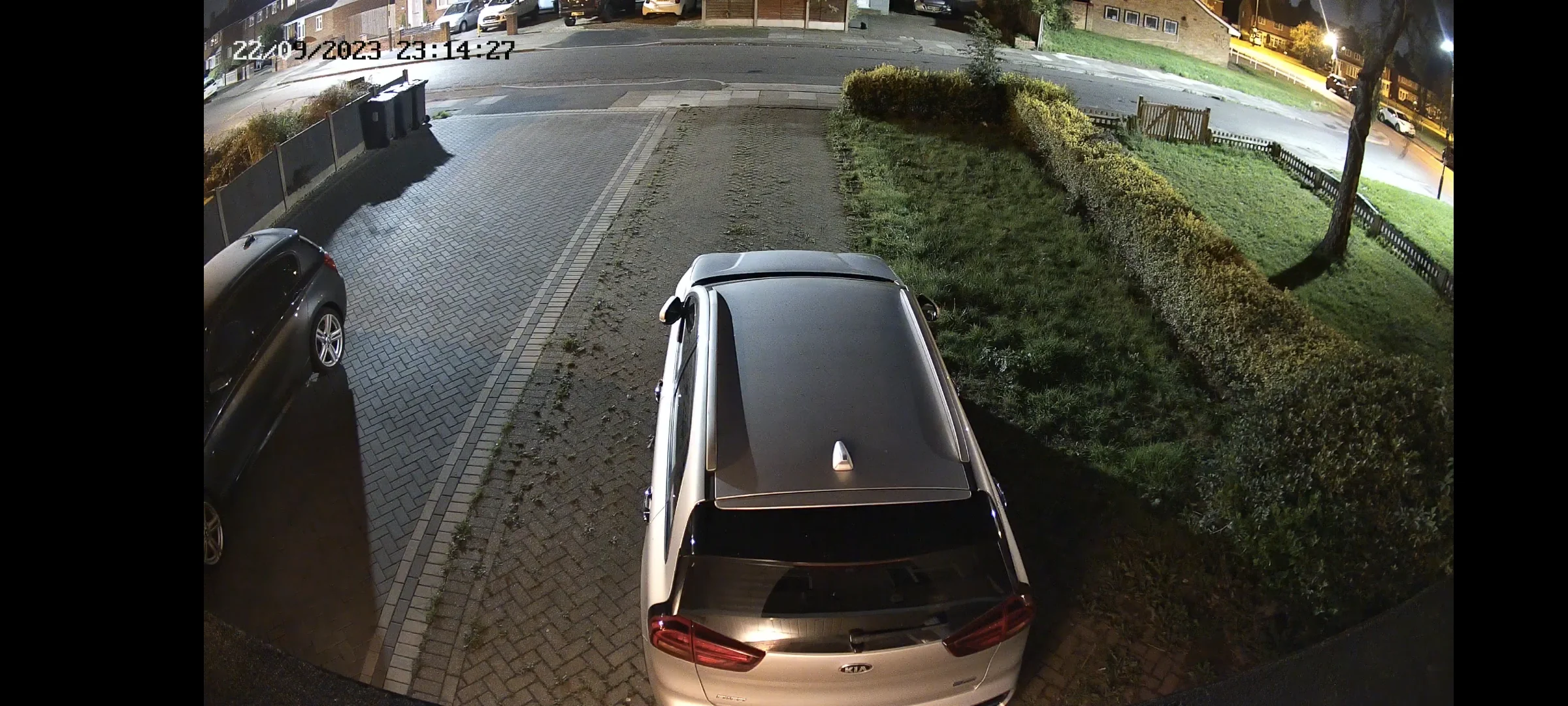

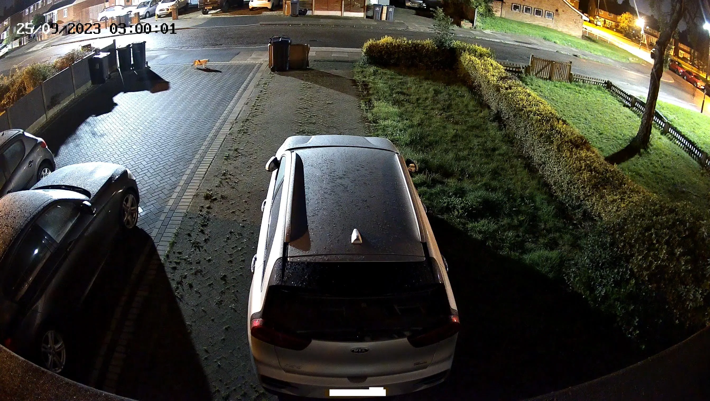

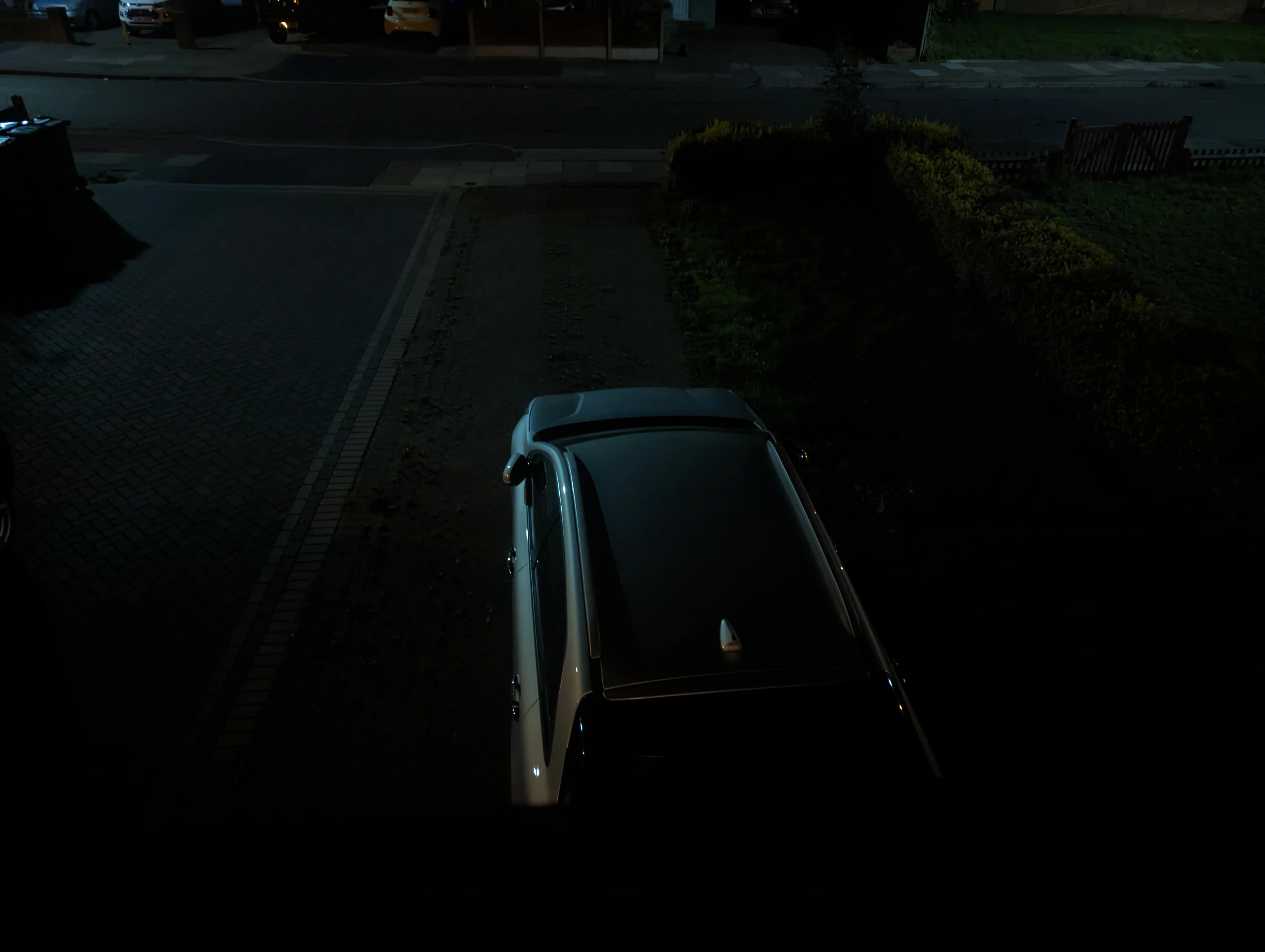

Was meaning to reply to this earlier, but only just managed to get mine installed over the weekend.
Here are a couple of shots from a DS-2CD2347G2-LU - that's the 4MP one, with a 2.8mm lens - to be honest, the 4mm lens might have been the better option, as you can see it covers a lot of the neighbours' drives too.
There are quite bright white LED streetlights along our road, so there is plenty of ambient light, we also have a couple of porch lights which run at 20% from sunset to midnight, and come up to 100% at any time if any motion is detected on the drive.
Street & porch lights only:
Street & porch lights + camera spotlight:
Street lights only:

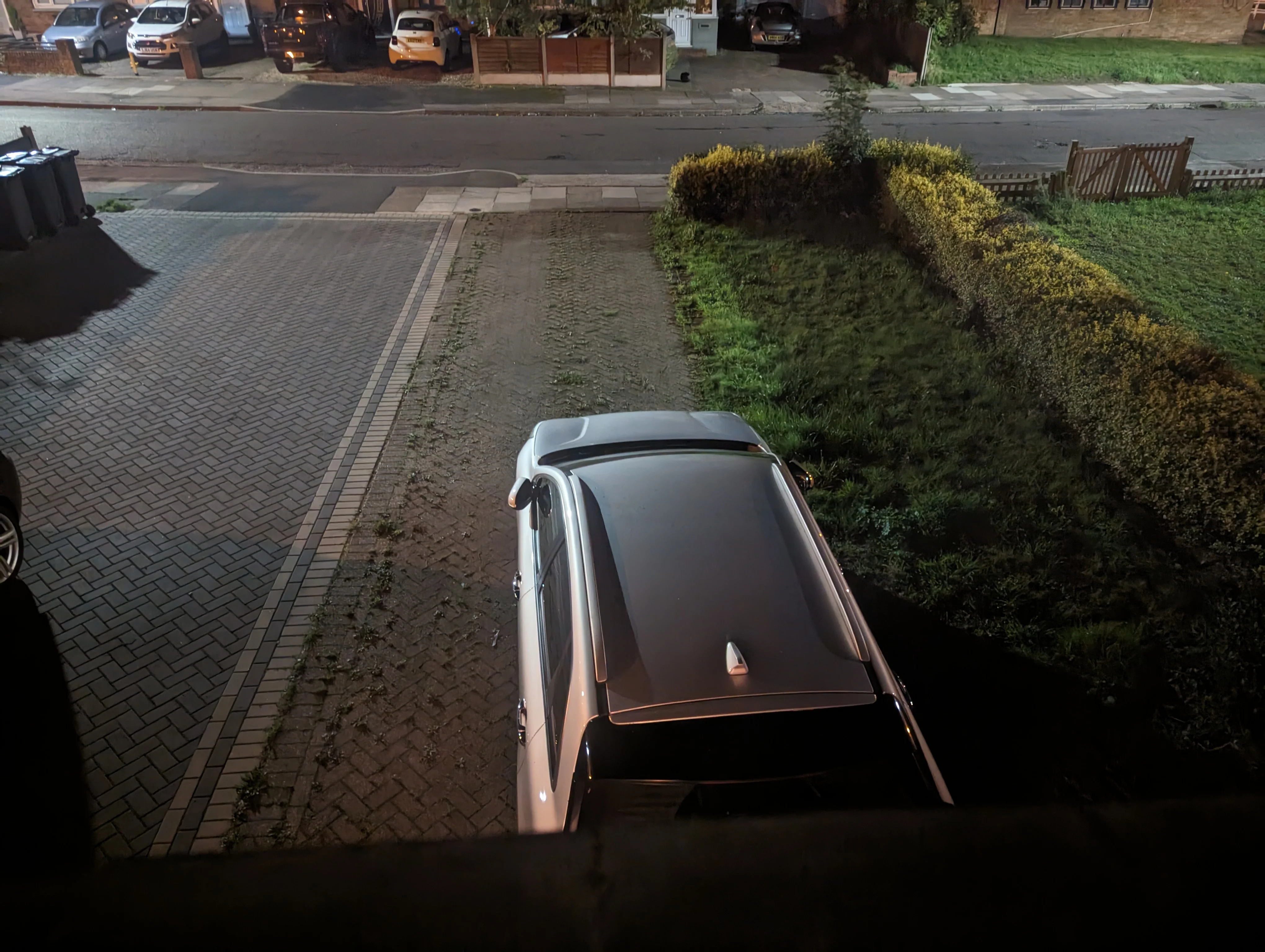

For comparison, here are a couple of photos from my Pixel 7 from the window just above the camera:
Normal mode:
Night mode:
Look at my post 4087
It seems they are very dependent on the level of ambient light - mine above is exactly the same model as yours, and I'm very happy with the night-time quality, but I do have a lot of ambient light, and I can see how in pitch darkness they would be pretty useless outside of the small area illuminated by the spotlight.
Well at least they didn't flog me junk - They never asked if we have street lights - Which we don't -it is pitch black at night.
Definitely better off with the IR DarkFighters then - that's what I ended up installing in the back garden as there is no ambient light to speak of.
Street lights only:
Normal mode:
Night mode:

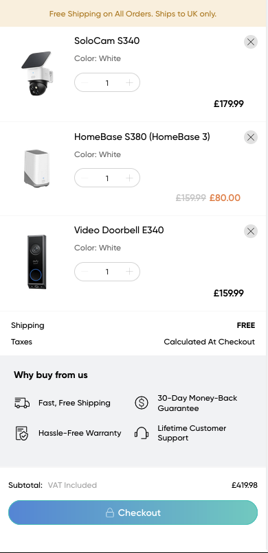

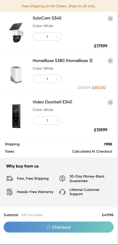

I'm desperate for a video doorbell after moving. I work in the "garage" all day and have zero idea if someone is at the door. We'd like some camera coverage and I would prefer to not have any cloud storage nonsense. While I'm aware of Eufy/Ankers issues with phoning home, I don't care enough to go hard wiring anything. Battery & Wifi is the preference.
So I noticed Eufy have a new doorbell that works stand-alone which I was going to go for, but if you bundle the homebase 3 you get it half price... at which point the new outdoor solar cam seems like a decent addition to cover my back yard.
What do we think? Could I do better for a wire-free solution?

Neither of those cameras will do 24/7 recording - just to make sure you're aware.
I wasn't impressed with the HB3 and ended up sending it back. When using it, the clips from our doorbell were missing the first 5 seconds, and given the delay in activating and recording, that meant in quite a few clips we were missing the person and just getting an empty video, or someone's back as they walked away from the door. Also do you need the dual cameras on the doorbell? We have the single camera version of that one (https://uk.eufy.com/products/t8200) it comes with a plug in chime and a MicroSD card, so no need for the Homebase at all.
The problem with that camera (and it seems most of the current Eufy ones), they have quite limited built in storage, which isn't expandable (I assume pushing you to buy the HB3 as well)
Hmmm, thanks for that, glad I asked. The lack of 24/7 is frustrating. I guess that's an issue with any wireless battery solution and it's asking a lot of a doorbell cam. I mainly just need a video doorbell, I like the E340 as it has a small motion light & colour night vision, the second camera is just a nice to have as we live in a nice remote area where we shouldn't need it but
I might just grab the doorbell and investigate a powered camera + NVR solution, or the wired Eufy option (https://uk.eufy.com/products/e8601321) if I fancy drilling holes and routing cables in the future.
Yeah, unfortunately no battery camera is going to do 24/7 recording as the battery won't last - it's what put me off getting more Eufy cameras in the end :(
