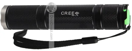

Finally got this from DinoDirect :)
http://www.dinodirect.com/led-flashlight-1000lm-3mode-cree-t6-super-bright.html
When I bought it it was at the bargain price of £9.97 with a coupon code
With a cheapy Ultrafire 18650 @4.2v in it I get these results at the tailcap
High - 3.0A
Low - 0.1A (like a maglite :D)
Strobe - 1.4A (full brightness)
If you overcharge the battery (by accident) it'll drive it at 3.3A :eek:
The beam is very wide with a bright hotspot, it's far brighter than my old Romisen Cree RC-N3. It gets hot, but on a cold day that's a bonus, I can hold it on my nose without discomfort. It tailstands too.
Strangely the spring is on the driver end and not the tailcap, but the batteries still go in+ first.
I can't believe I got this amazing light for under a tenner, so I'm really glad I ordered two :cool:

not sure of the state of charge (only on for an hour) but I'm getting 45min on high before signs of dimming, cell down to 2.7v

Oh, v.nice light btw :)
