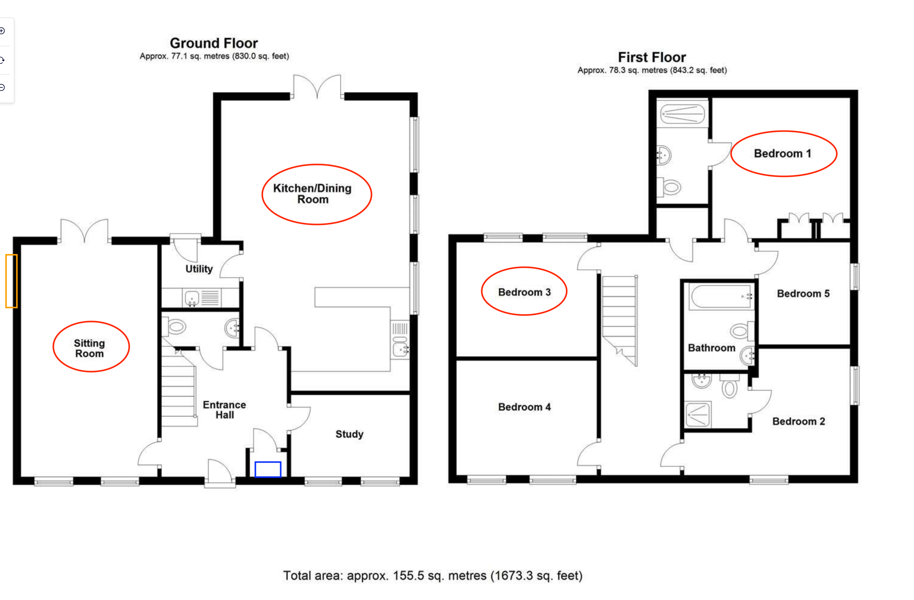

First stage research right now for cooling our house. Looking to gauge rough costs and feasibility.
Really the entire downstairs needs cooling, which is made up of 2 large rooms, my office and the hallway. The biggest thing I want to avoid is unsightly AC stuff on the nice side of the house.
Few questions.
1. What would be the best way to cool the downstairs? I was thinking 2 internal units for living room and kitchen, where we almost never close the doors, so my office could benefit from the cooling? Routing an internal unit to my office isn't going to feasible. It is important as I work from home.
2. For upstairs, the bedroom doors are always closed, and although there are 5 bedrooms we only use 2 for sleeping. Would it be feasible to run AC via the loft into the 2 rooms highlighted, with potential to add the others if/when we need?
Few questions.

You could put all the systems on the outside wall, go up into the loft and feed the two bedroom units - you could do either small cassettes that'll fit in-between the joists or duct them for a seamless finish - you'l have to check make sure you can fit them into the loft though if you want ducted units.
The sitting room - I'm assuming is the drive way side with the little red box on it? You could just come right through the wall and have a back to back wall mount in the centre of the room.
The kitchen and dining room is a bit of work but what I'd do is, take the tubing up the wall into the loft then back out the sofit at the corner and down and into the room either in the corner beside the two windows and out at the side bit of the utility room. Would look better than running external trunking around the external of the building.
The study room as you said would require major work, you'd be looking to get that done when renewing that toilet directly above it and brining the tubing down that way.
The office isn't big, so I'm wondering if the living room and kitchen are cooling, does this allow the office to also benefit from the cooling.
You might need to use a fan to get it really cool but yes, as the house cools generally as will the study.
As with the above post on tips, you really want to run them on low fan speed (low compressor output) and just leave them on for the best efficiency.
It also means you don’t get cold drafts and large swings in temperature.
A bit OT but is that plan slightly wrong? Bedroom 1 has no window? Have they put the en-suite on the wrong side as that is where the window actually is? Same for kitchen where a side window is on the opposite side?
Yea the plan isn’t 100%, windows are all wrong.

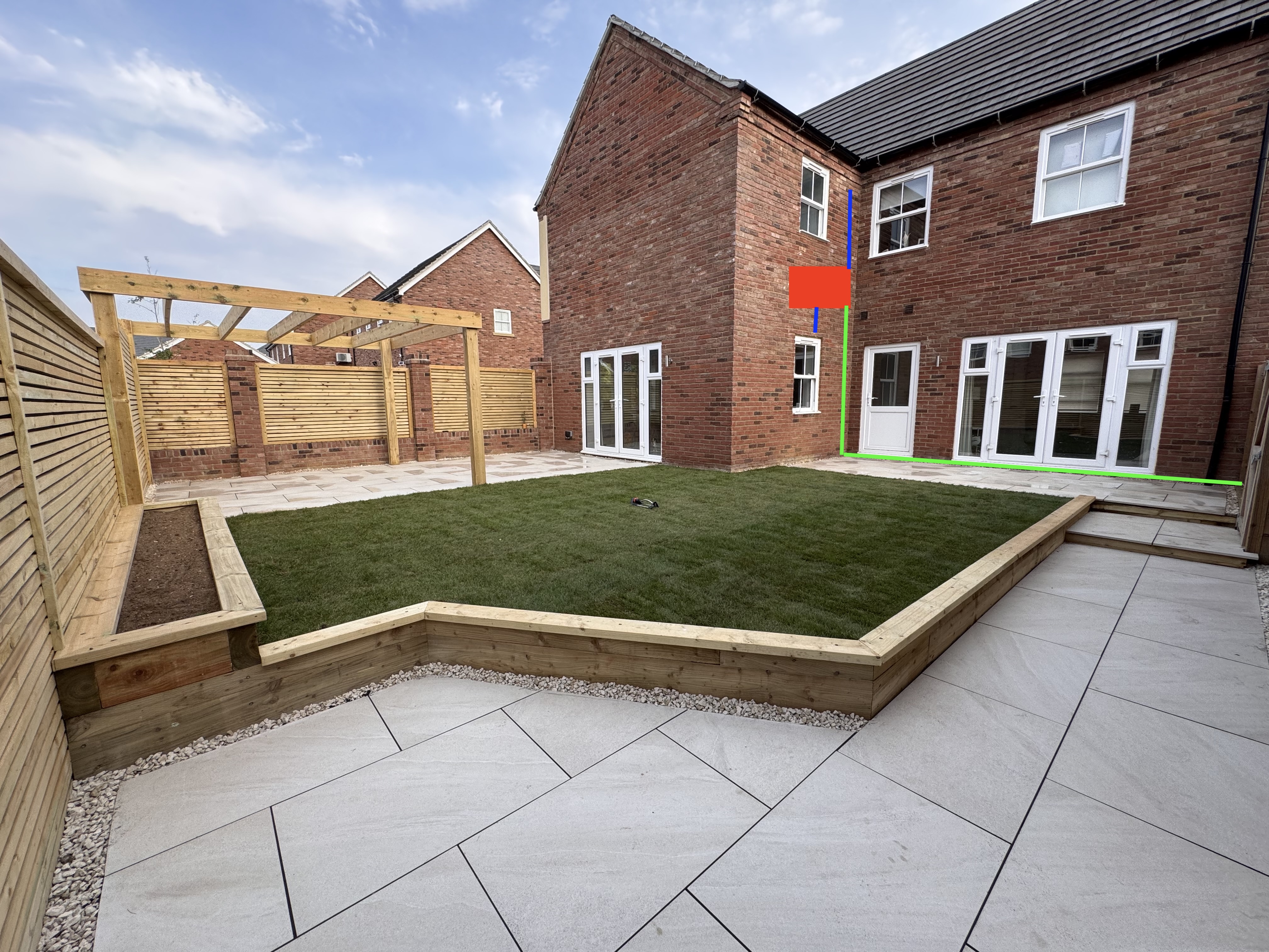

Had the AC guy round and here is what we landed on for balance.
2 external units:
- One on the drive way wall feeding the living room and son's bedroom, easy enough.
- Another unit in the garden as pictured below. Feeds the kitchen and our bedroom by going up and into the airing cupboard which near the corner.
https://i.-ibb.co-/nMTjGVDP/IMG-2271.jpg
Green is the wiring, blue pipes (rough). my sketch.
Just waiting for a quote now.
During the day when I work from home all units should provide good cooling to the whole house with the doors open. During night we close bedroom doors anyway.
2 external units:
