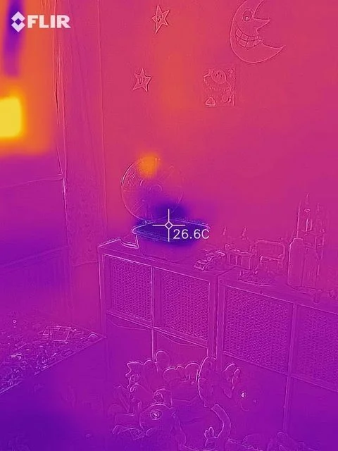

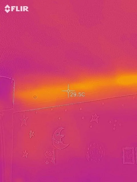

Plan on paying for a split aircon come the autumn.. For now I am doing the best I can with a thermal camera, trying to improve the thermal envelope on our ~1970s build detatched.
The boys bedroom, this warm edge is the loft eaves, where the insulation is kept back...

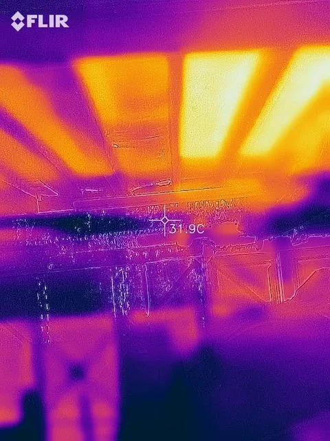

Garage, cant you guess which part of the roof I still havent got around to putting the silver foil bubble wrap insulation onto?

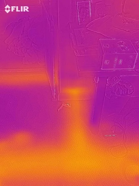

Its quite interesting, can also use it to see where pipes are under the carpets!
Thats looking at the carpet, with the boiler making hot water. Very clear where the runs are!
