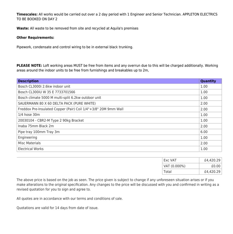

Guys, is this a good quote for what's listed above?
It's 2 indoor units, just a smaller one for the bedroom
Not terrible as it includes two condensate pumps, you need to watchout for those pumps which are in the trunking, can be loud at night i ended up installing a different type in the loft instead.
A Mitsubishi or Daikin system would probably be better, would they quote for that?
It's frustrating to be honest, out of maybe 5 companies contacted for quotes off of check a trade there's only been this company who has sent someone out, despite me informing them I'm disabled and can't really do a video call etc.
This company has said they only do the Bosch units
I’ve heard that those pumps can be quite noisy. Luckily we didn’t need to go down that route.
Supply and demand I guess, there just aren’t many companies doing it. We could only get one out, probably ended up paying over the odds for it. Ours worked out at 2.5k per indoor unit, London prices and higher ended units out of those available at the time, this was a few years ago too.
I wouldn’t go for Bosch either. If they’re forcing that down your throat they must have a deal on it.
If you have to get a pump you can get a mini orange and have the resovoir within the unit itself and have the pump away from the unit in say the attic. If you have to fit one at the unit i’d get them to fit a Silent mini lime aspen pumps blow those stupid saunermann pumps out the water :p
Got my install happening tomorrow with a highly rated local company, not the one that quoted above. I've gone with 2 internal and 1 external Samsung units with a view to expanding to the 4 units at a later date.
