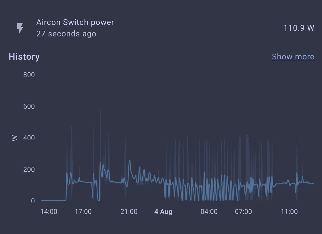

How are you guys measuring usage? Is it built into the outdoor unit or something? I'm assuming the indoor units use very little electricity as to not need measuring (probably a 30W blower each)?
One of these, it's wired to the power to the outdoor unit, the indoor units feed power from the outdoor unit. It's also handy for power cycling the AC on the odd occasion when the wifi units decide to mess about. I also like it as it feeds data into Home Assistant. Can monitor live power usage too.
I installed it at the beginning of Feb this year, have used 234Kwh since then. Which still really isn't a lot in the scheme of things with the amount we use it. The bedroom AC still gets used all through winter as my wife and I both love a cold bedroom.
