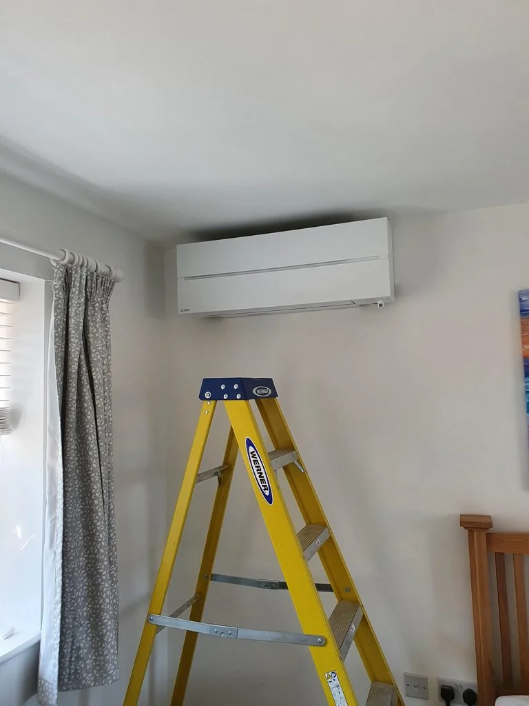

So, our single 3.5kw upstairs unit has been in for a while now and working a bit harder over the last few days. Bearing in mind I originally planned a second unit downstairs, which isn't in yet, it's doing amazingly well.
Outside is 31 (ignore my location, I moved and I'm actually in the SE, Kent). On a day like this the house would usually be high 20s and wouldn't cool much overnight.
The single unit on Eco mode is holding upstairs at 21, downstairs is 23/24. The fan isn't running at full speed. I think it'll take a while to cool if the house was ever left to get hot, but we're just leaving it on all day so it stops the heat build up in the first place.
Very, very happy. We've also had some amazing nights sleep with the reduced humidity and cooler temps. We turn it off overnight as we just don't need it running once everything has been cooled.
I genuinely don't know if we'll bother with the second unit. I'll probably hold off for now.

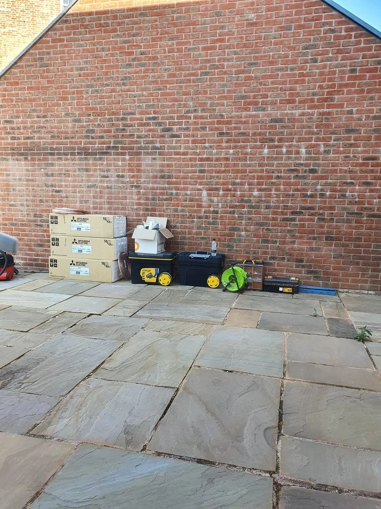

Split AC turns up this weekend, been talking about fitting one for ages and ditching the portable unit, baking my ***** off in the home office today was the last straw.
Two 3.5kW units going in upstairs, piping to be run through the loft and to a corner of the house out of the way, was going to go Daikin, however the Mitsubishi R32 multi split caught my eye instead.
When all said and done inc the two 3.5kW indoor units, one outdoor, pipework, condensate pump, external trunking, cables, clips etc etc the price is looking to be just under 2k.
Going to be interesting fitting it all..................
If this turns out well then the main downstairs and remaining main upstairs rooms will get a 3 / 4 unit split installed when the extension gets built.

Will need to system vacuum tested before gassing it up, however you can do that yourself too, btw will get back to you on the "how hard can it be point", but not looking forward to working in the loft again.
Save a lot of dosh doing it yourself! What indoor units are you getting?
Don’t forget to put the fire nut on before doing the flare!
Lost count amount of times I have done this :(
Do you own a vac pump?

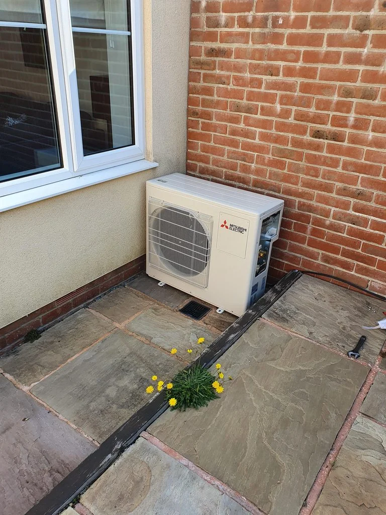

My install begins! :D
The outdoor unit was going to be wall mounted but actually putting it there, it basically fits perfectly on the floor, so in the end opted to basically attach it to the slabs below.
If I come to re-do patio some time the system will need to be de-gassed, moved, patio done, then probably put back on anti-vibration feet. Bit of a cost to doing that, but I think having it nice and low down like that will be for the best.
Originally they were charging me for the wall mount, so no idea if I should ask for that back, or if the added hassle of mounting to the floor basically cancels that out.
Woohoo! Looks good so far. The internal units are good looking units. I still like the look of mine though :) I originally wanted my external unit on feet and not wall mounted but the same as you have mentioned, I thought I might want to change the patio in the future. Mine is still low down, its about 300mm off the floor. The guy brought both feet and bracket him in case I changed my mind on the day. You could check with him about the cost but they no doubt cost very similar. I got the cost of the condense pump (£90) knocked off my install as it didn't need to be used in the end.
