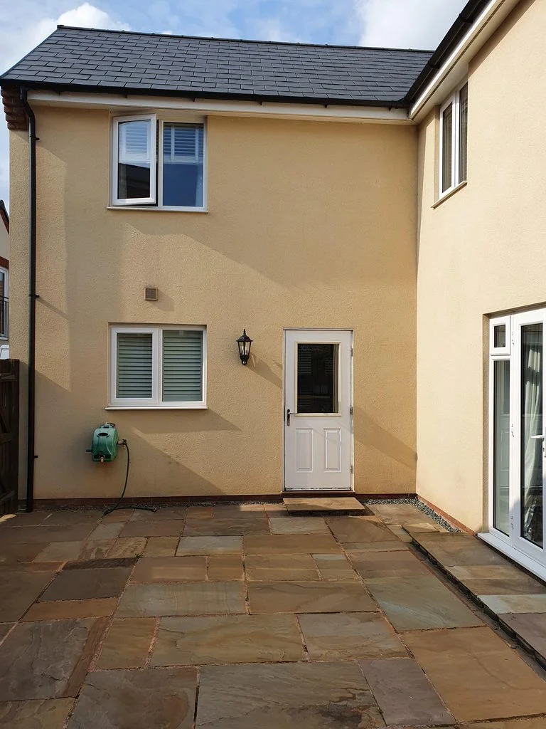

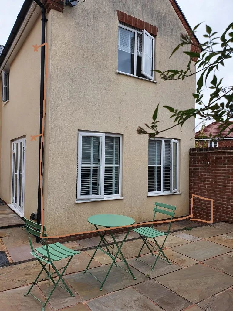

The final idea then would be to site the outdoor unit like in one of my original pics (spoiler image below), with the lounge and study as shown as well, using the vertical guttering to try and mask the pipework climbing the side of the house as much as possible.
For the 3rd unit in the master bedroom, the current idea is that the vertical run there carries on until it gets into the loft space, then the master bedroom unit is run via an "up and over" approach instead of external. This gives me one vertical climb up the external wall.
The lounge and study units can use the guttering there as the escape route for the water removal. The master bedroom unit would need a condensate pump in the loft space to use the same return channel, so the installer has instead suggested feeding that separately to the guttering on the other side of the house, with only the electrical/refrigerant lines using the loft space.
Overall thoughts on whether this plan is good/these units will be happy with that external one etc?
Reminder that the gallery of pics of the back garden is here: https://imgur.com/a/6iH4Crv

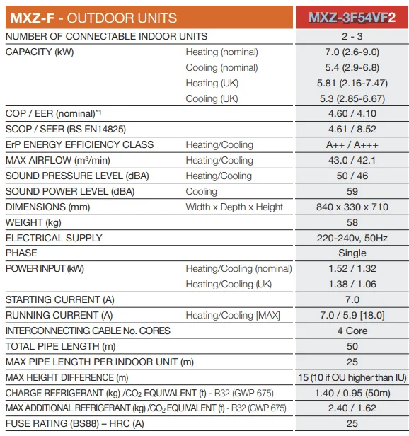

Just trying to work out if that external unit will be happy on the outdoor socket already present.
The answer I have concluded is "maybe?". I'd like to be a bit more certain though.
Wonder if anyone who knows electrics a bit better than me can take a gander at the specs and advise if that will be happy on the standard outdoor socket that has been spurred off the existing downstairs lounge sockets?
From a bit of a look into this with a very limited understanding of how this works, the value under RUNNING CURRENT (A) for Heating/Cooling [MAX] is 7A for heating, and 5.9A for cooling. So the unit needs more power to max out heating than cooling, but in either case it shouldn't use more than 7A at any one time?

@fobose regarding the condensate pump for the loft, think the plan is to avoid adding it. If the unit in the master bedroom can drain freely through a different channel then I can just keep the power/coolant lines going through the loft space, and not have the drainage return using that.
5.4kwh external unit fits perfectly into 3 x 1.8kwh internal units, so I should actually be able to run them all reasonably flat out if I wanted to, which is a nice bonus :)
