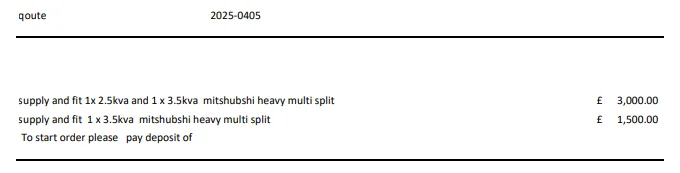

have two quotes from local fitters for a two room split, unsure of which is best:

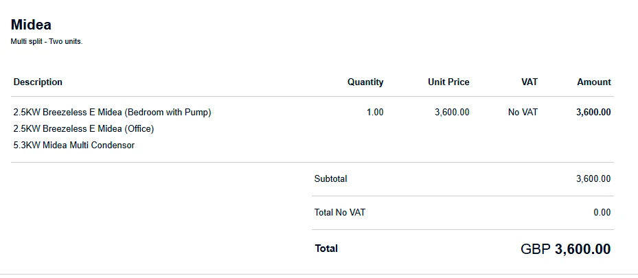

and
I'm going to the check the second, as I think it implies I'll be getting two condensers, which I don't really want.
Which would people go for? The 600 isn't an issue providing the value is there in it.
£600 is 600 at the end of the day. Not sure any difference between brands will make up for that.
How big are the rooms you are putting these in? They seem rather large for a typical U.K. bedroom/office room.
The heat loss/gain of my entire 4 bed detached house at a temperature difference of 23c is only 5.5kw.
That doesn’t include any solar gain shouldn’t be massive unless the room is covered in rubbish glass. Practically in the summer, the most you’ll see is a temperature difference of 10 (30 outside vs 20 inside).
That said, there may not be a suitable multi split unit which is smaller than 5kw as that’s a pretty small unit in reality.
