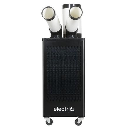

I don't want to start another Air conditioning thread but I also don't want to derail this one. So maybe ignore this if it gets out of hand..
Ideally I want a split system but I wanted to install it myself. I am a avid DIYer and I'm decent at it but I know this might require a lot of stuff or a Fgas engineer to do.
I have had portable ones in the past and I hate having to port them out of the window. Defeats the object of keeping the cool air inside even with window covers...
The insane idea I have is this.
I live in a bungalow and the fireplace is not used. I considered these spot cooler air cons that I could pipe to vents in my ceiling and vent the exhaust through the fireplace in the loft. I could control this air con on a timer or app or something with very short tubes. A few metres max, any drainage tube could go out the soffit.
The only error in the idea I can think of is that the ambient temp in the loft is greater than the outside air, which I cannot pipe in. This would put unnecessary strain on the system cooling hot air. Also portable air cons obviously work from the thermostat being in the room to shut off, which is a problem.
I would ideally like a 3 port system, in out and exhaust but they do not exist. Which I think is a little strange.
Any thoughts on my stupidity or genius? Just trying to do the best I can with the little money I have.
