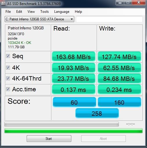

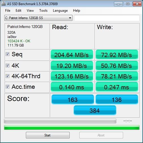

AHCI enables Native Command Queing, Although it's not essential to operation of your SSD, there is a slight performance hit by not using it. You can see below the difference when used and when not and when not.
IDE:
AHCI:
Still not sure why the write speeds decreases but a significant increase in read.. Ideal for the OS :)
Indeed, some of those results show quite a large increase lol.
