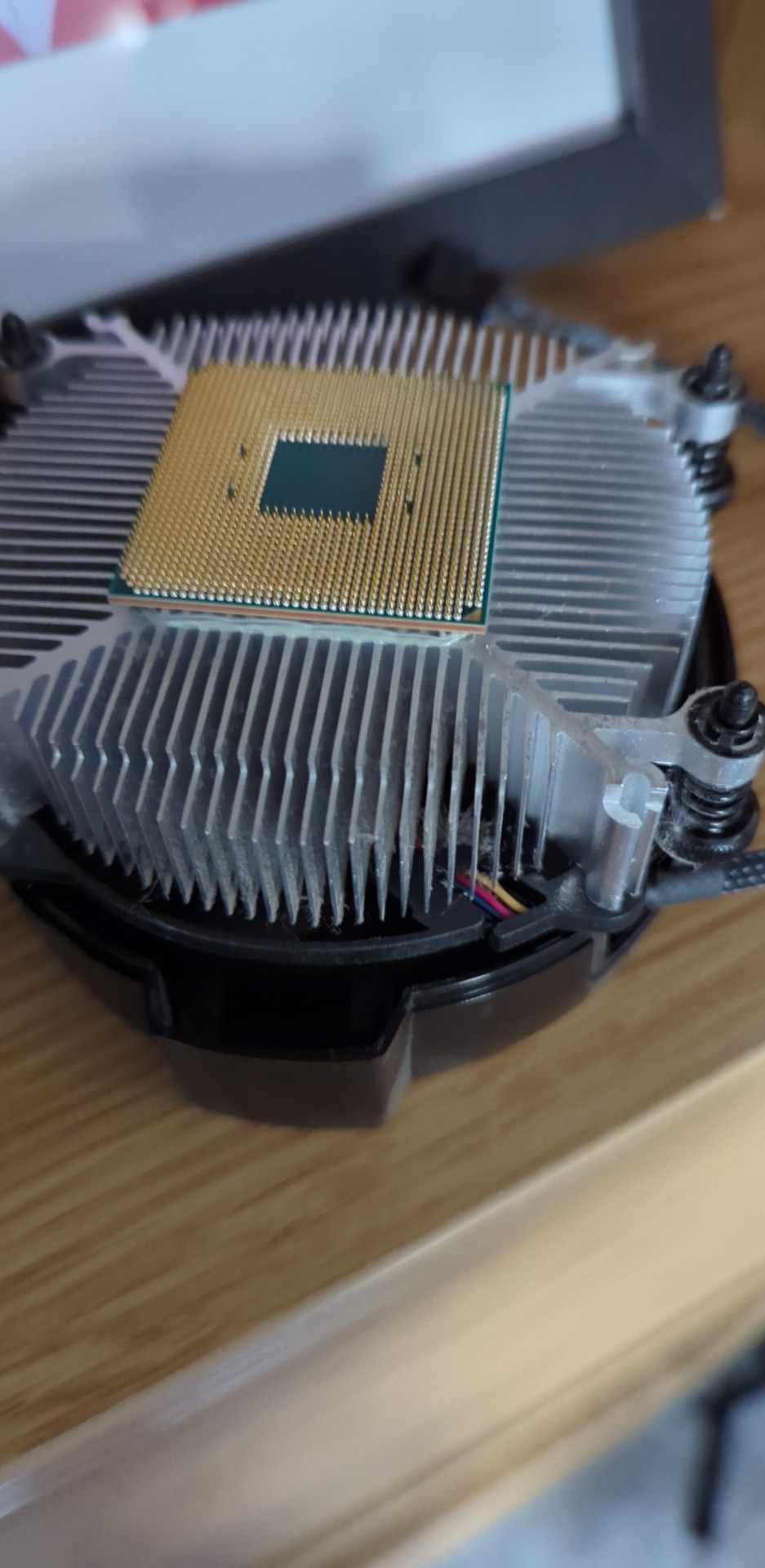

Have just upgraded my CPU after nearly 5 years of solid service.
Only problem is that when I pulled the HSF, the processor came with it! :eek:
Any advice on how to unstick the processor so I can repurpose it?

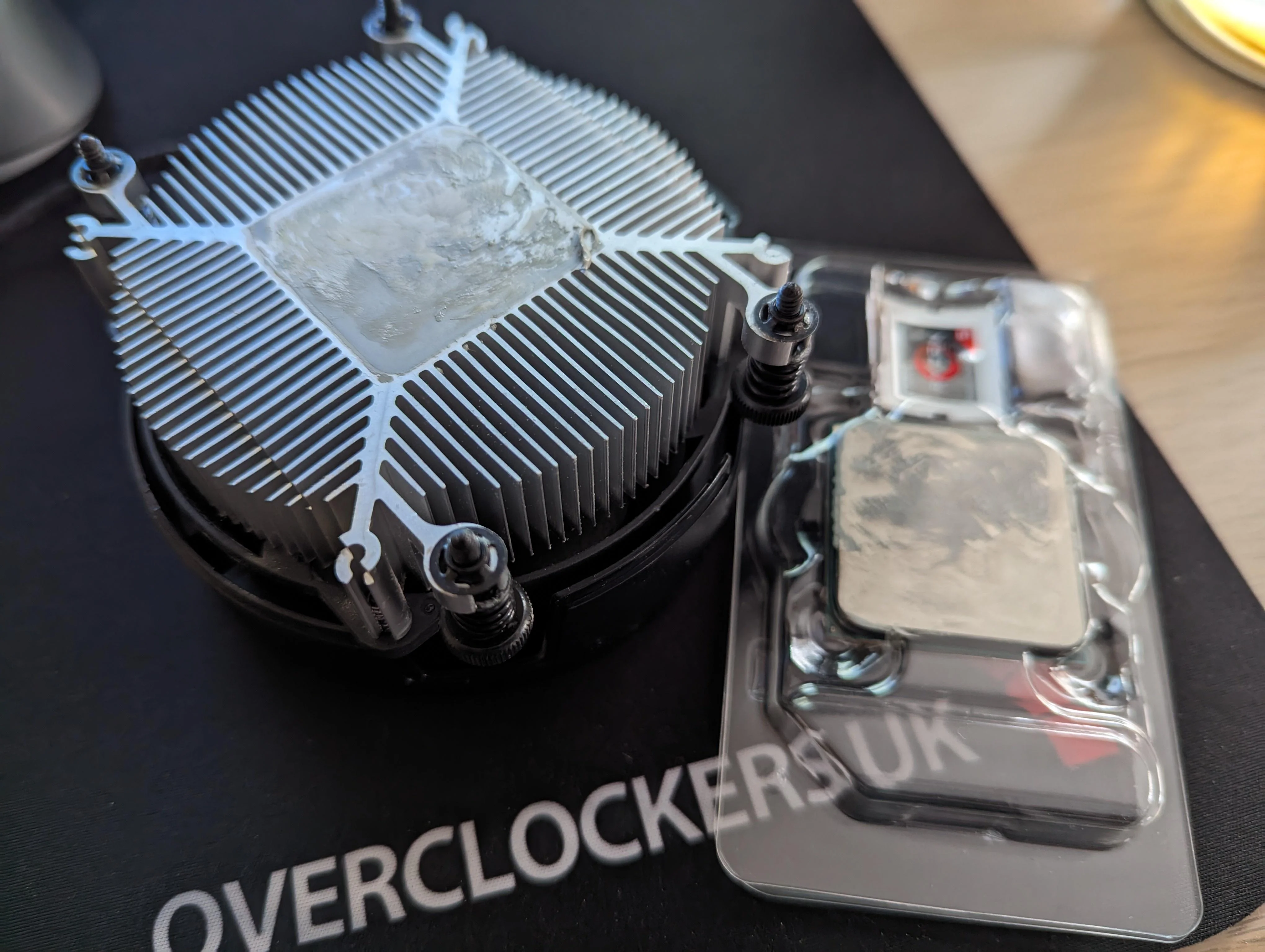

Awesome advice, worked like a dream and didn't take too long, either :)
Just needs a bit of a clean up and then can be added to my collection of archaic CPUs to sell (alongside an i3 2100 and an i5 2500k) :D

Looks like to much paste as well, or is that the stock cooler and that how it came?

@cjgardens can confirm it was the stock cooler, with the stock paste
