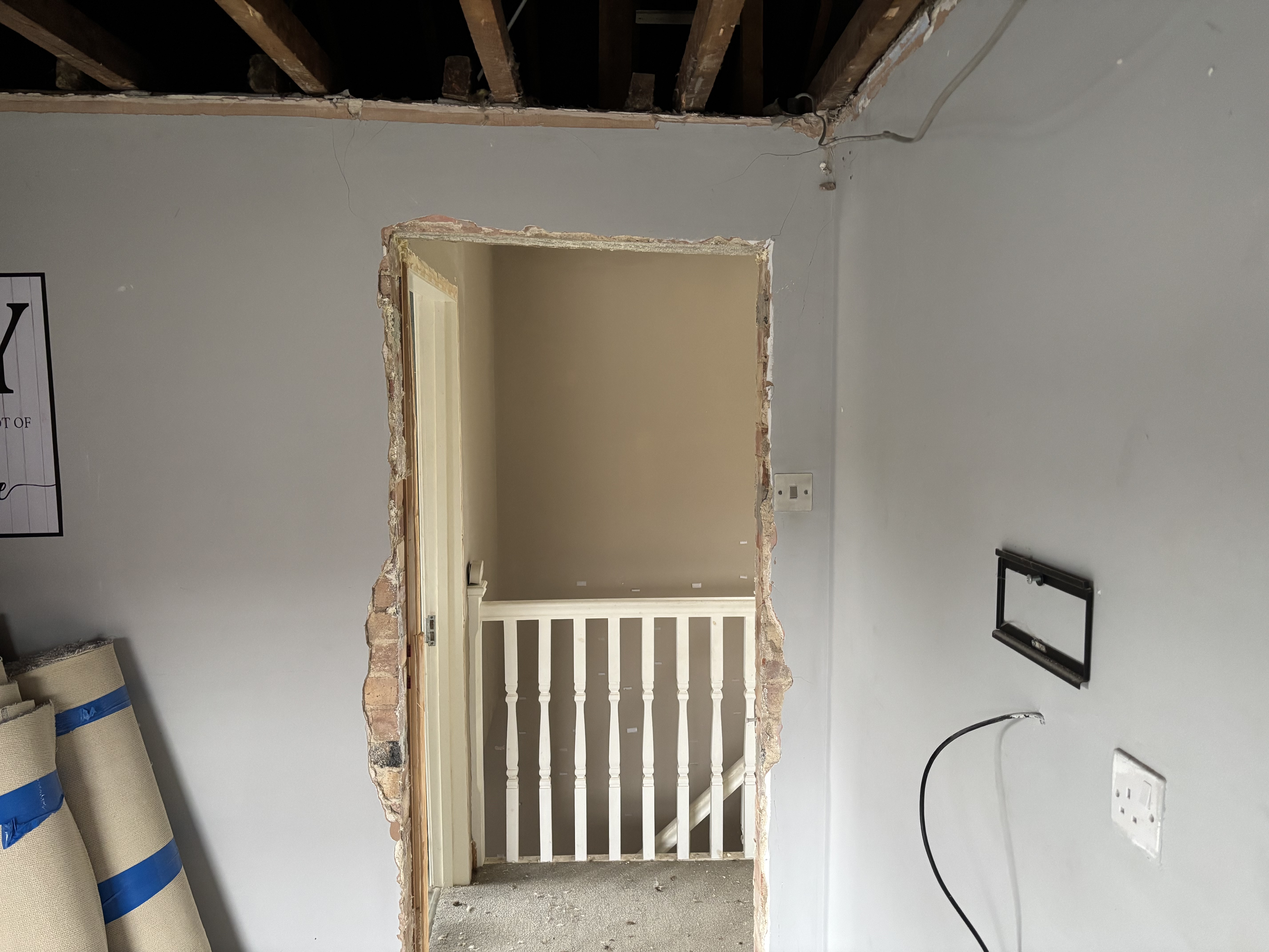

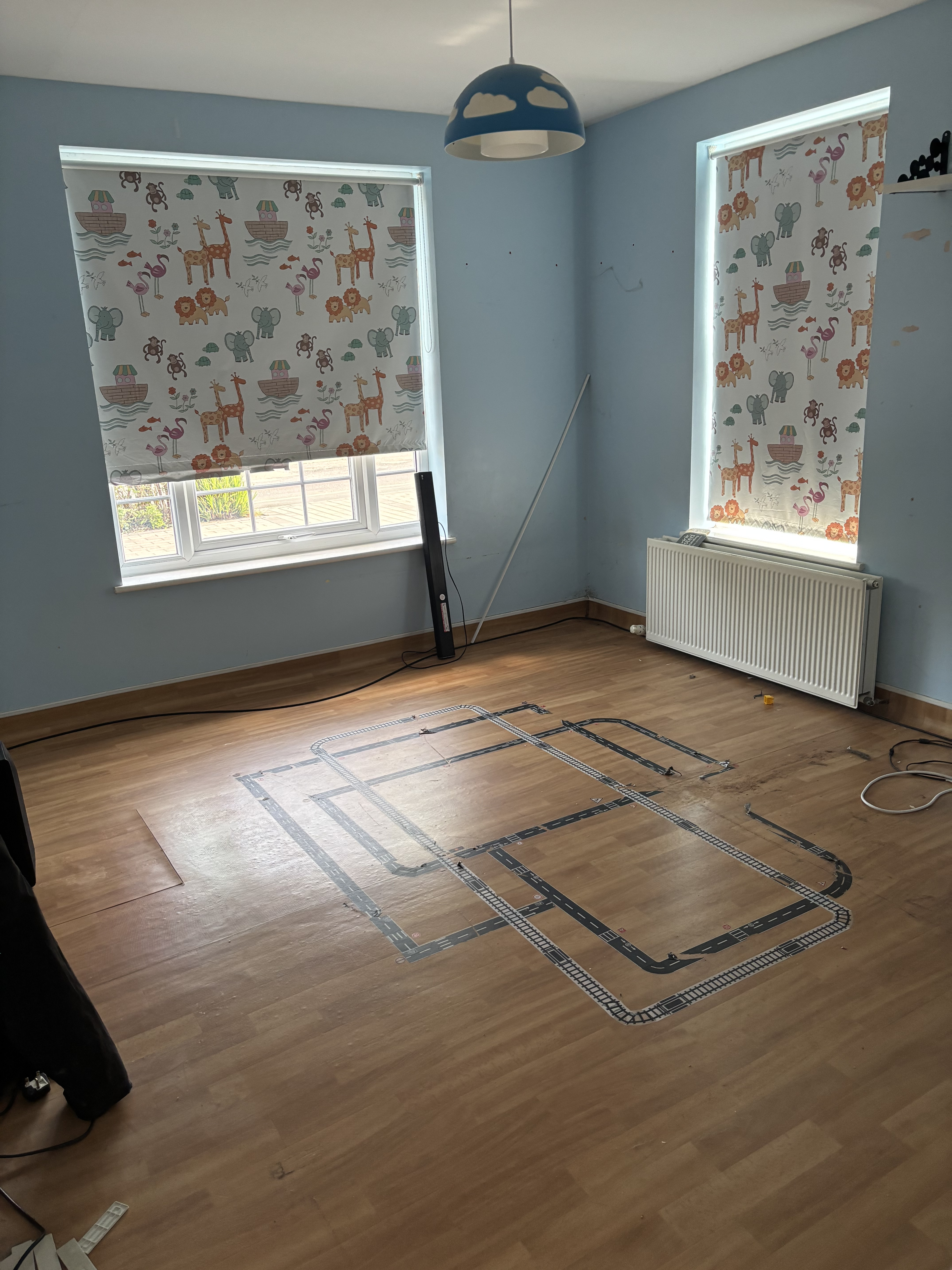

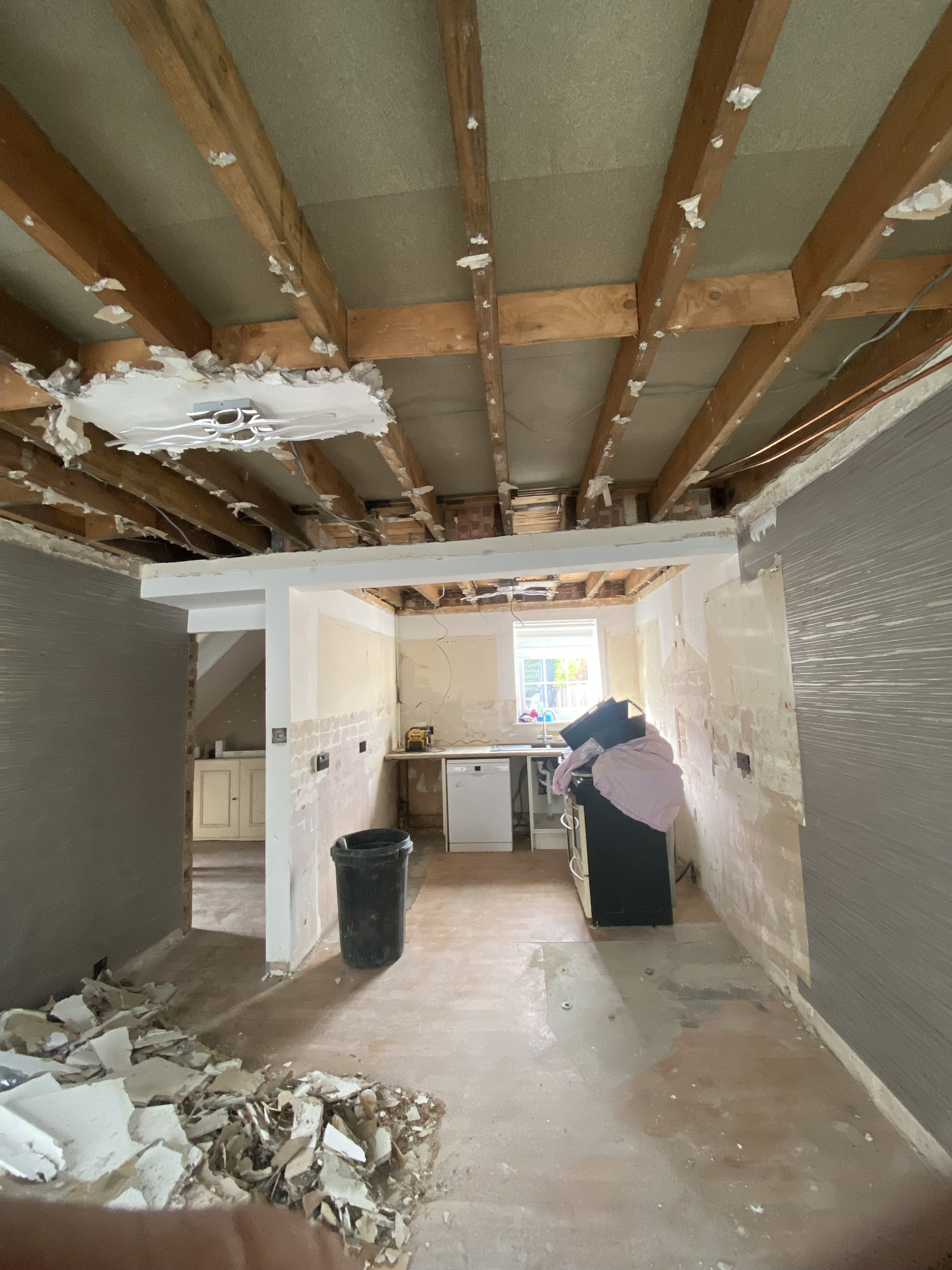

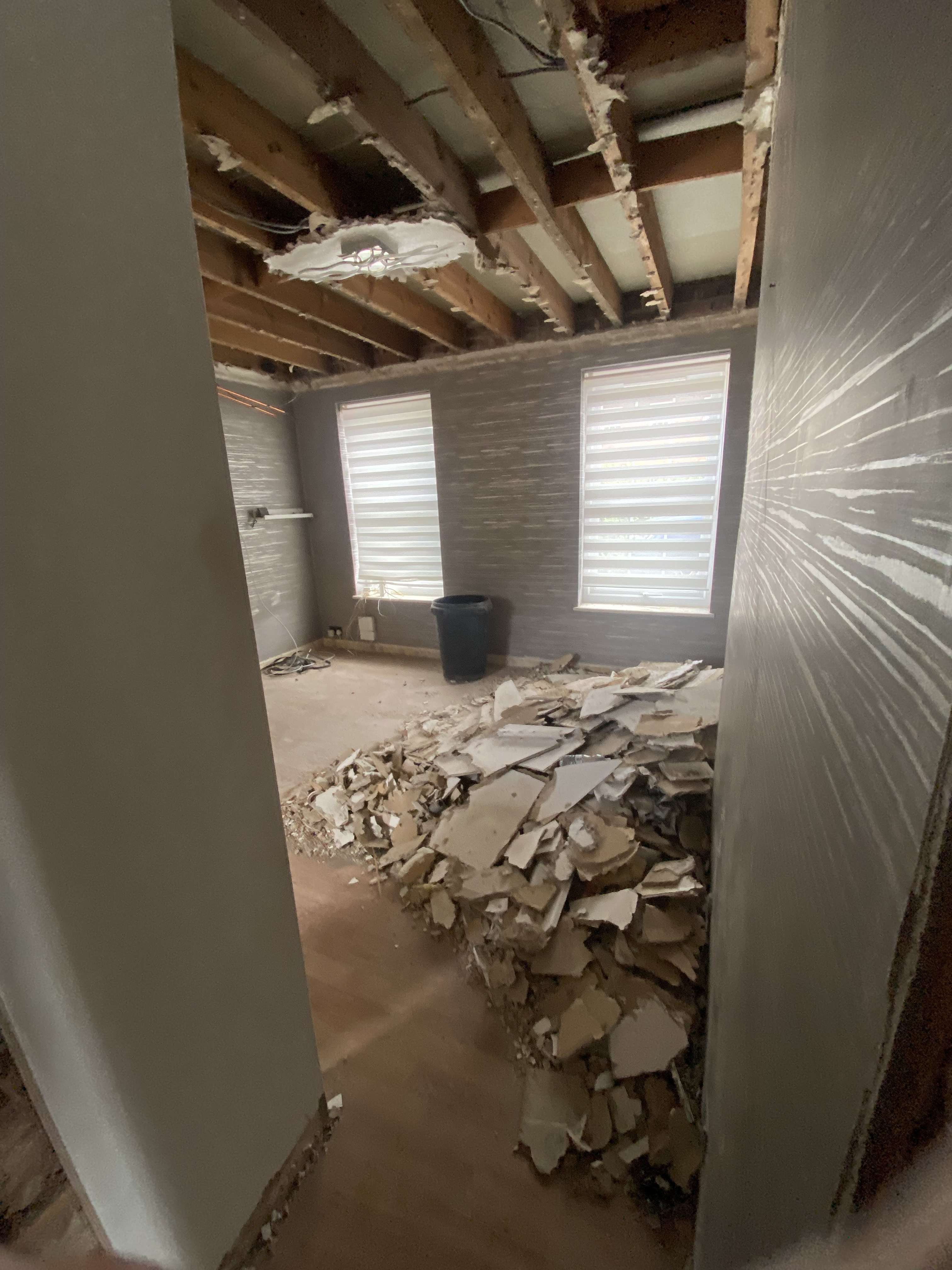

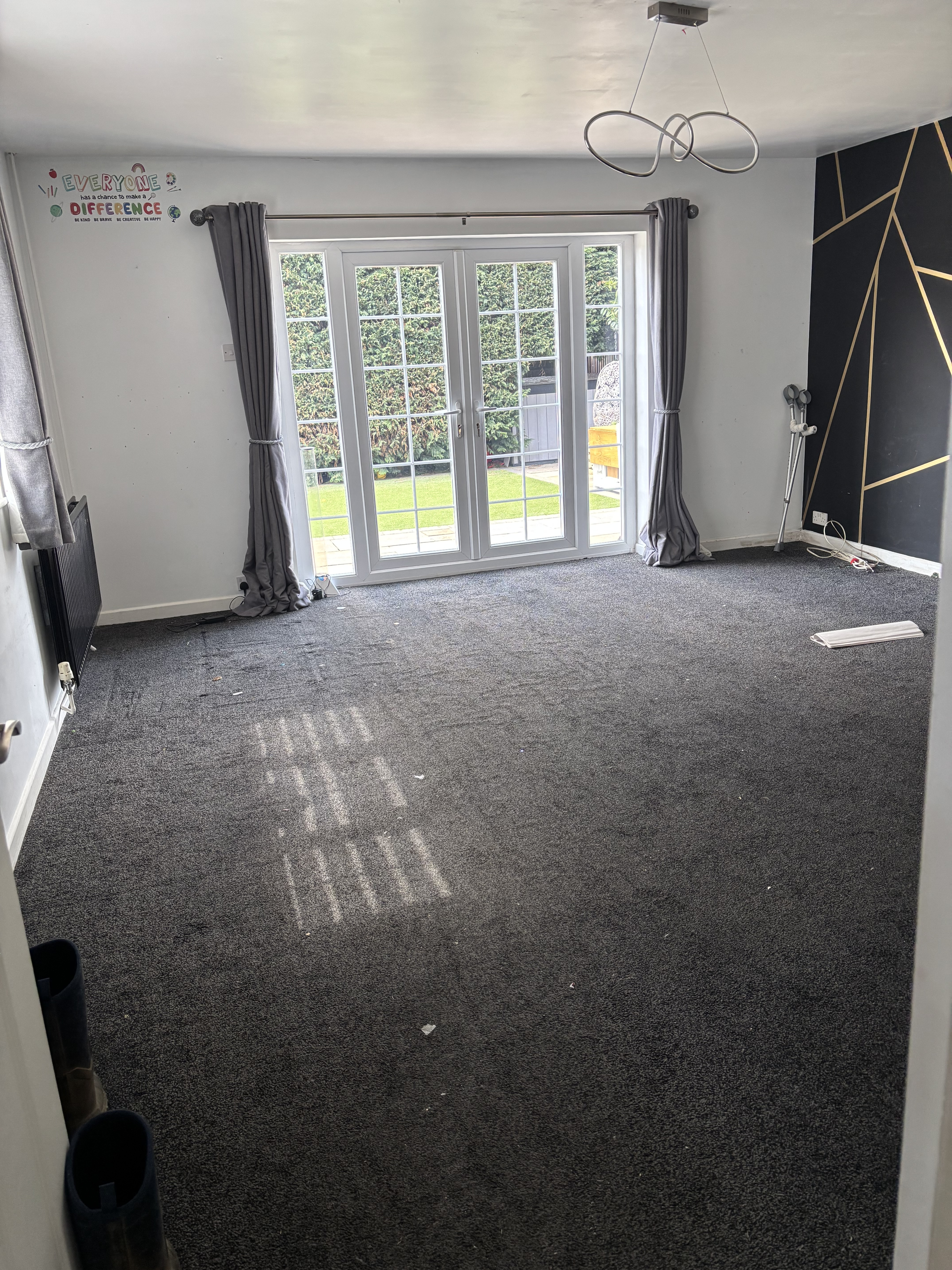

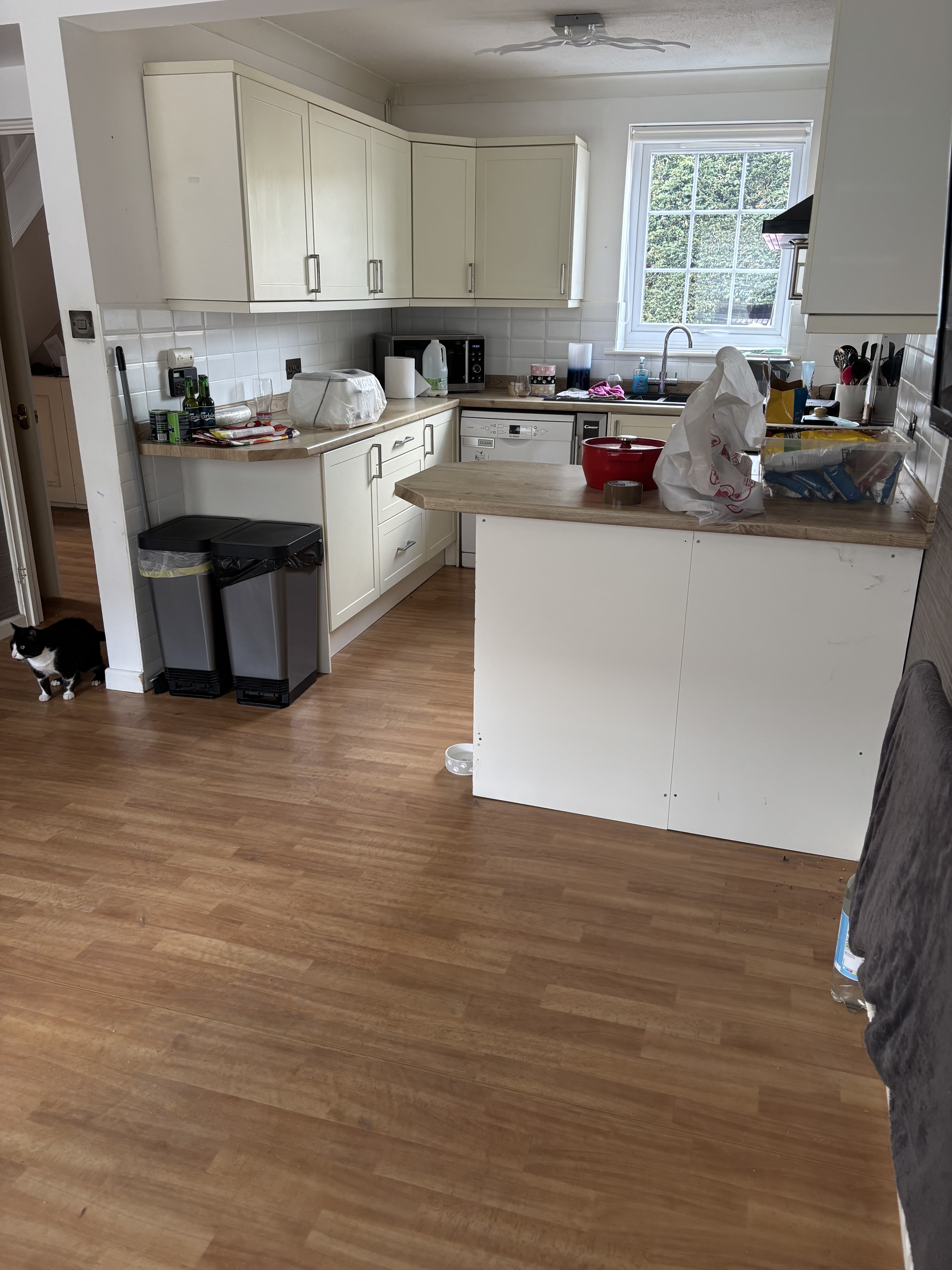

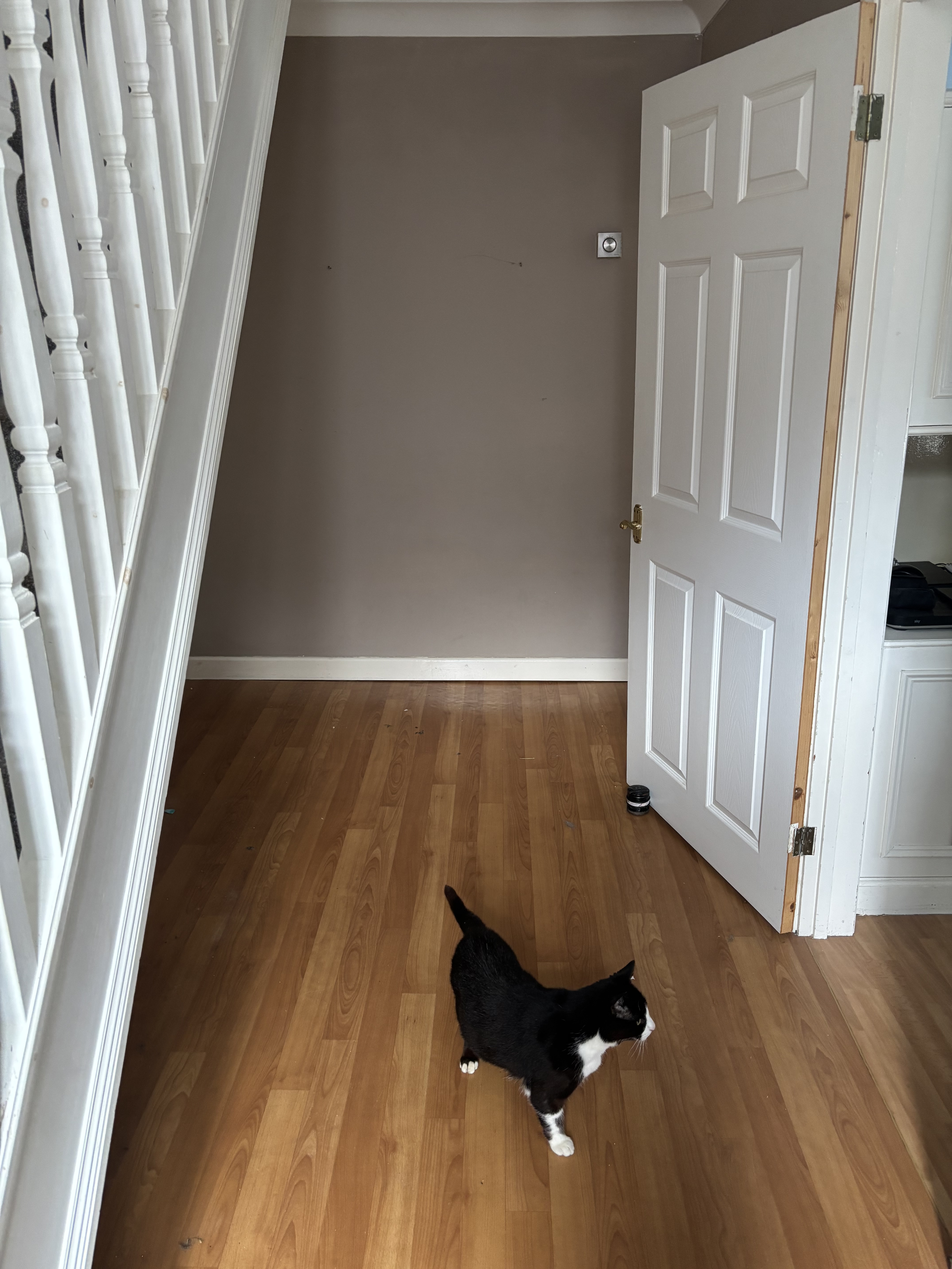

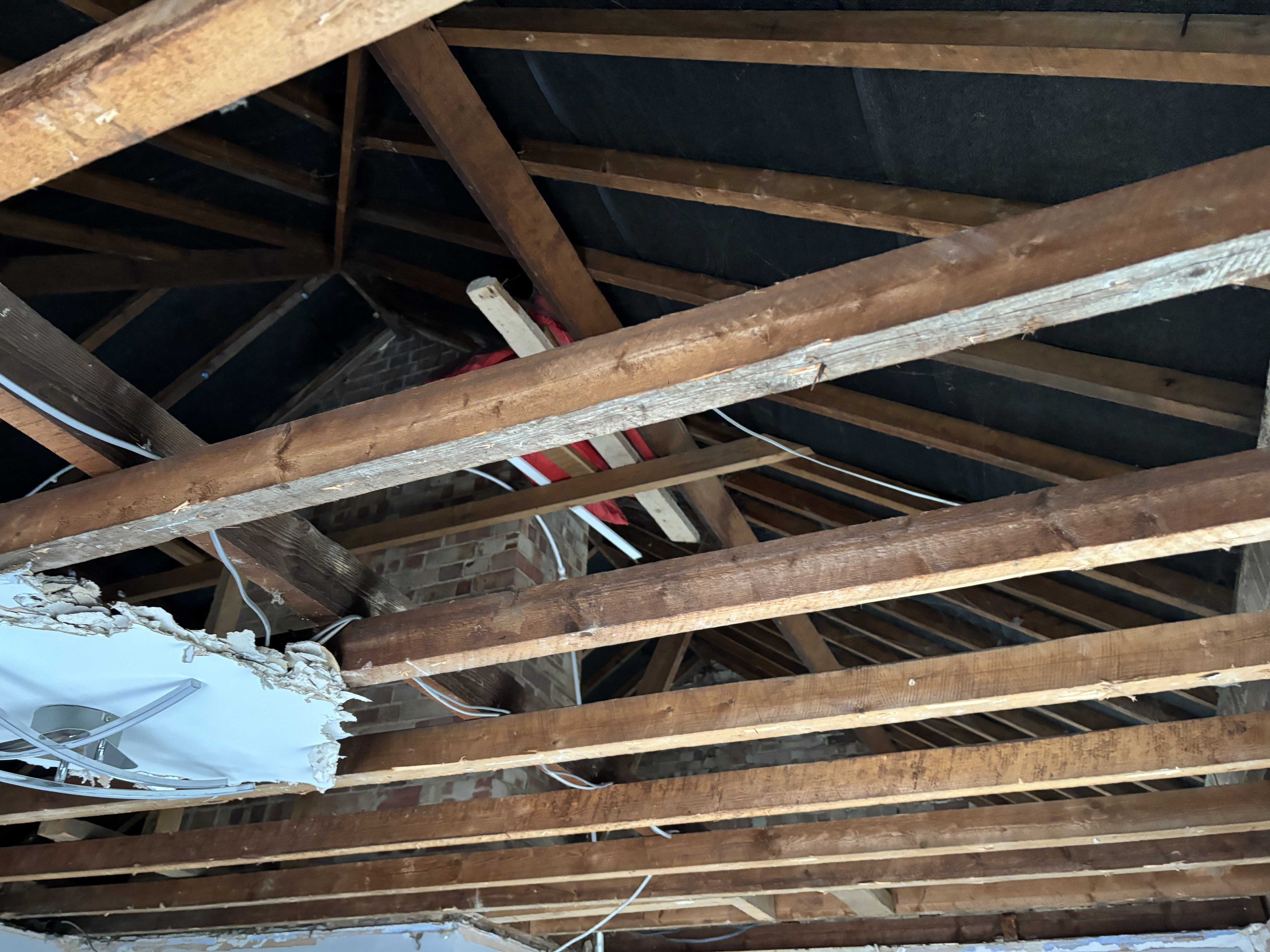

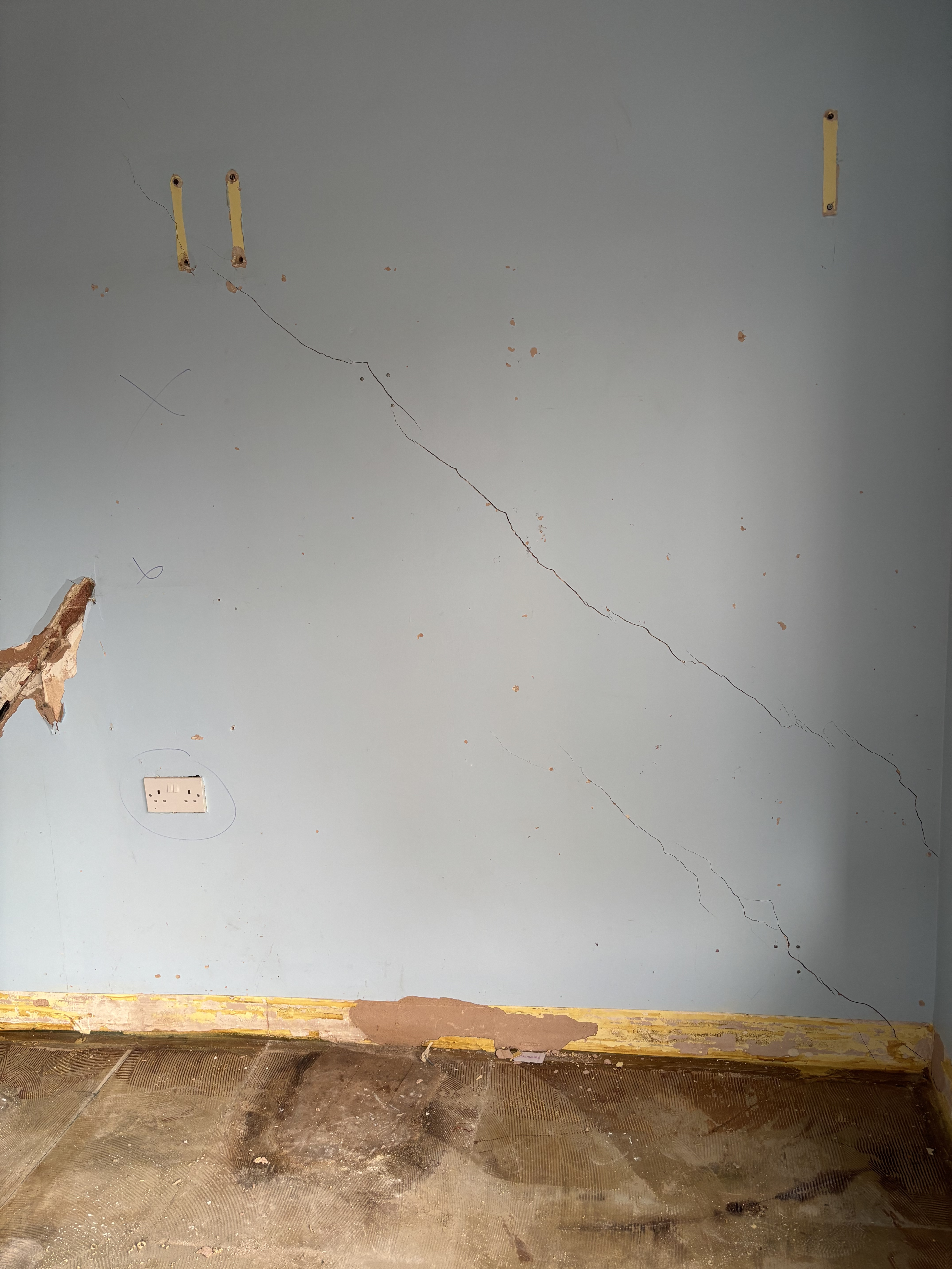

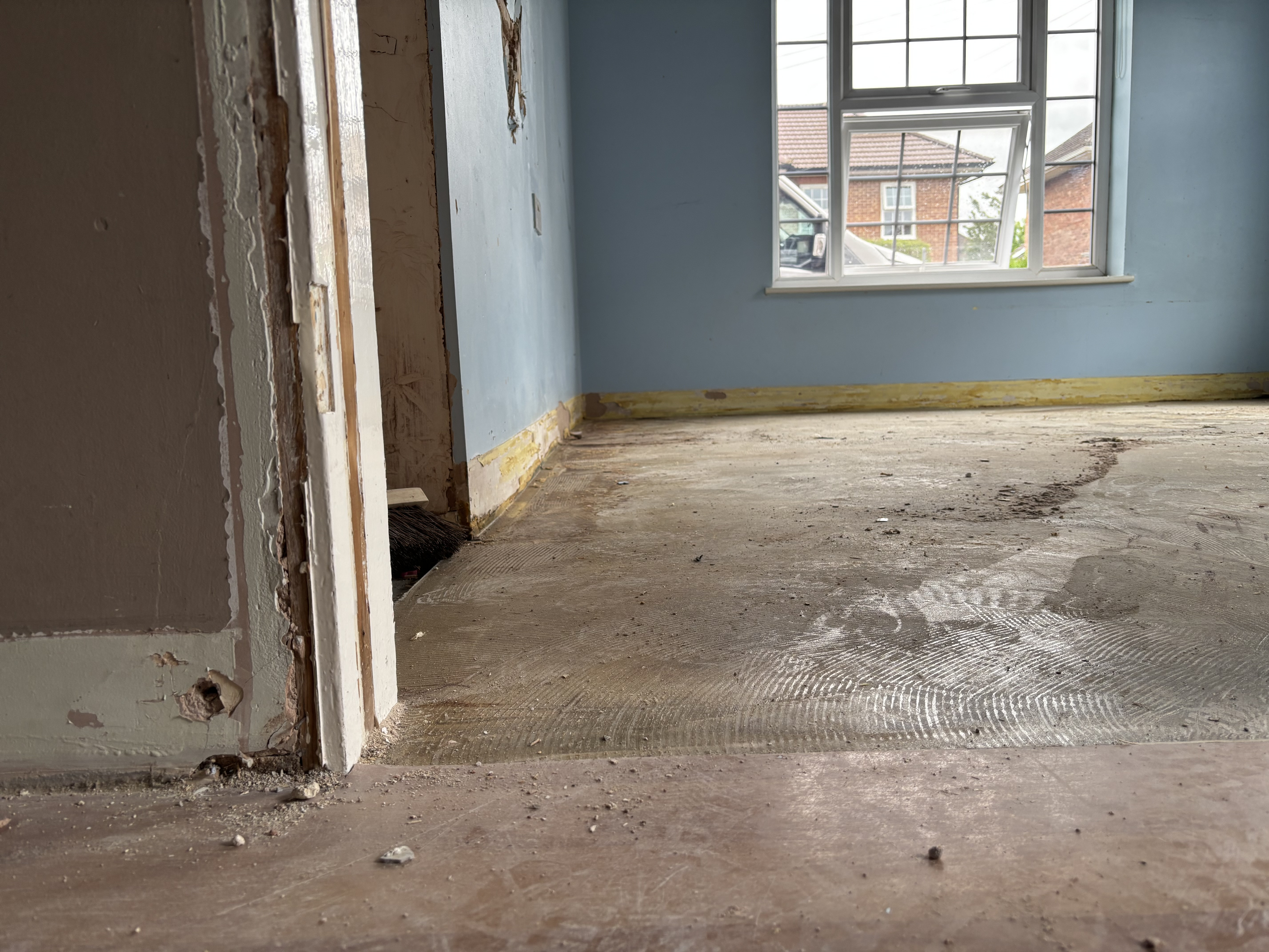

Im just going to dump photos in now but in the mix are some before shots, some shots of the damage caused by the subsidence and the current state during the teardown.
Feelings
I have a general feeling of satisfaction at this point, I had started to worry that people thought I was making a mountain out of a mole hill, and that no one believed the scale of the works we needed doing and had planned. This was playing on my mind quite a lot and after 7 years + of this process even I was starting to doubt myself.
Now we have moved and works have begun though, its all starting to move in to place, I have sense of satisfaction that I was right to stick to my guns and that while this is going to be a very big process, its the right way to have approached things and get it all done.
Before
Week 1 teardown
Subsidence Damage
