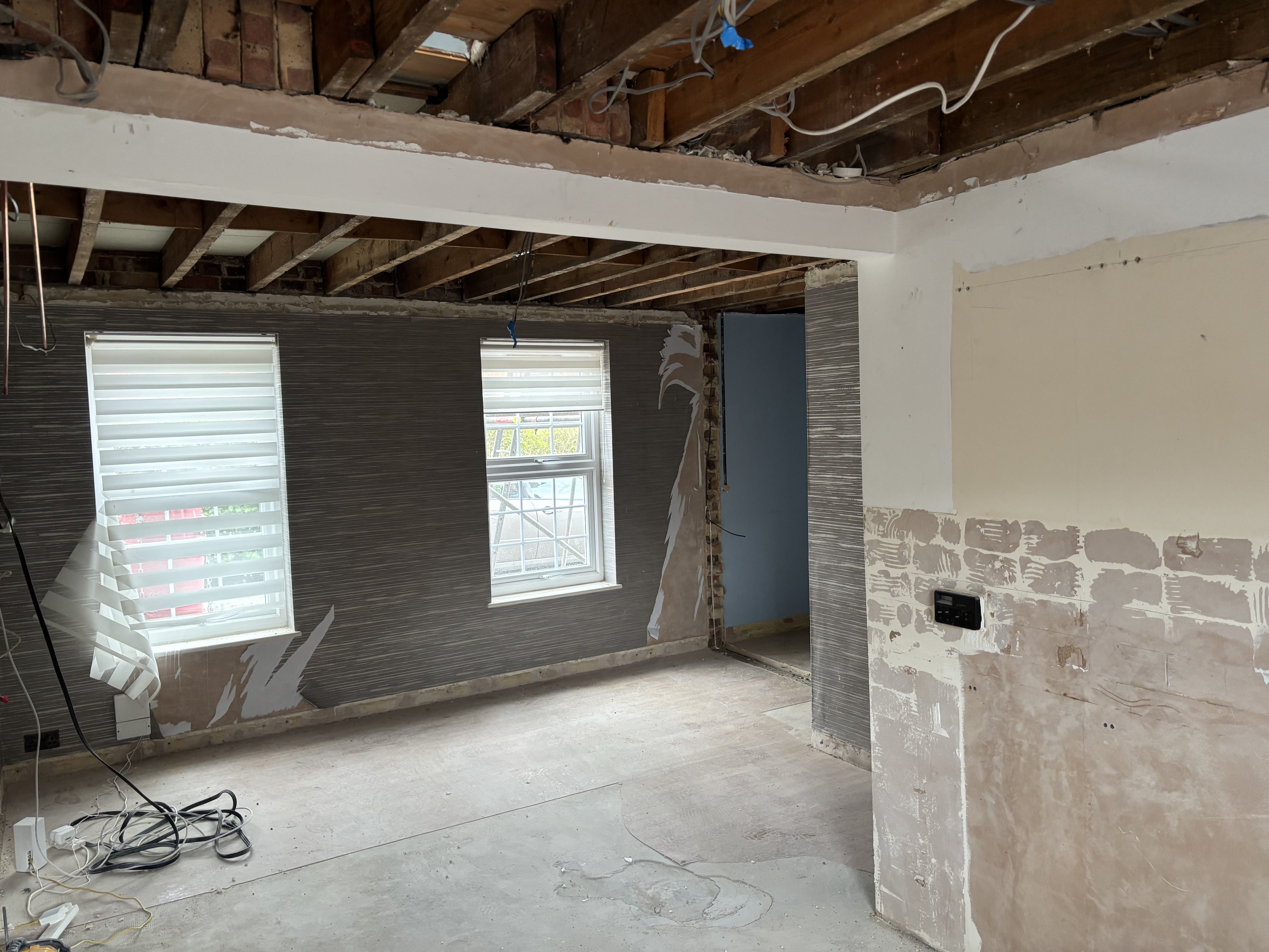

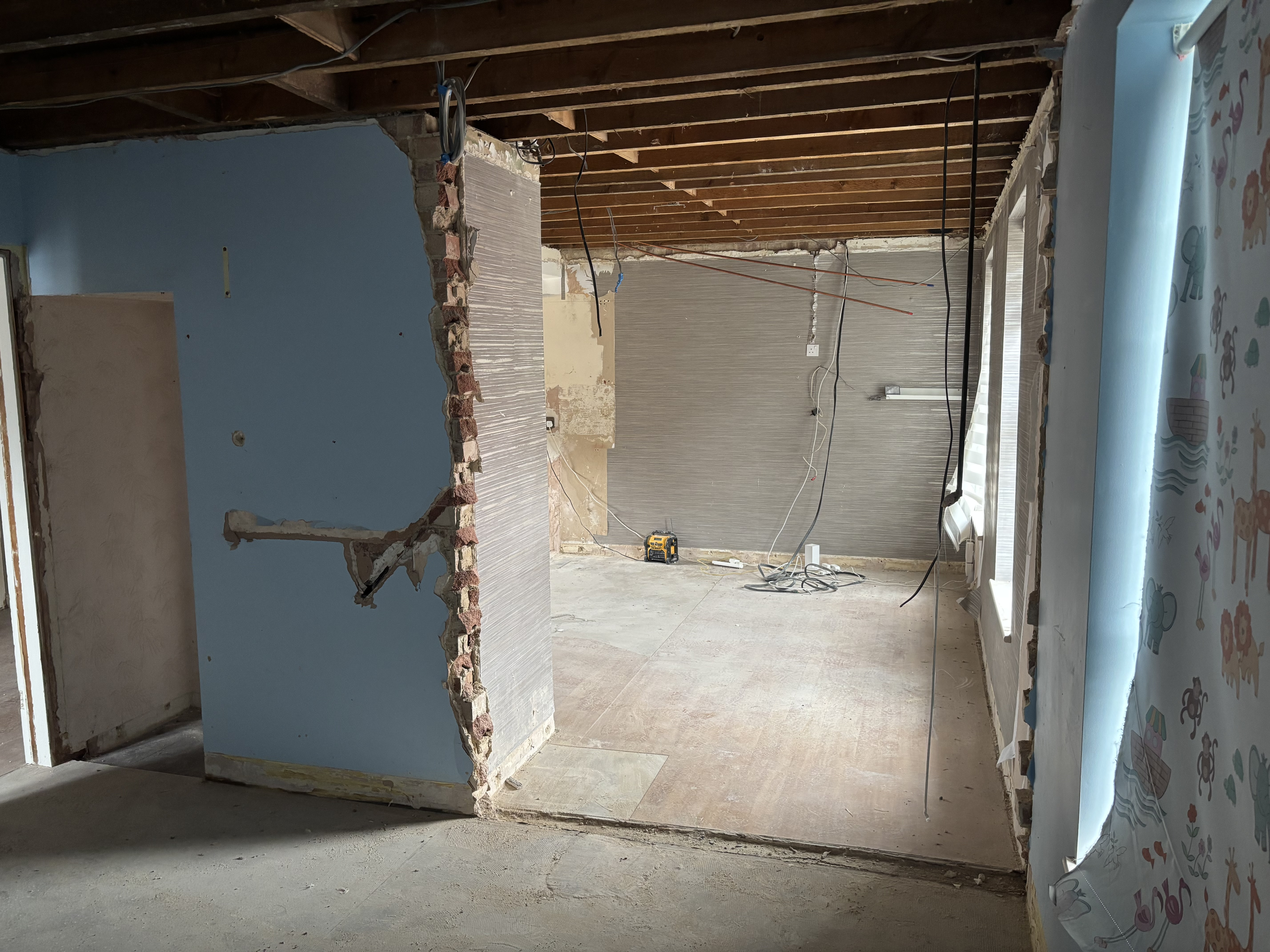

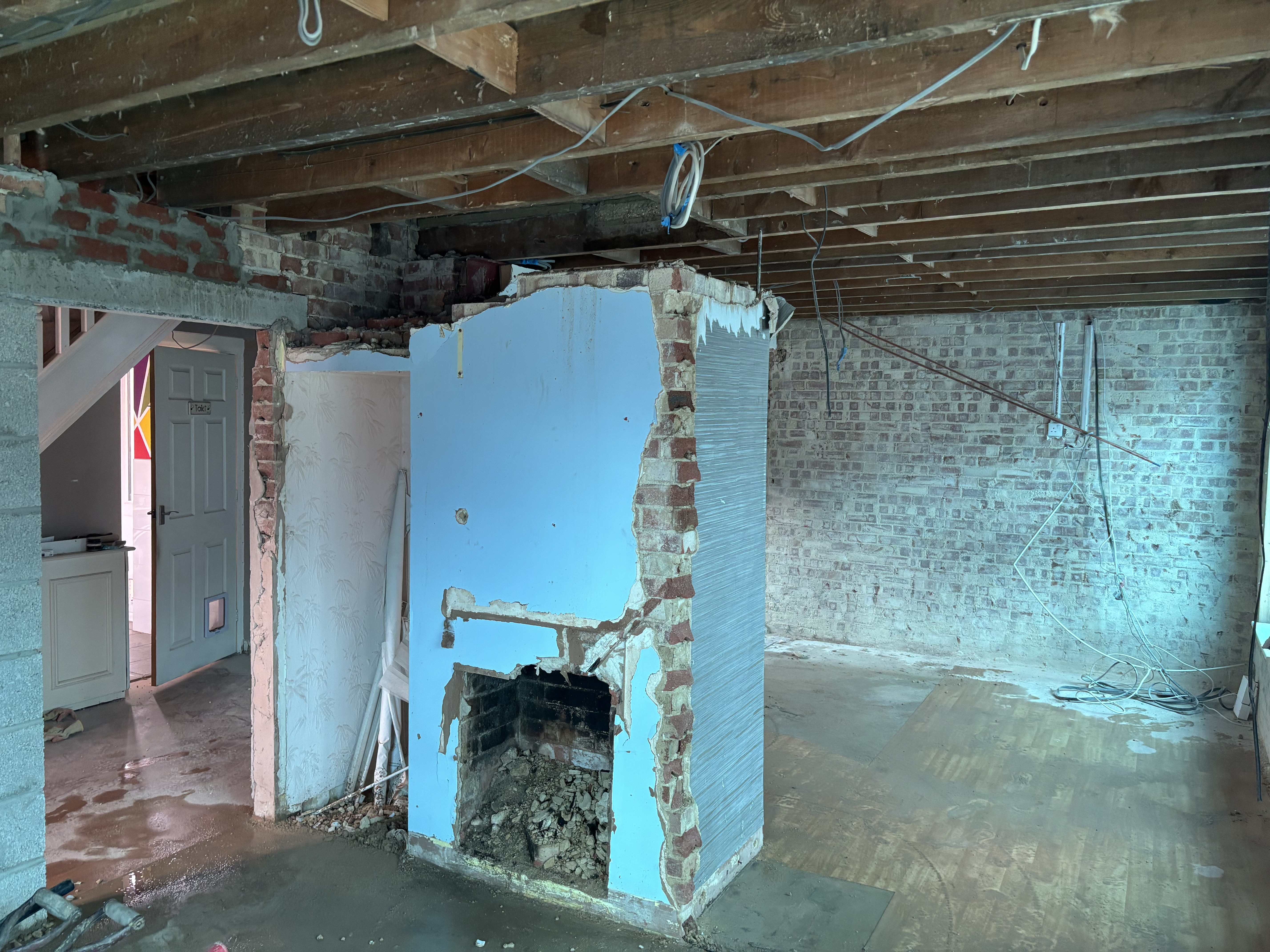

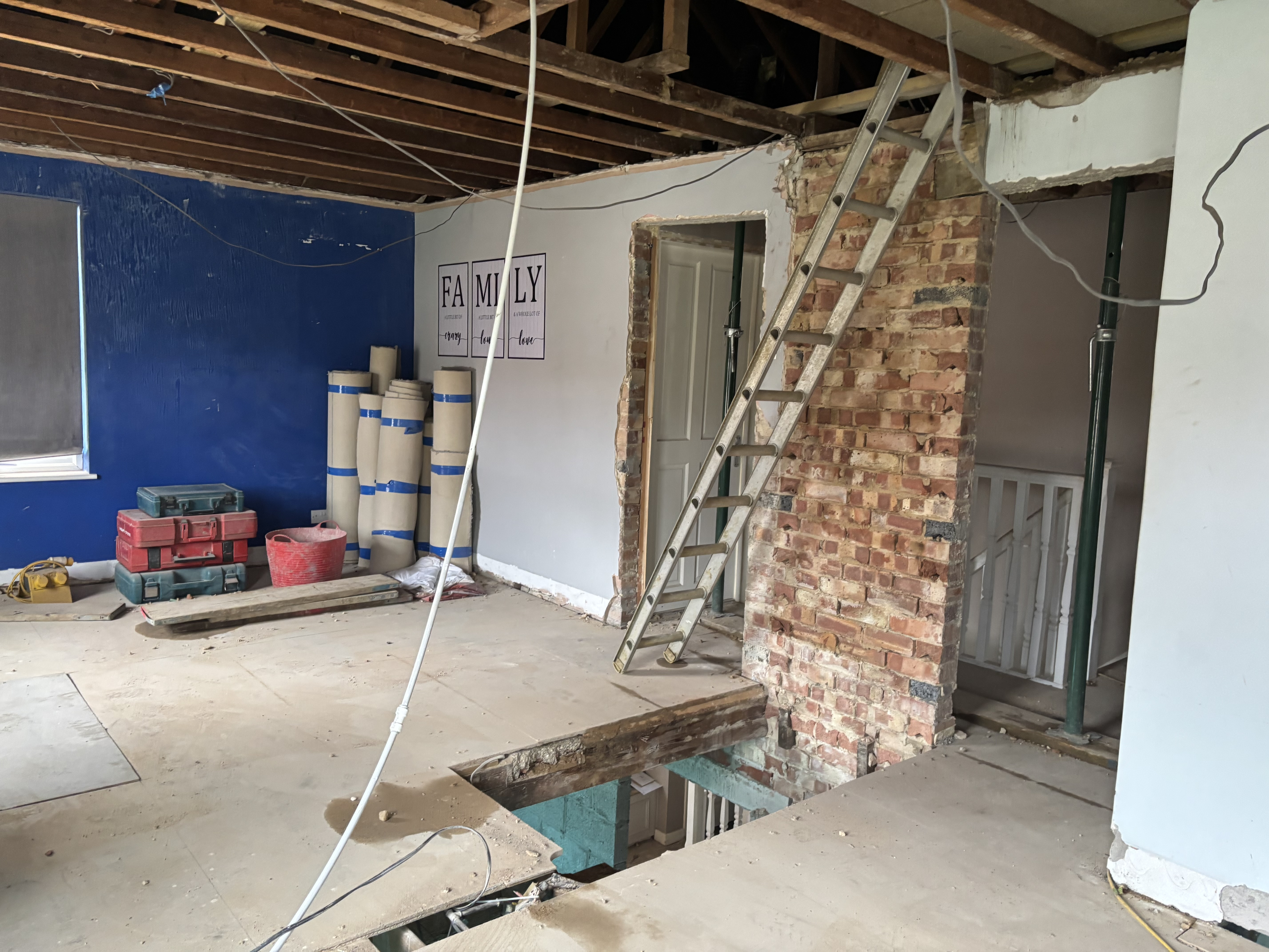

The first hiccup - Week 4 update
Teardown is in full swing, weve added a fair old amount of work to the list and a lot of money to the bill, having to make difficult choices now, and then we hit our first major hiccup today.
Chimney is now out and removal of the floor had begun but on doing so its been found out that our main supporting wall of the house was just built on to the floor slab, no foundations, nothing. The chimney its self was not structural, however it was adding an element of mass that the walls tied in to which helped limit the risk of there being no foundations under it, and the supporting walls.
Time to get building control and structural engineers on the case ASAP so that we can keep things on track.

Week 7 Update

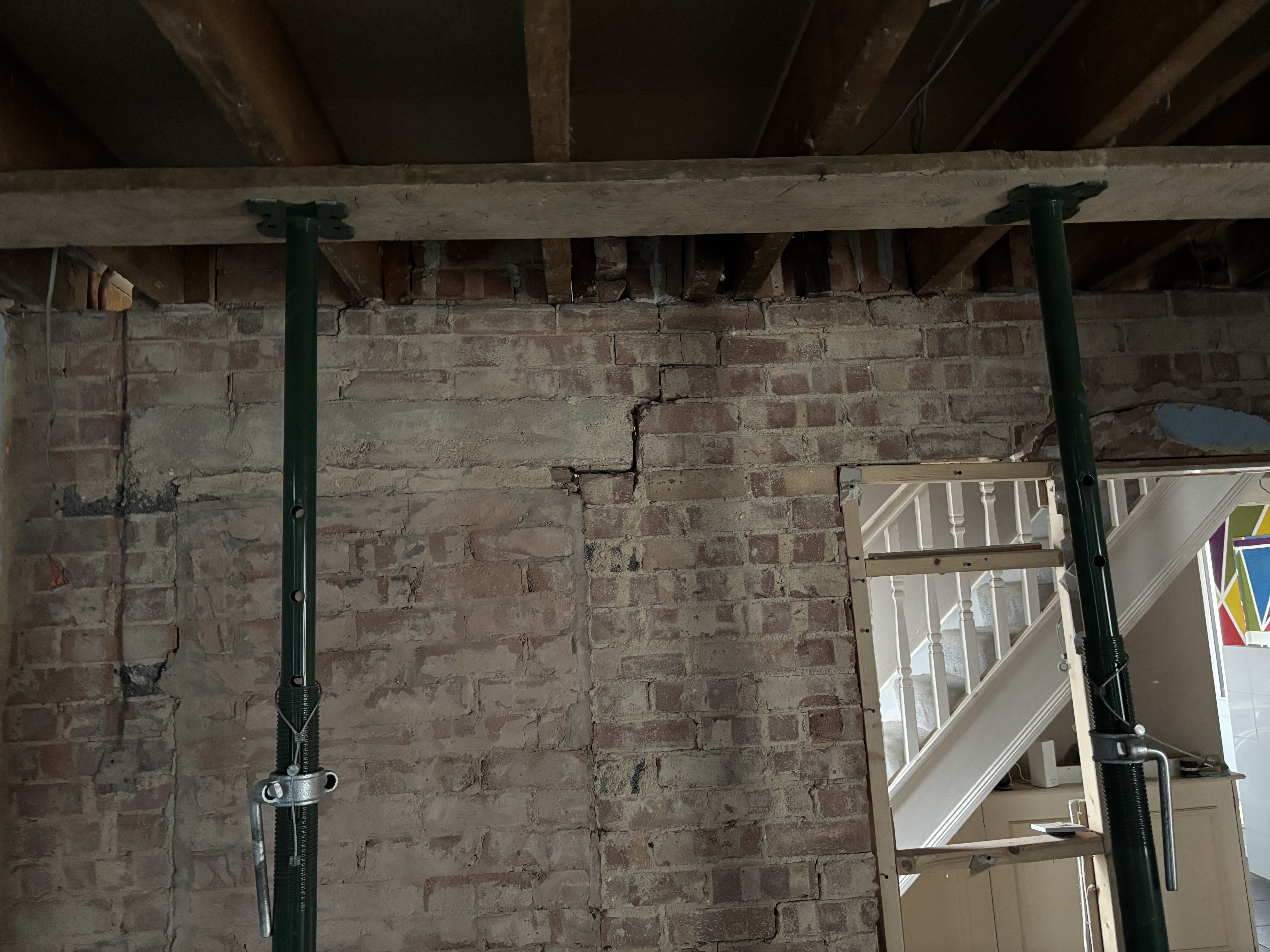

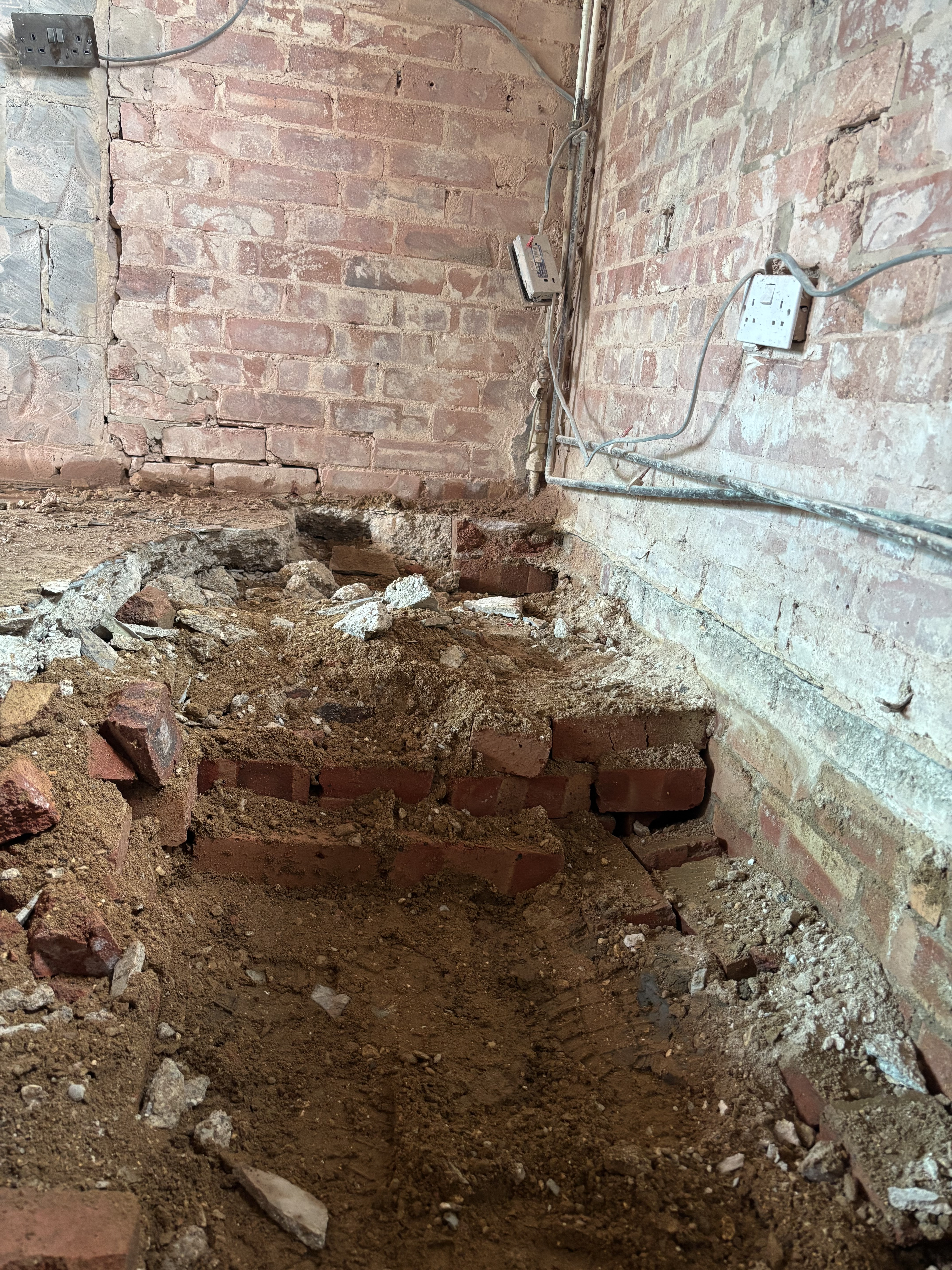

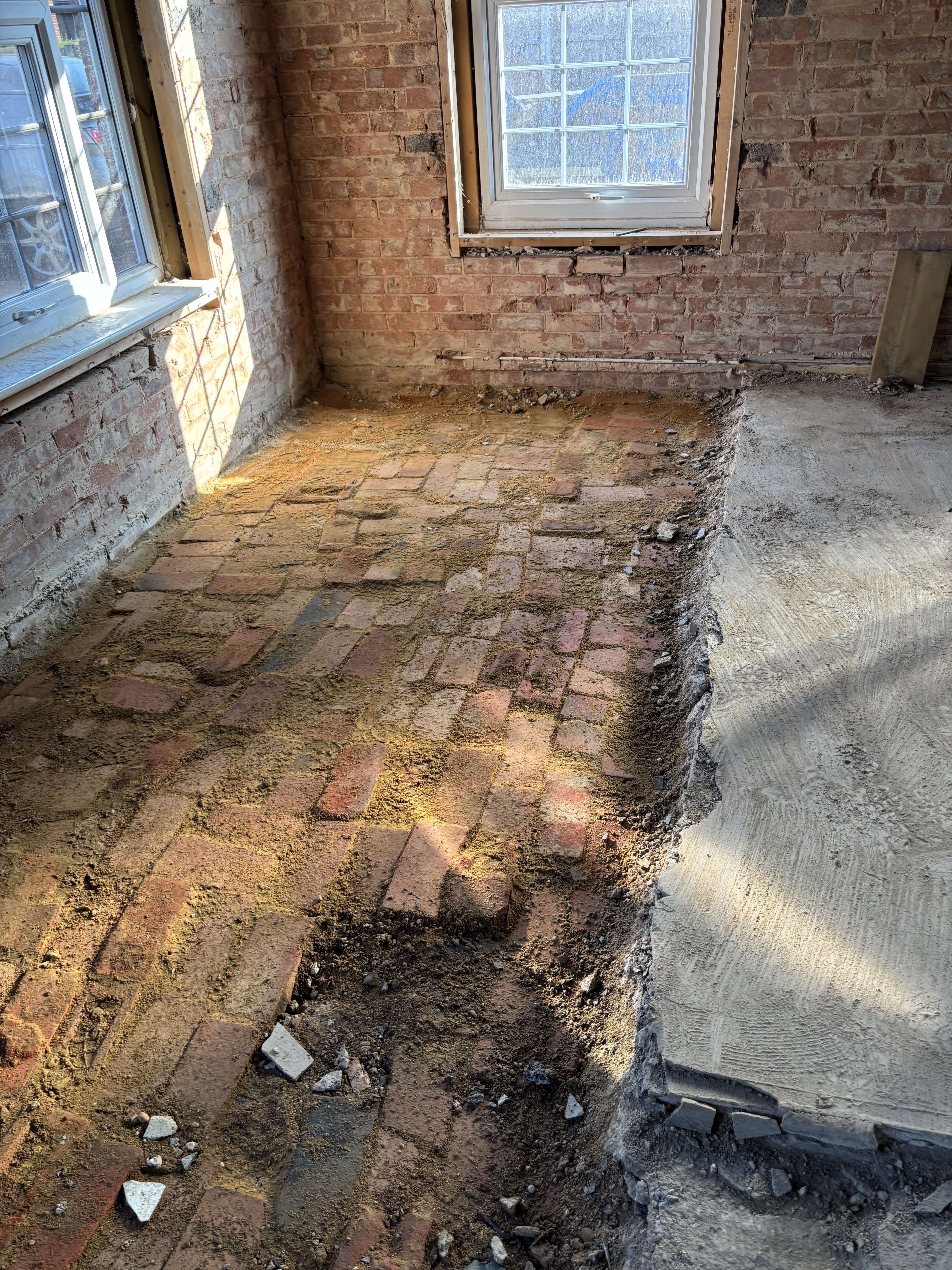

More entertainment along the way, our house was originally built by a brickworks company and so this explains the use of bricks underneath the concrete floor slab, instead of properly made up ground using hardcore etc. This explains why there was no internal supporting wall footings, apparently bricks were good enough!!

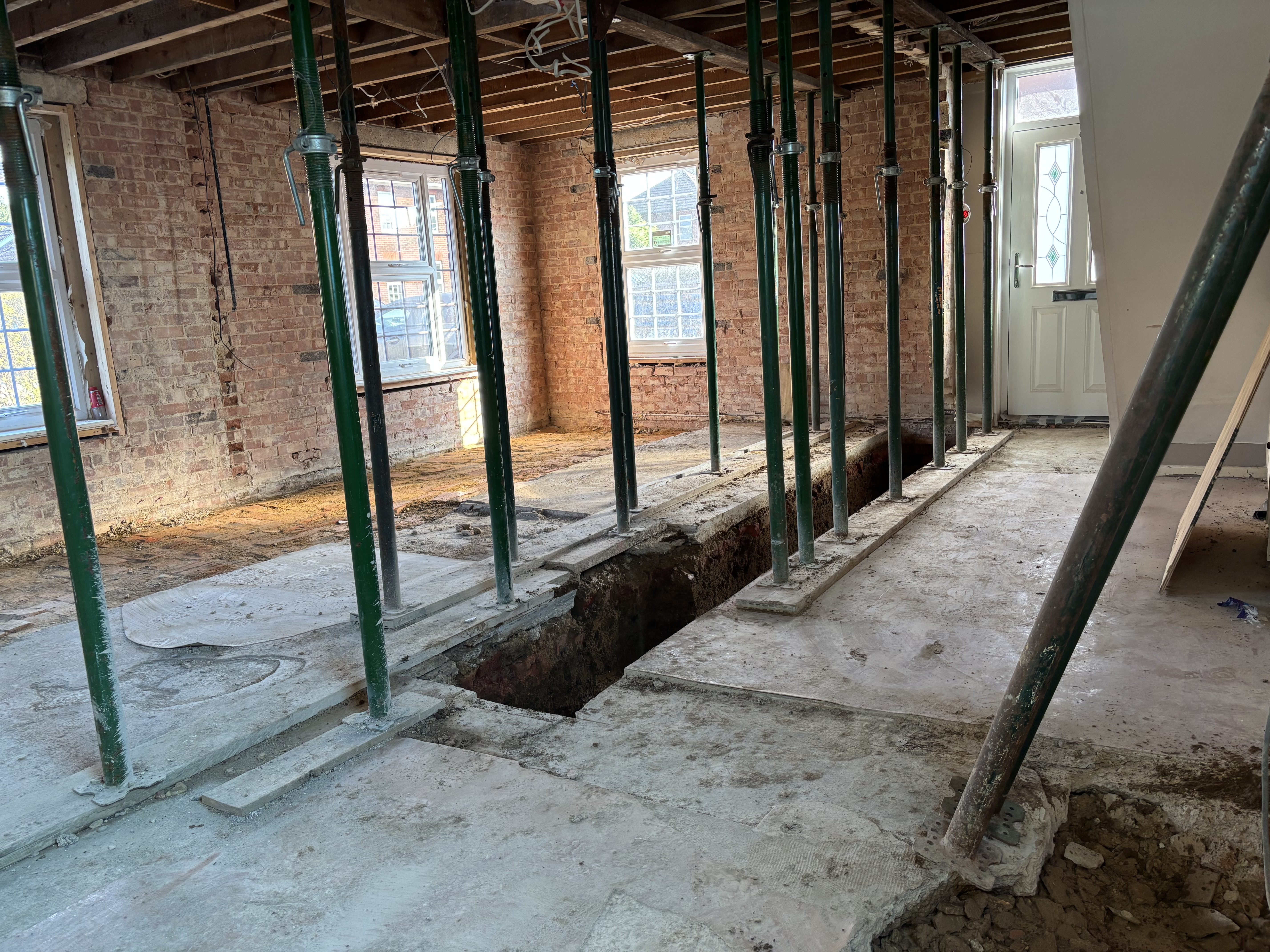

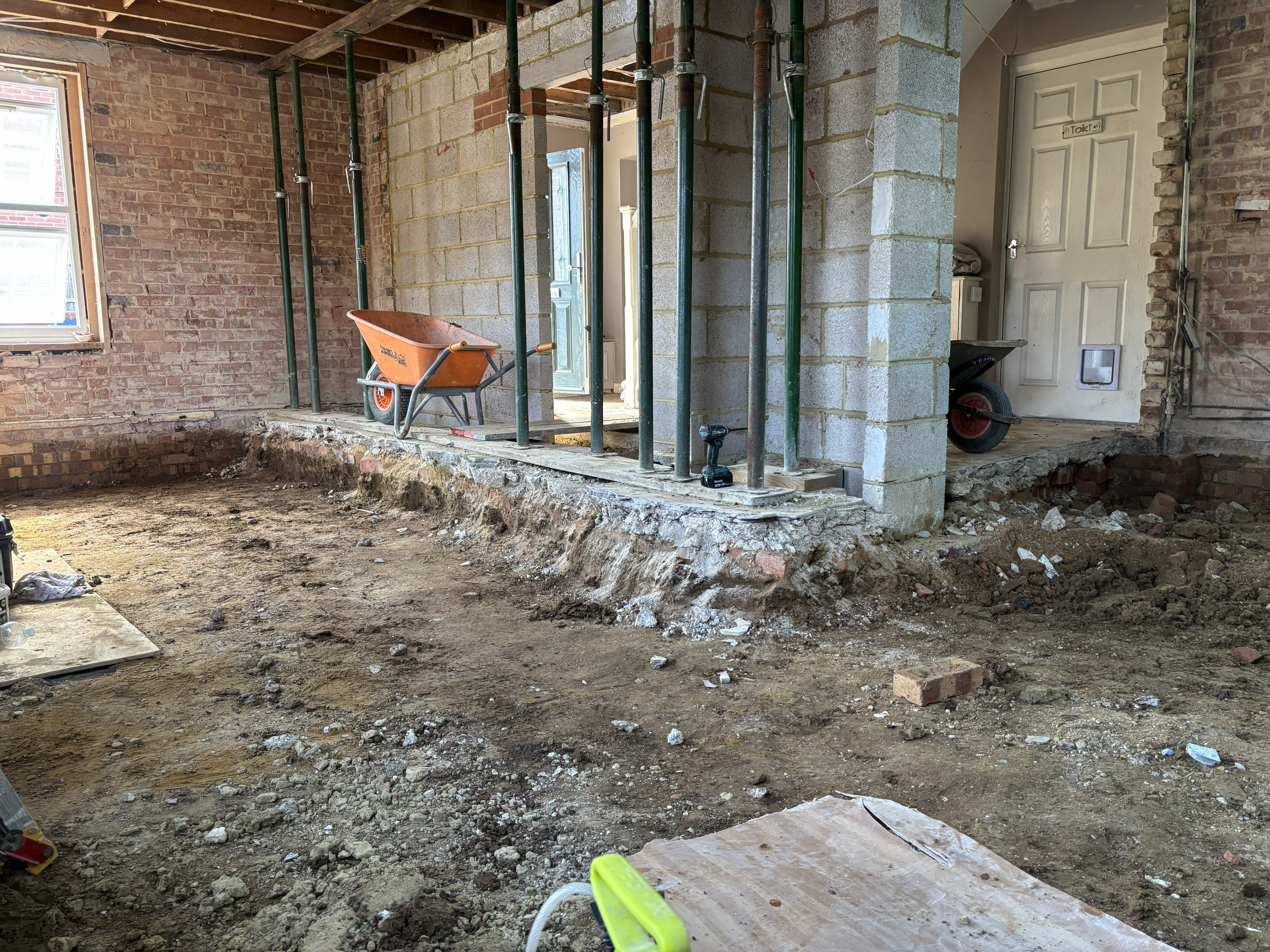

To address the lack of foundations underneath our supporting wall the plan was put together to support the joists and then remove the supporting wall, dig out a foundation trench, put in footings, and then rebuild supporting wall. At this point we needed to get building control involved, so thats added a little extra delay but they have been fantastically supportive. They are onboard with the plan and earlier this week provided the first inspection sign off at the point where the foundations trench was ready for pouring.
Progress pics from the remaining teardown up to date.

Built 1957. Definetly not the only ones who have issues, all the houses down the street were built this way, the ones impacted the most are ones that have plants / trees growing right near them.
Now that we have seen how the floor was built it all makes sense. Plenty of room for roots to grow under between the bricks and draw out moisture from what is a heavy clay base.

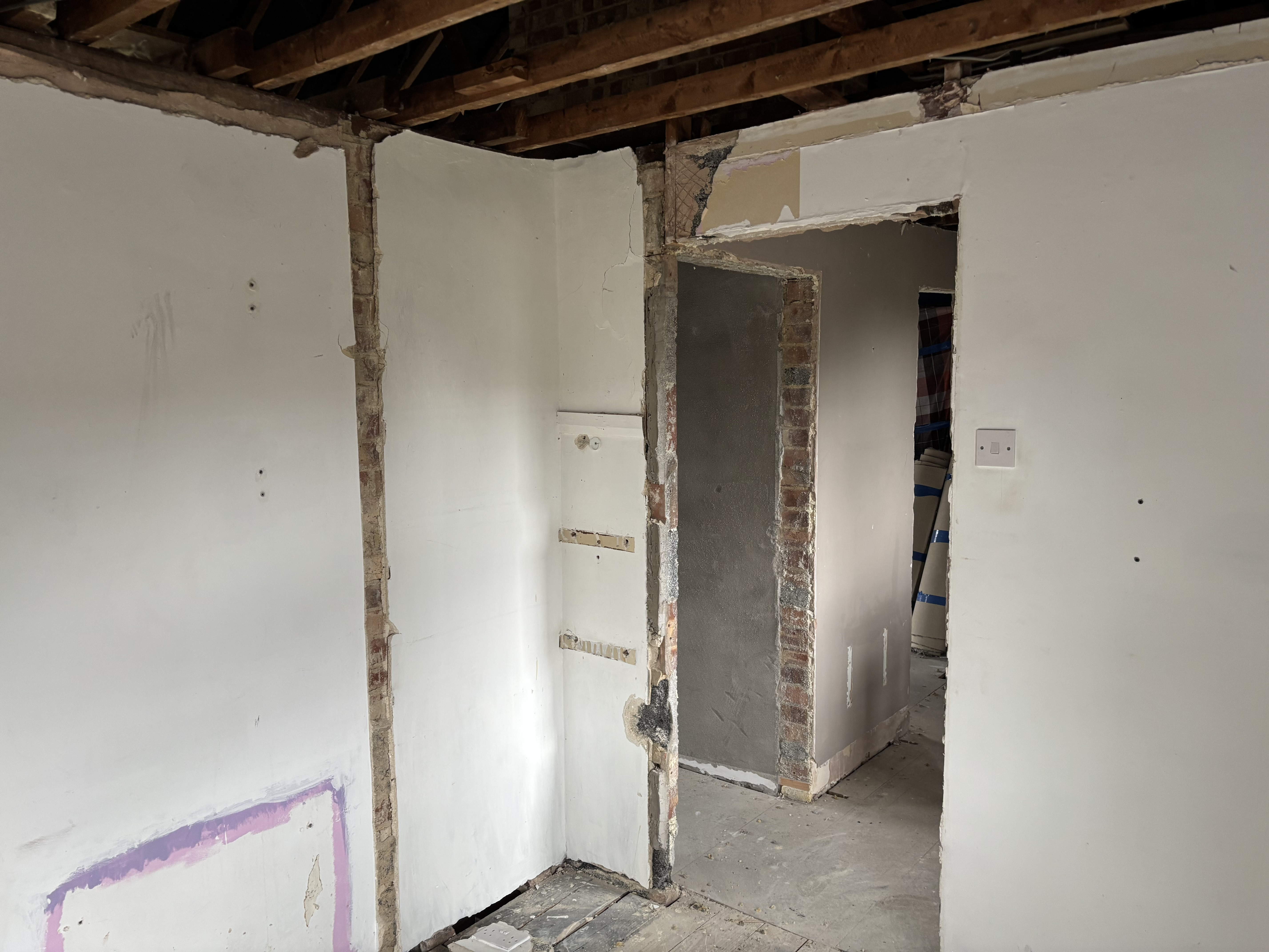

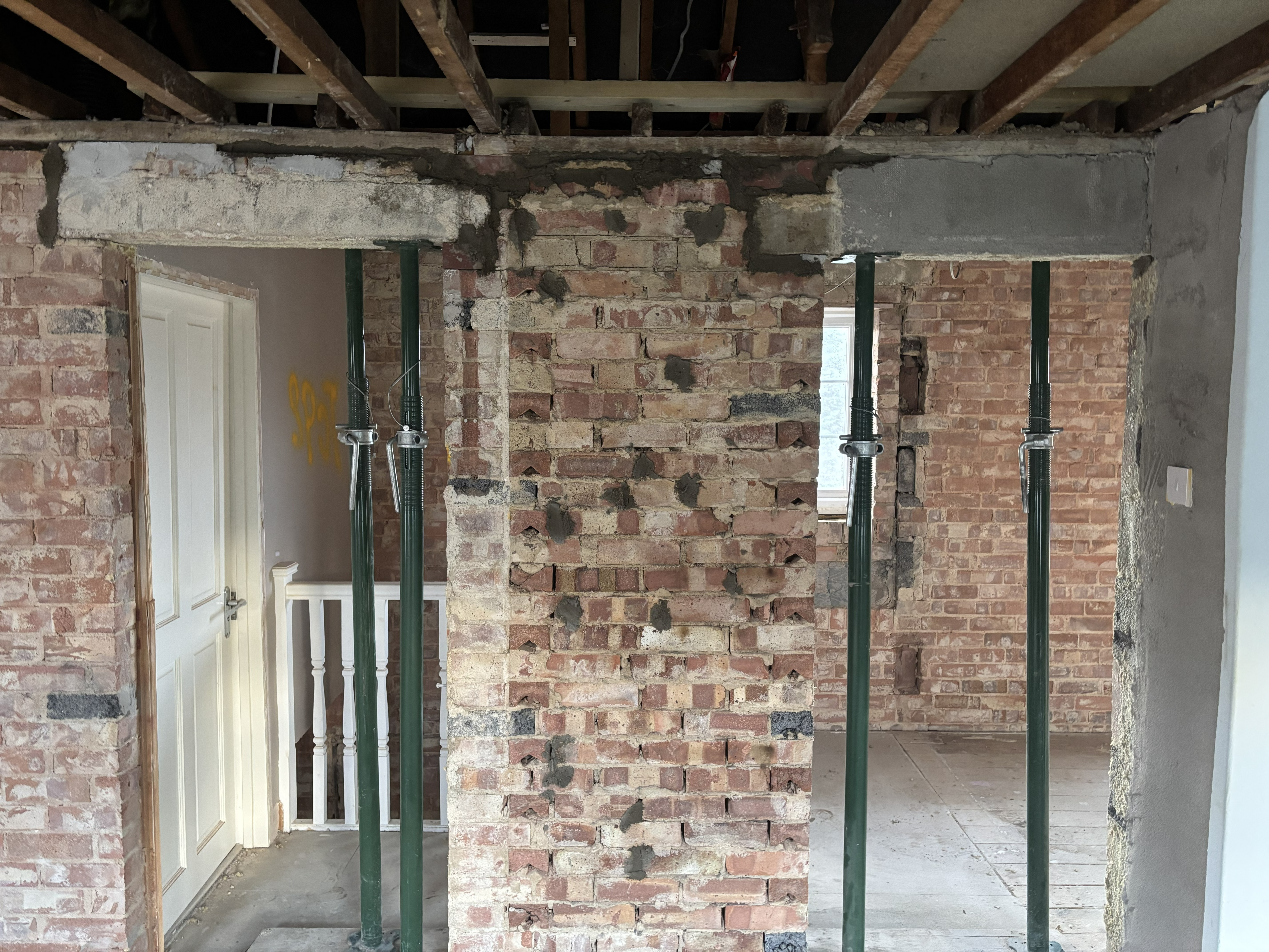

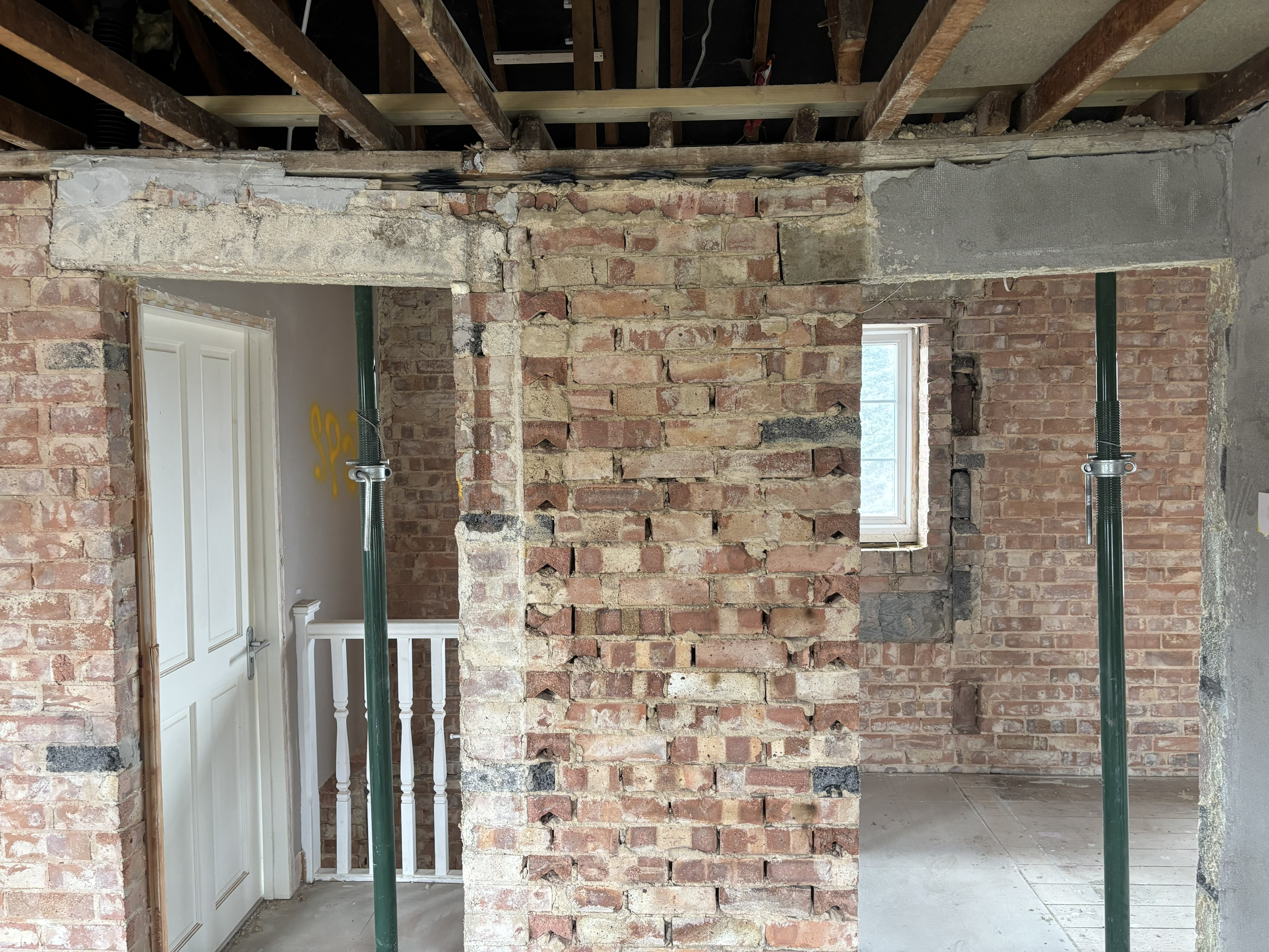

Adjustments to straighten out upstairs bedroom doorways - I can assure you they are straight now.

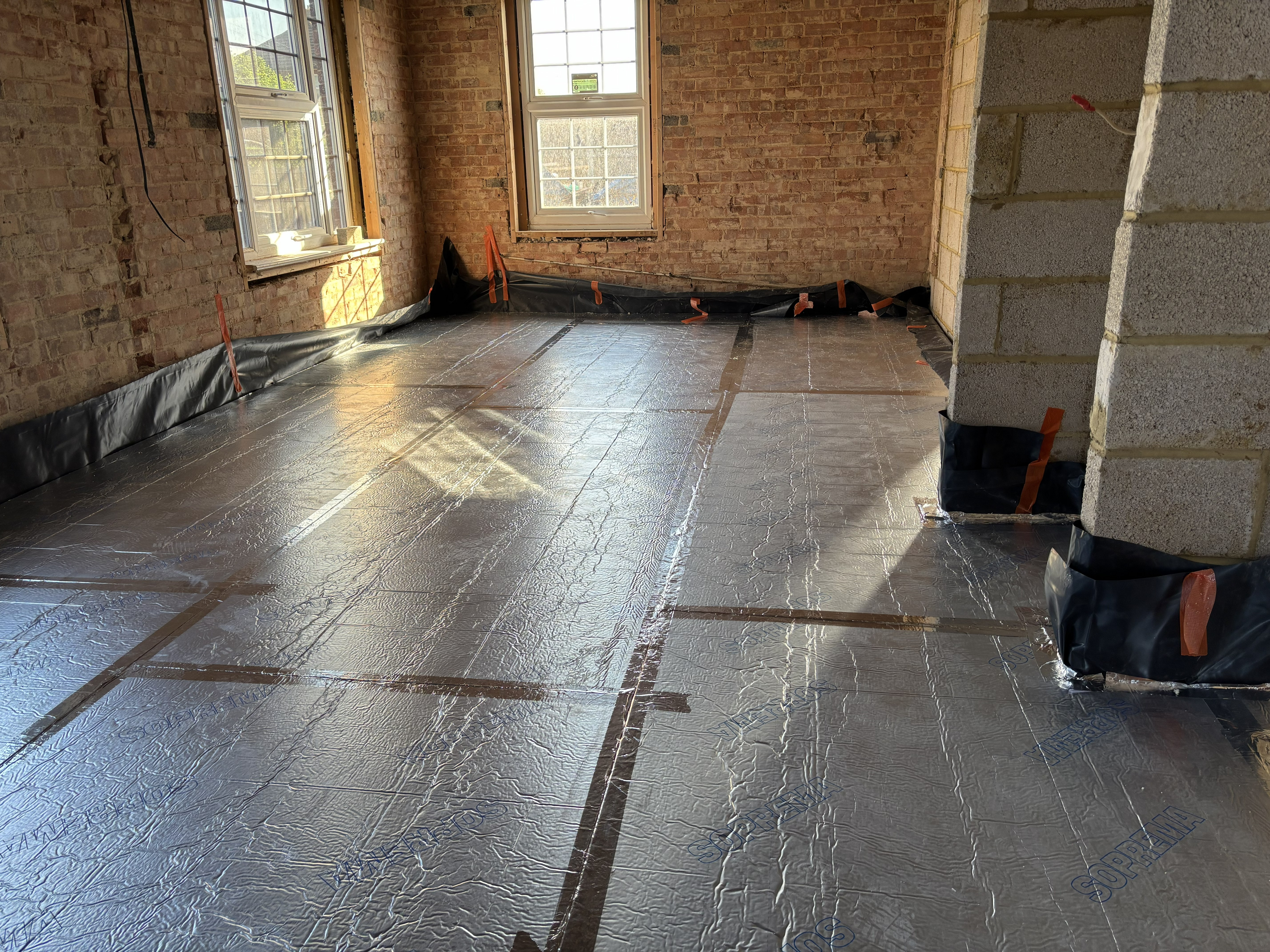

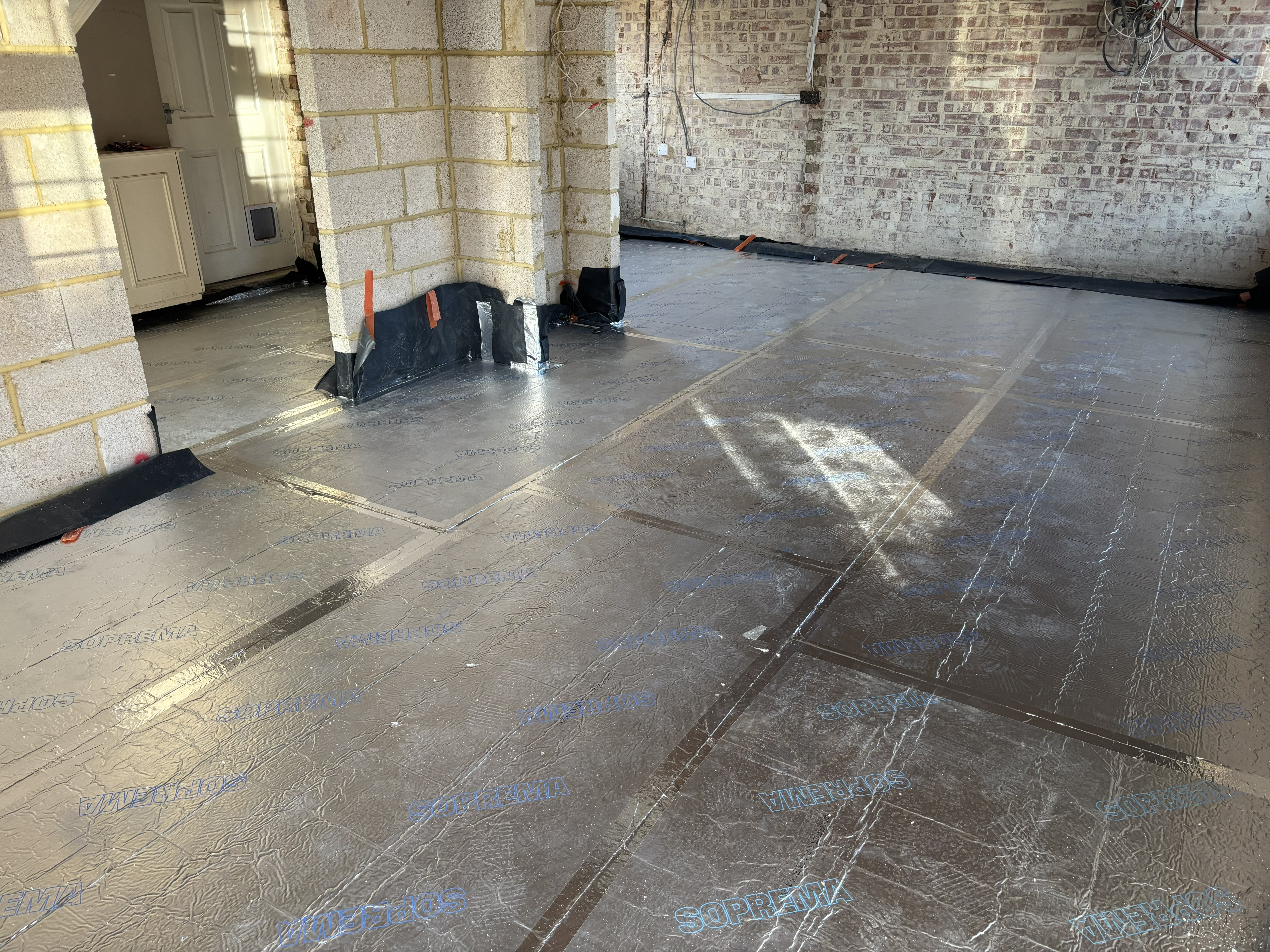

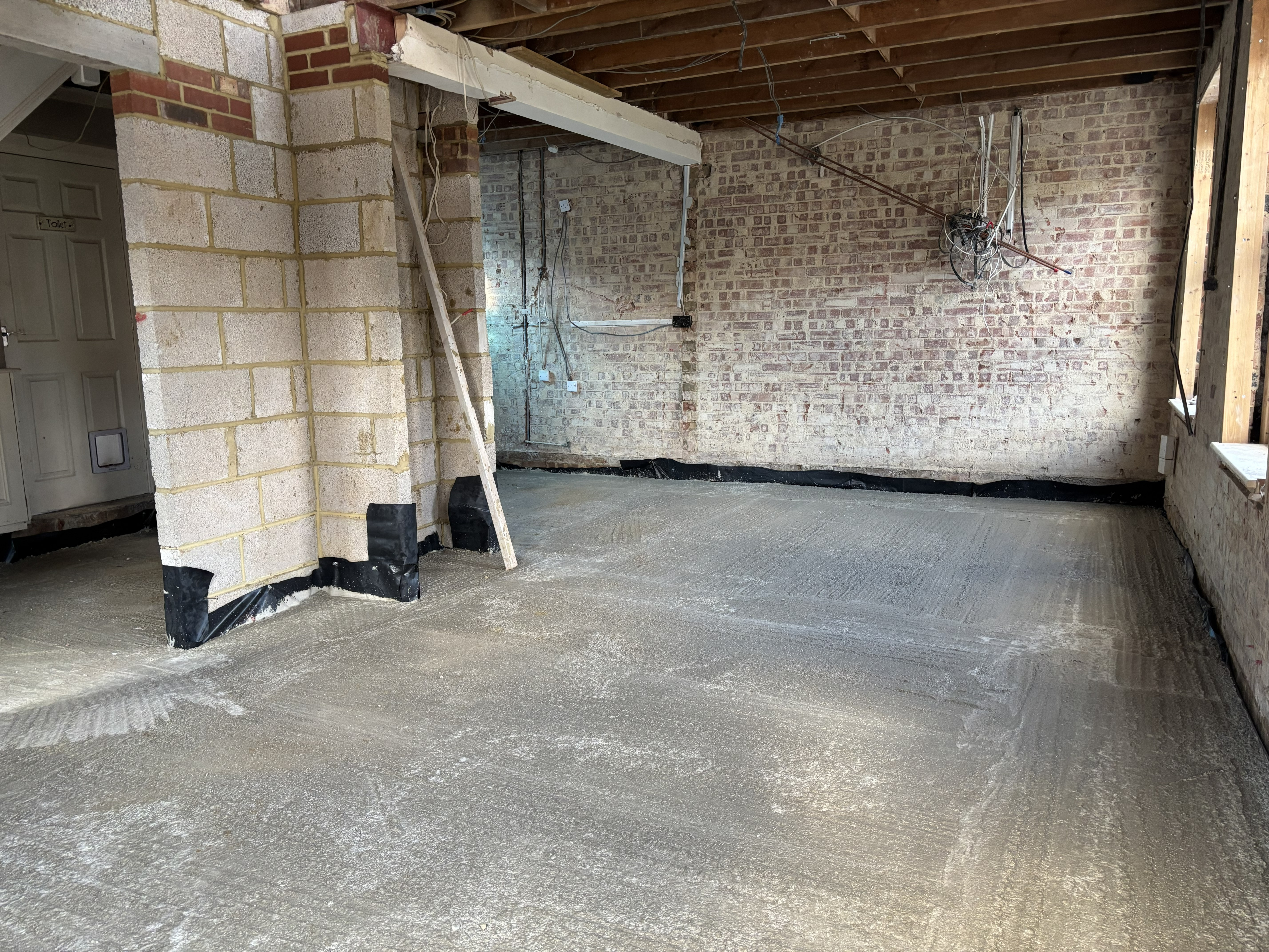

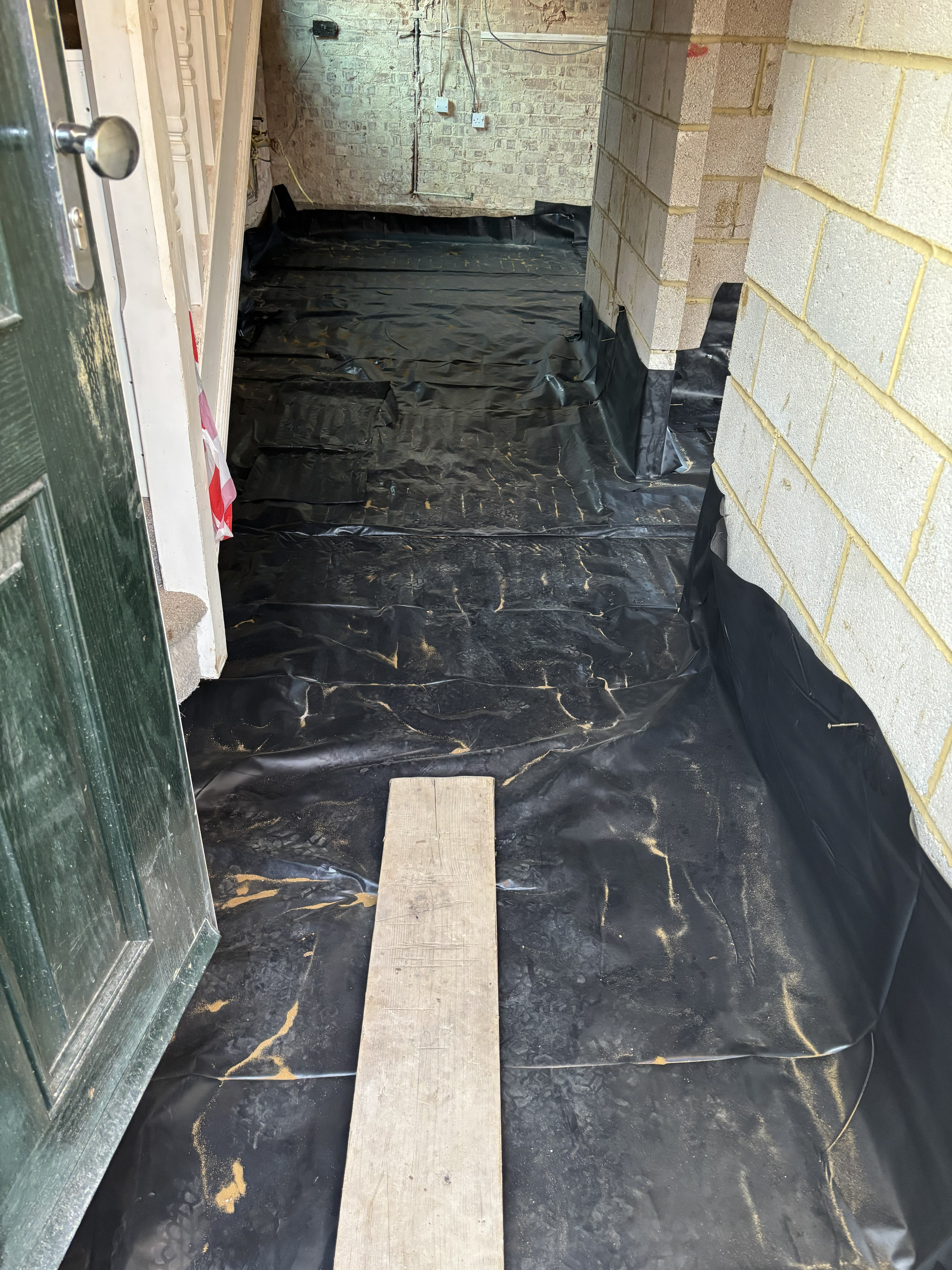

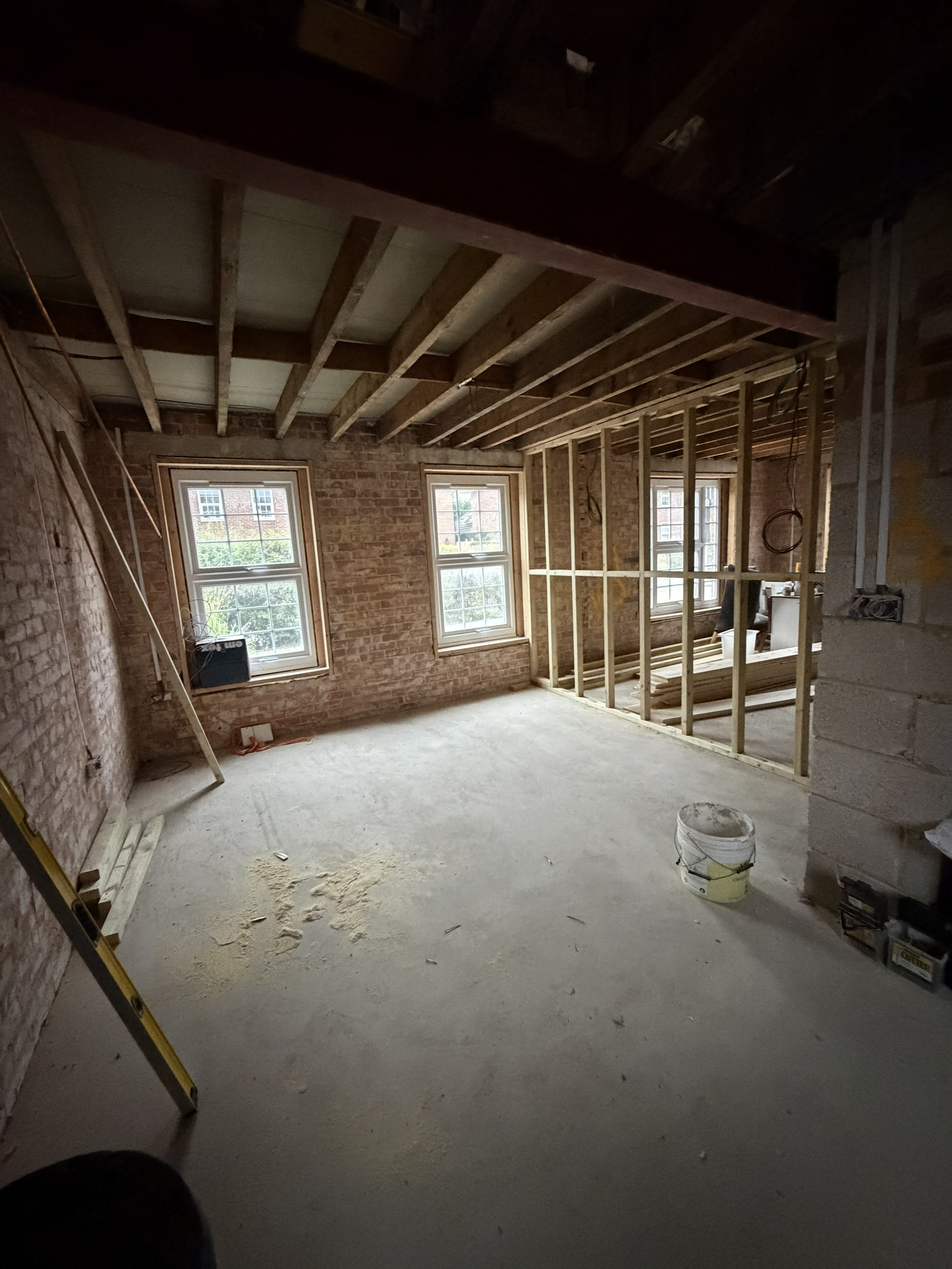

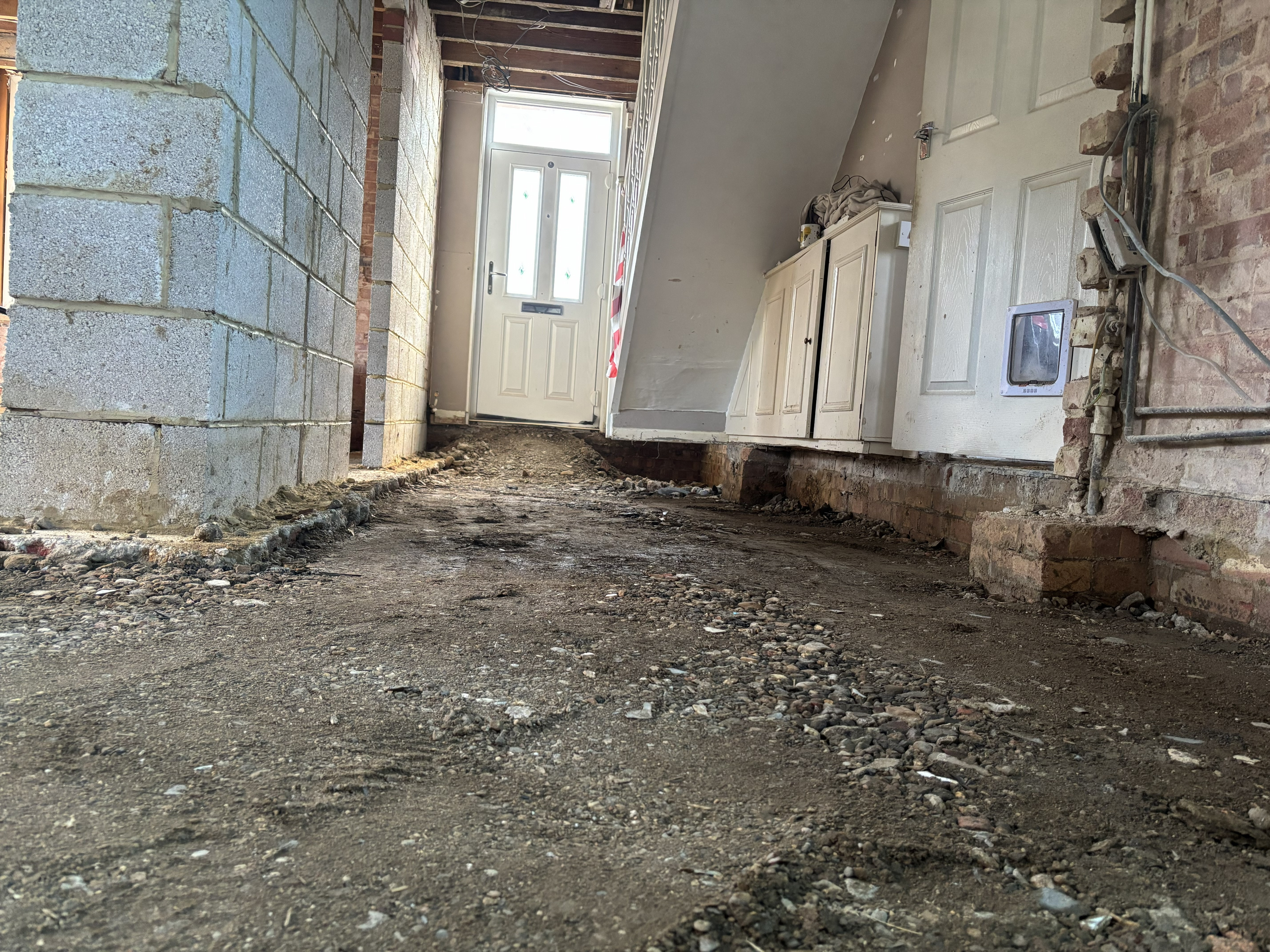

Various stages of the floor from excavation through to finish

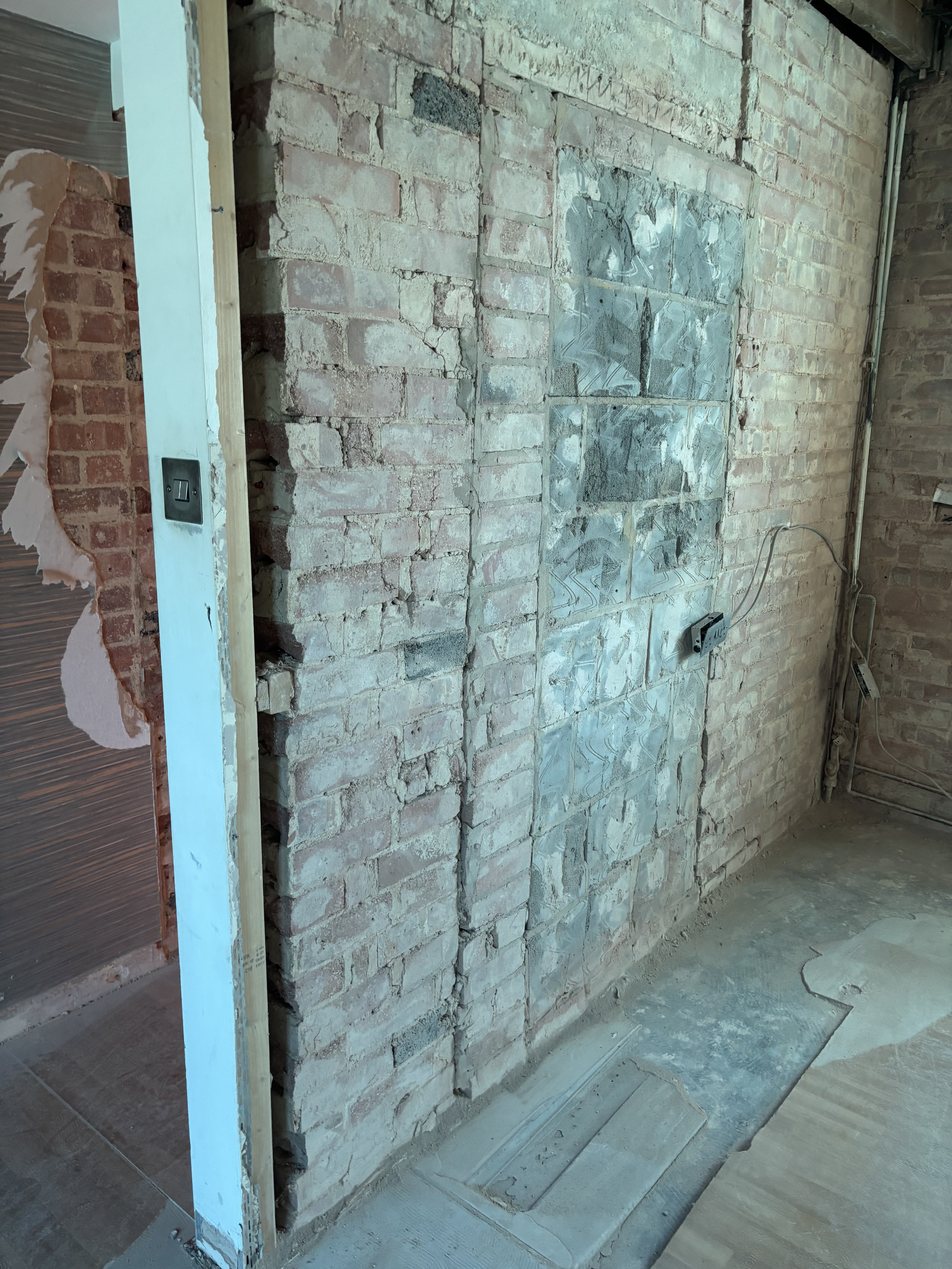

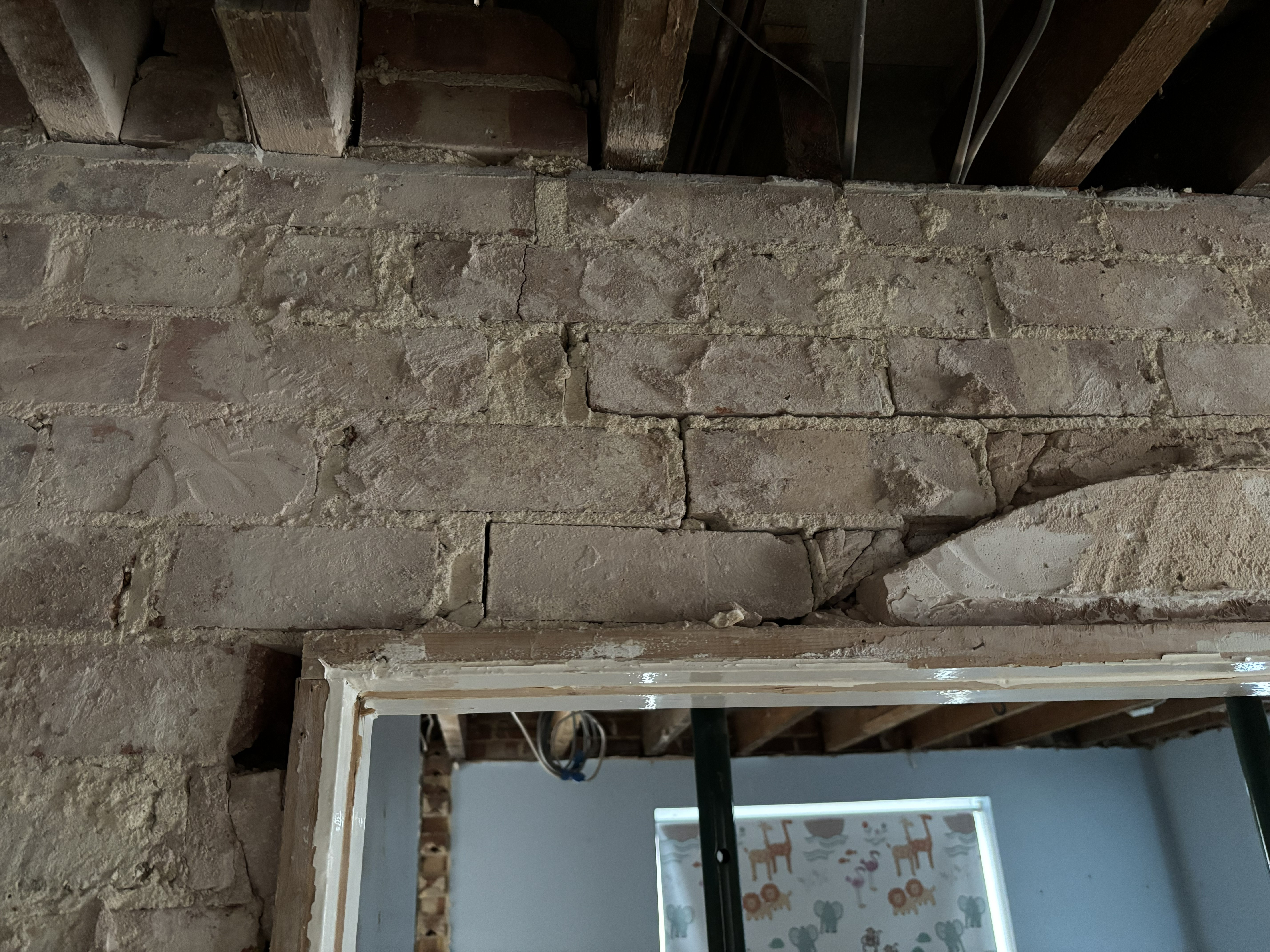

Some of the underling damage on the old supporting wall that wasnt visible before the plaster was stripped back.

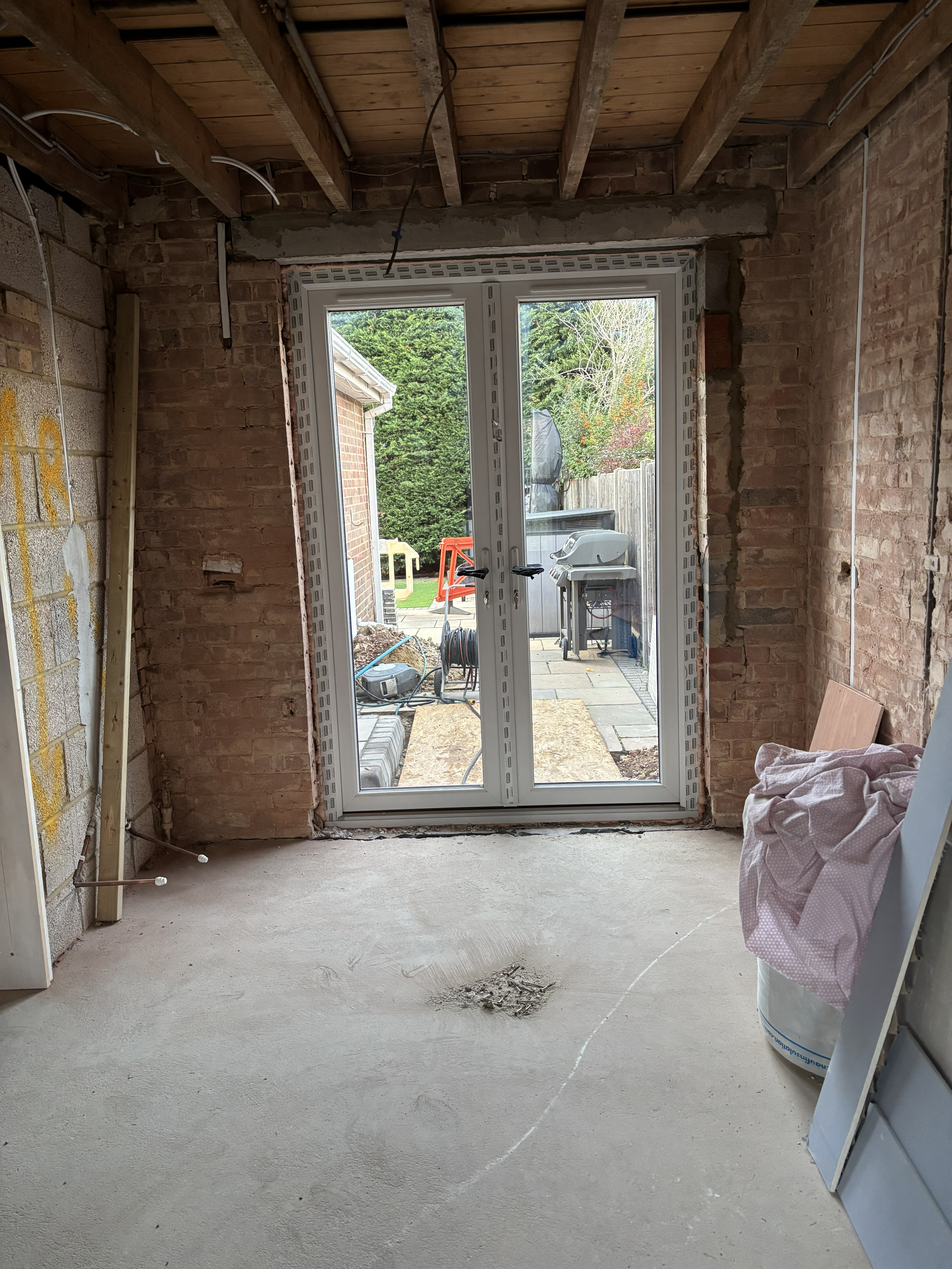

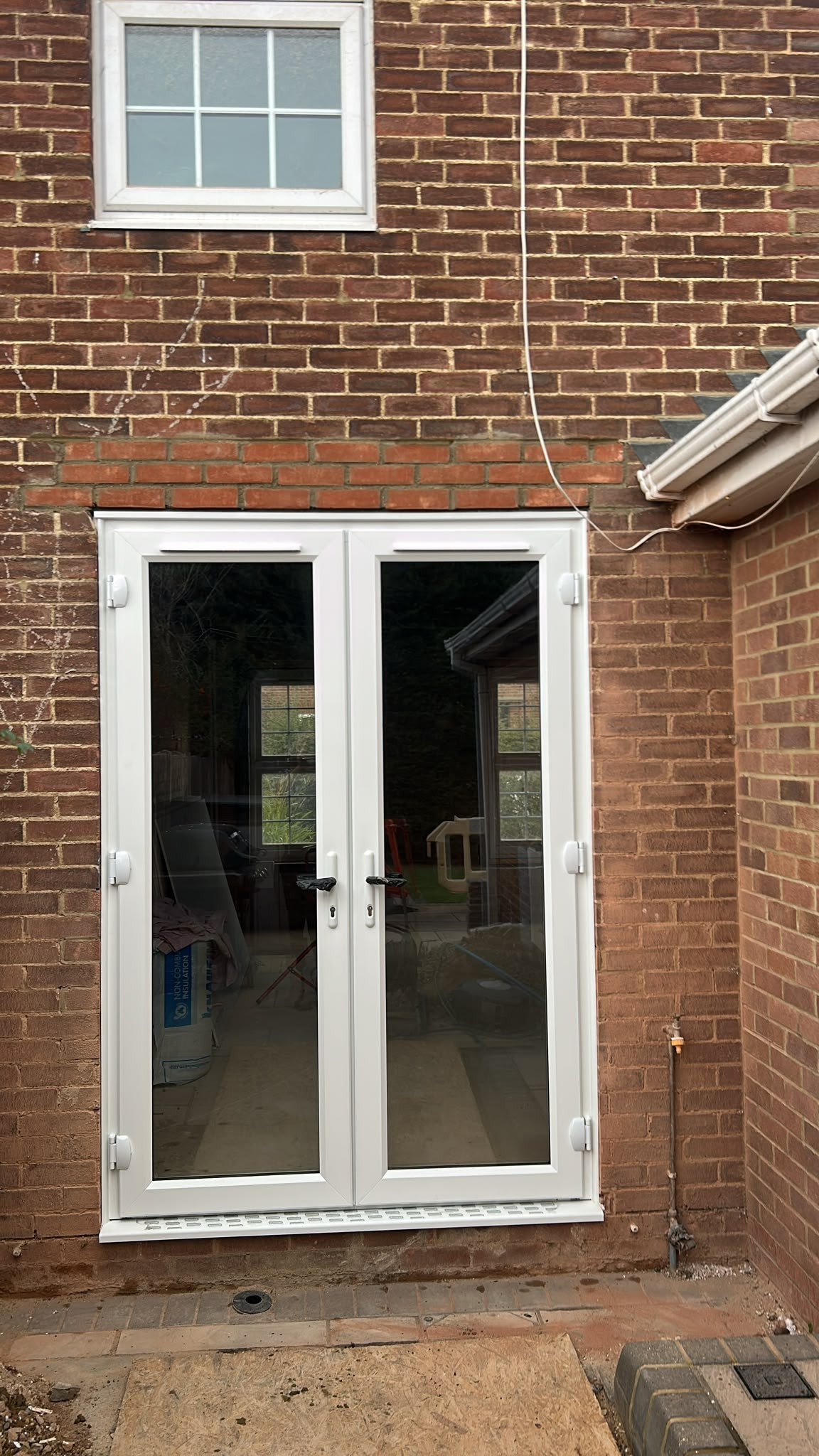

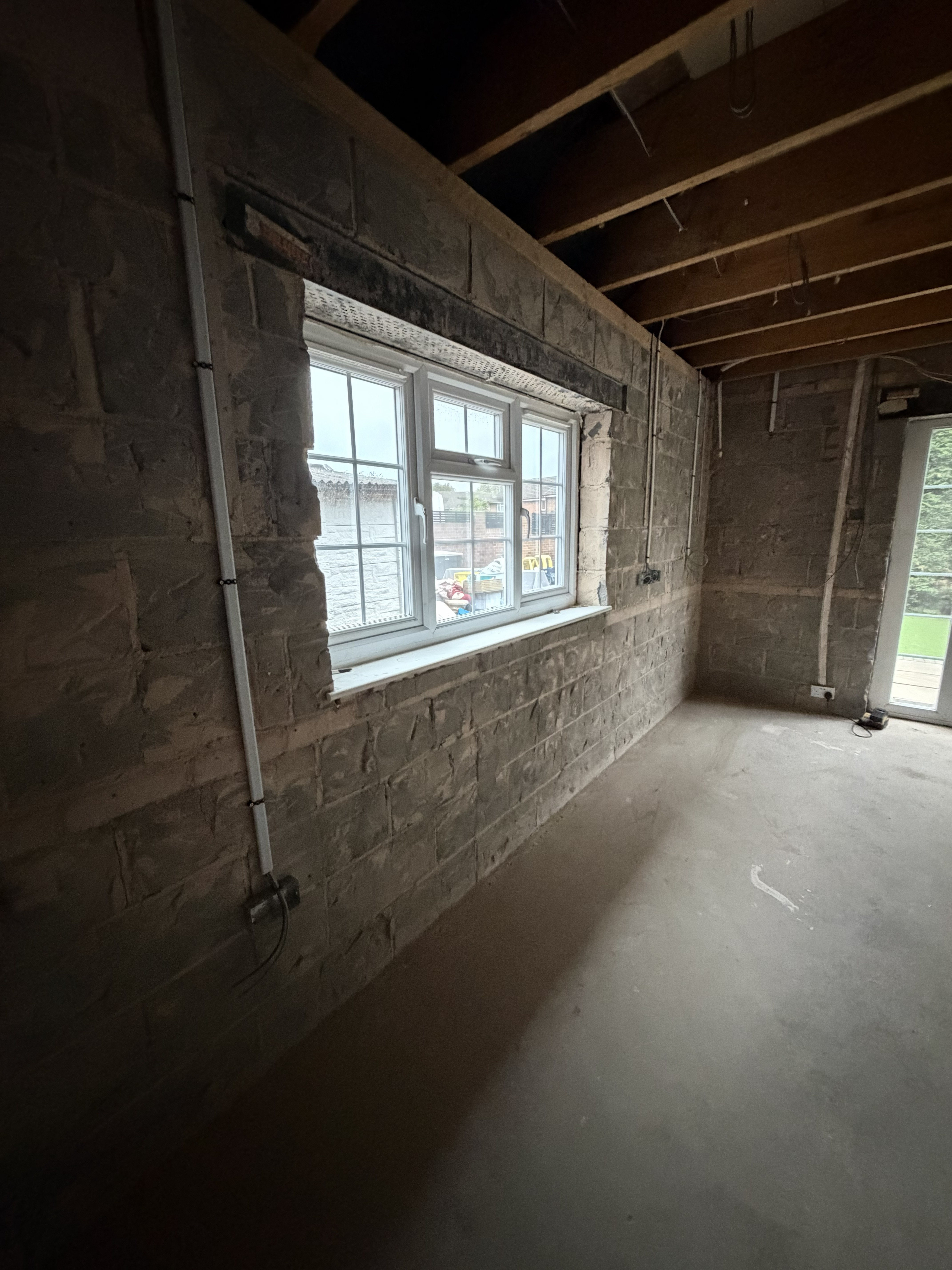

New patio door installed.

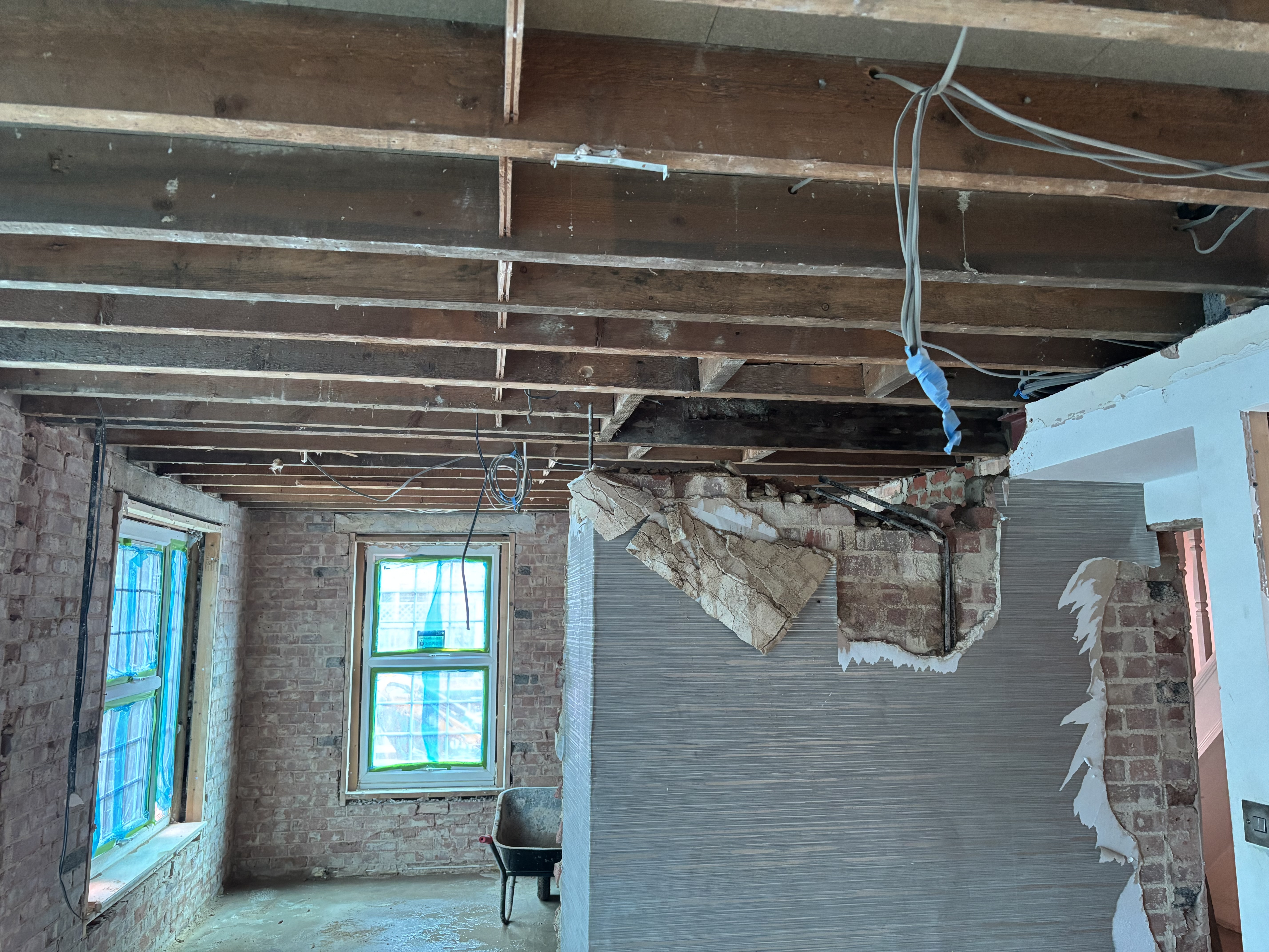

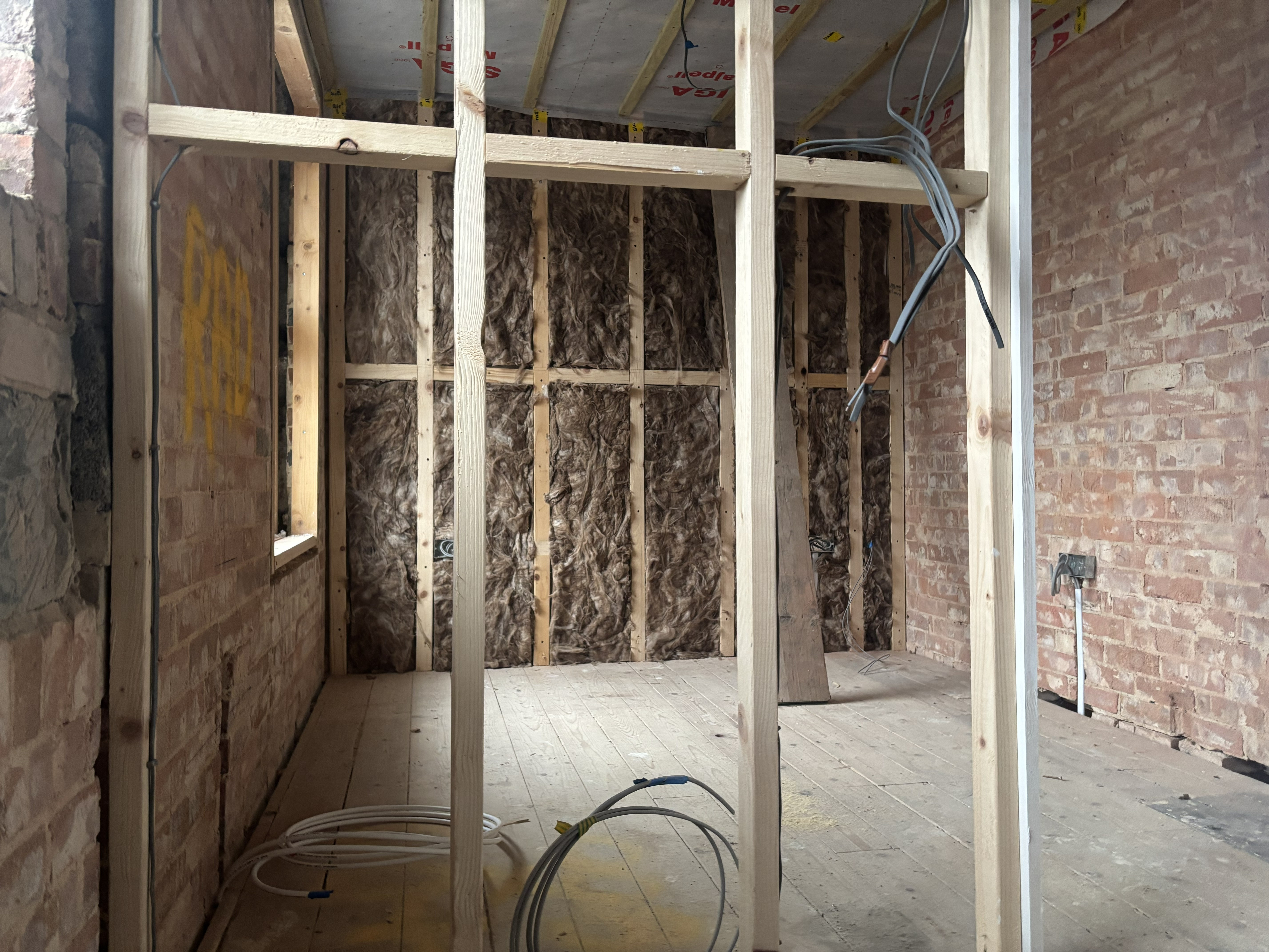

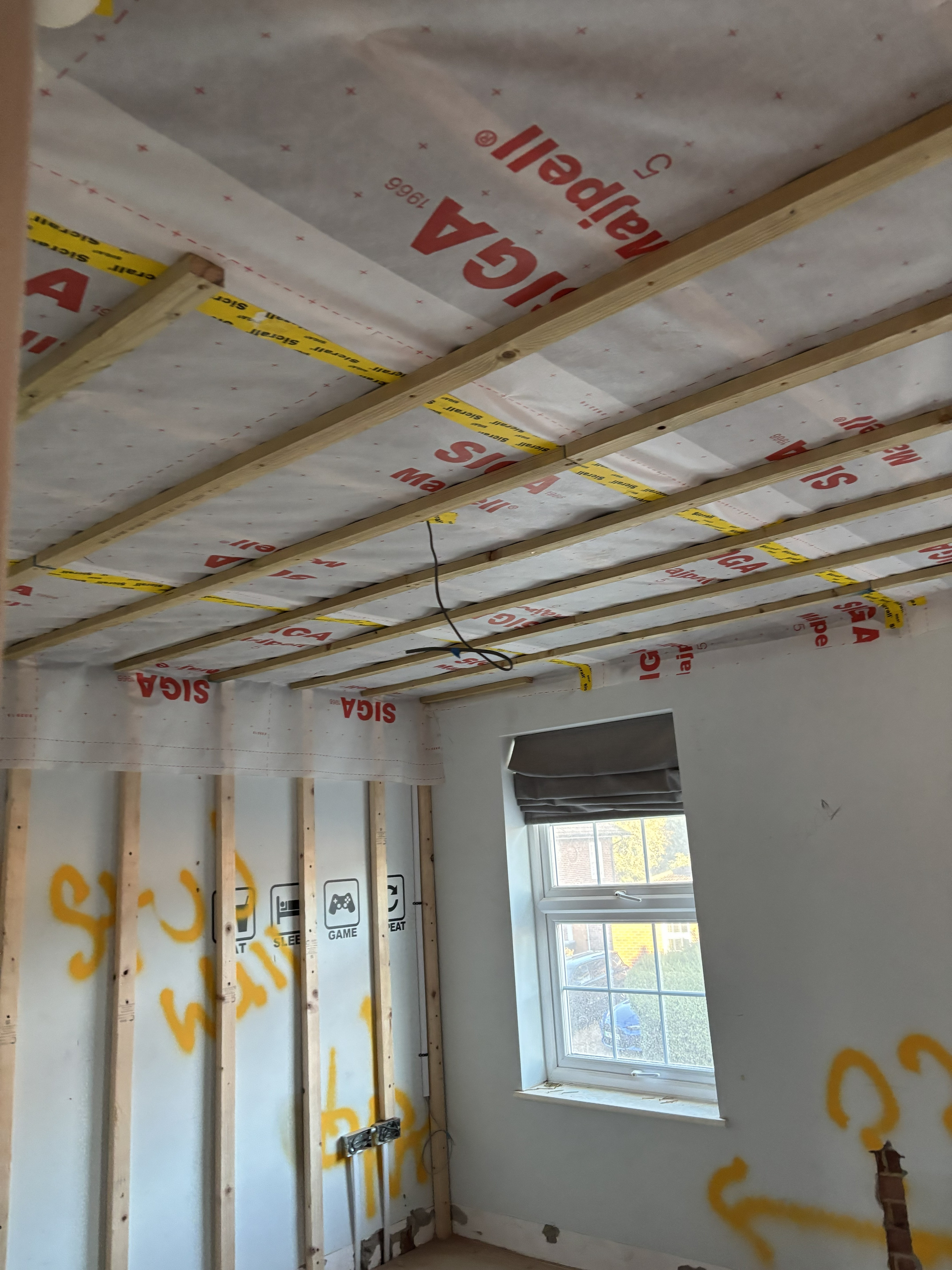

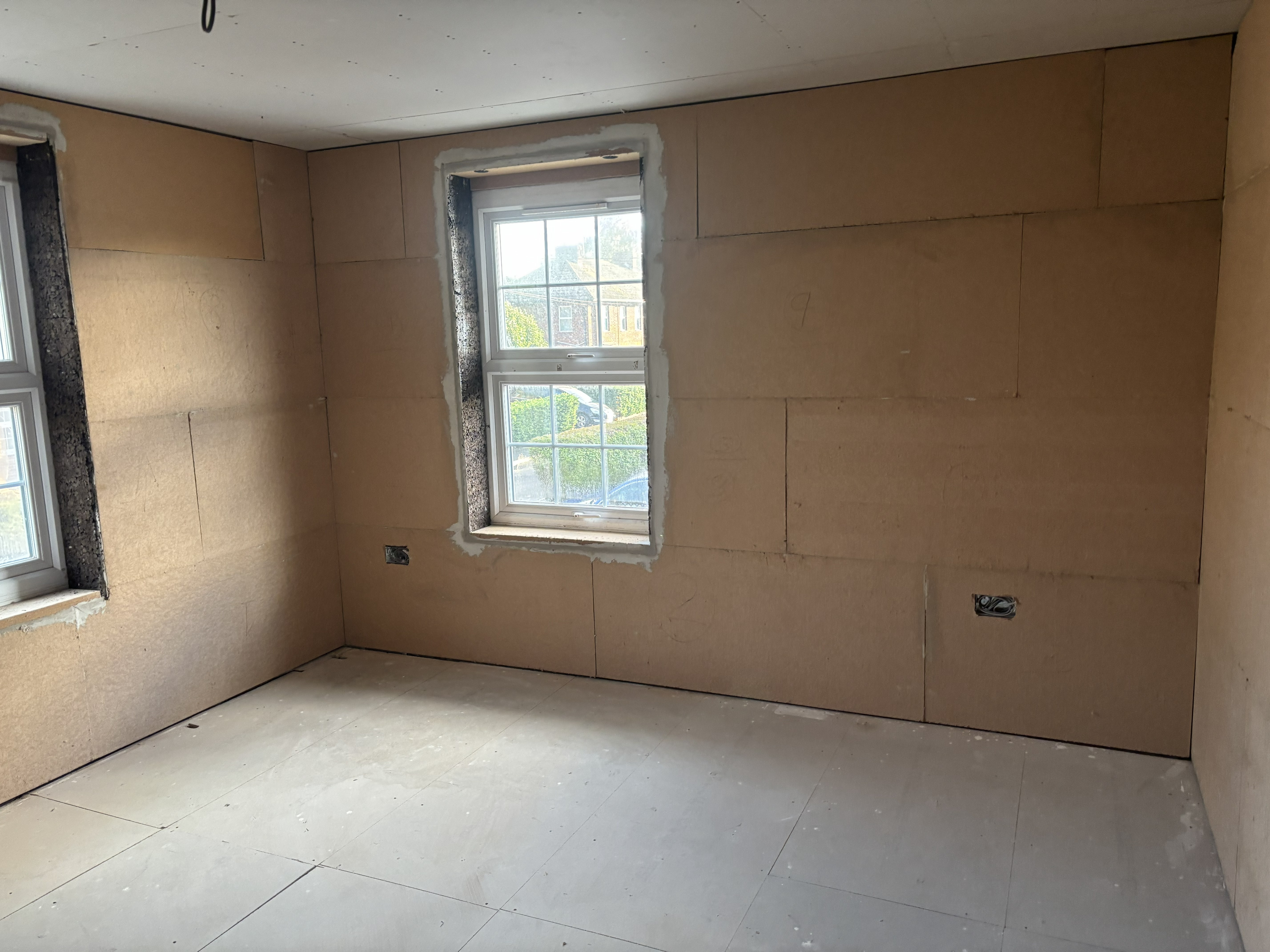

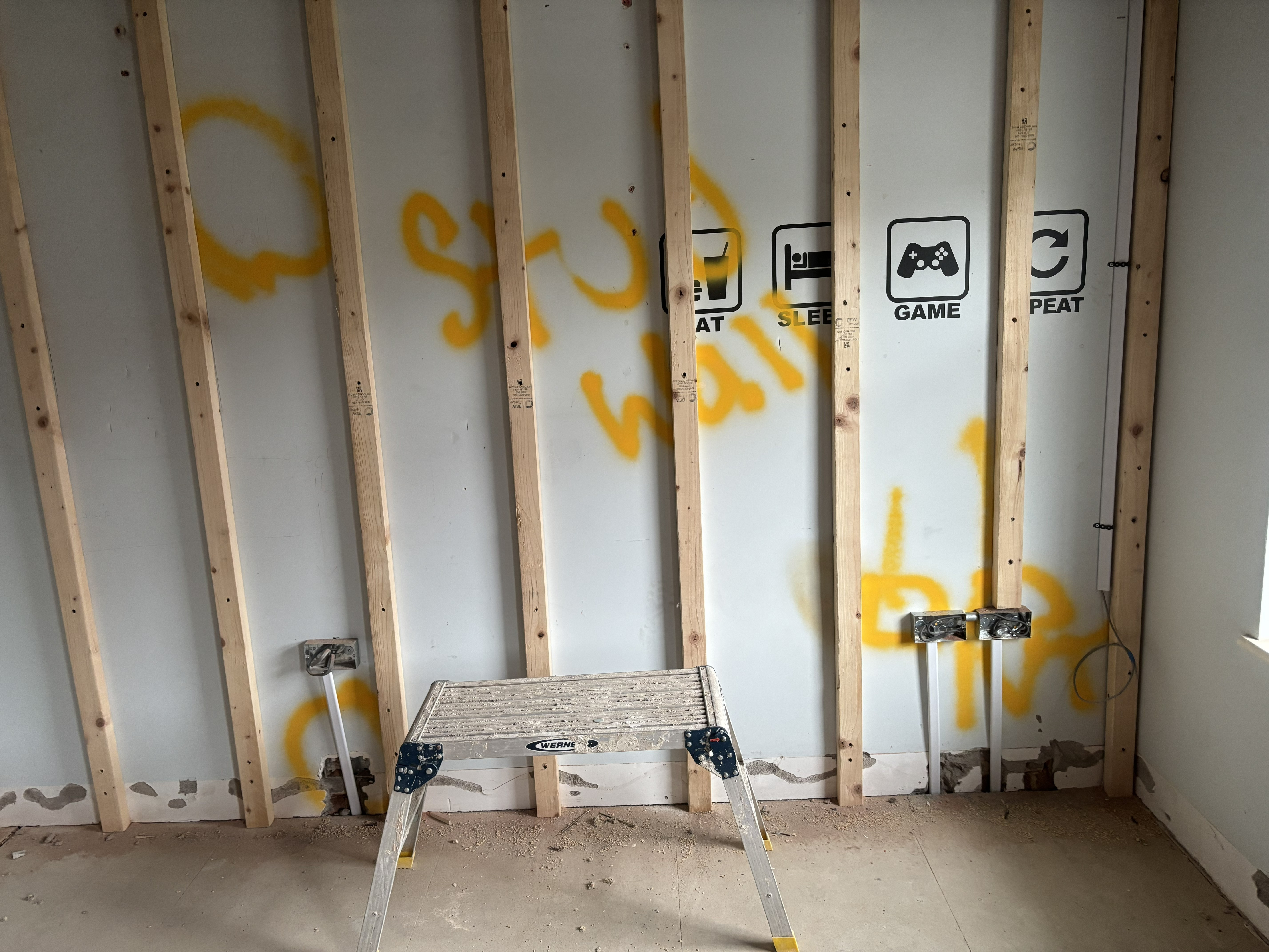

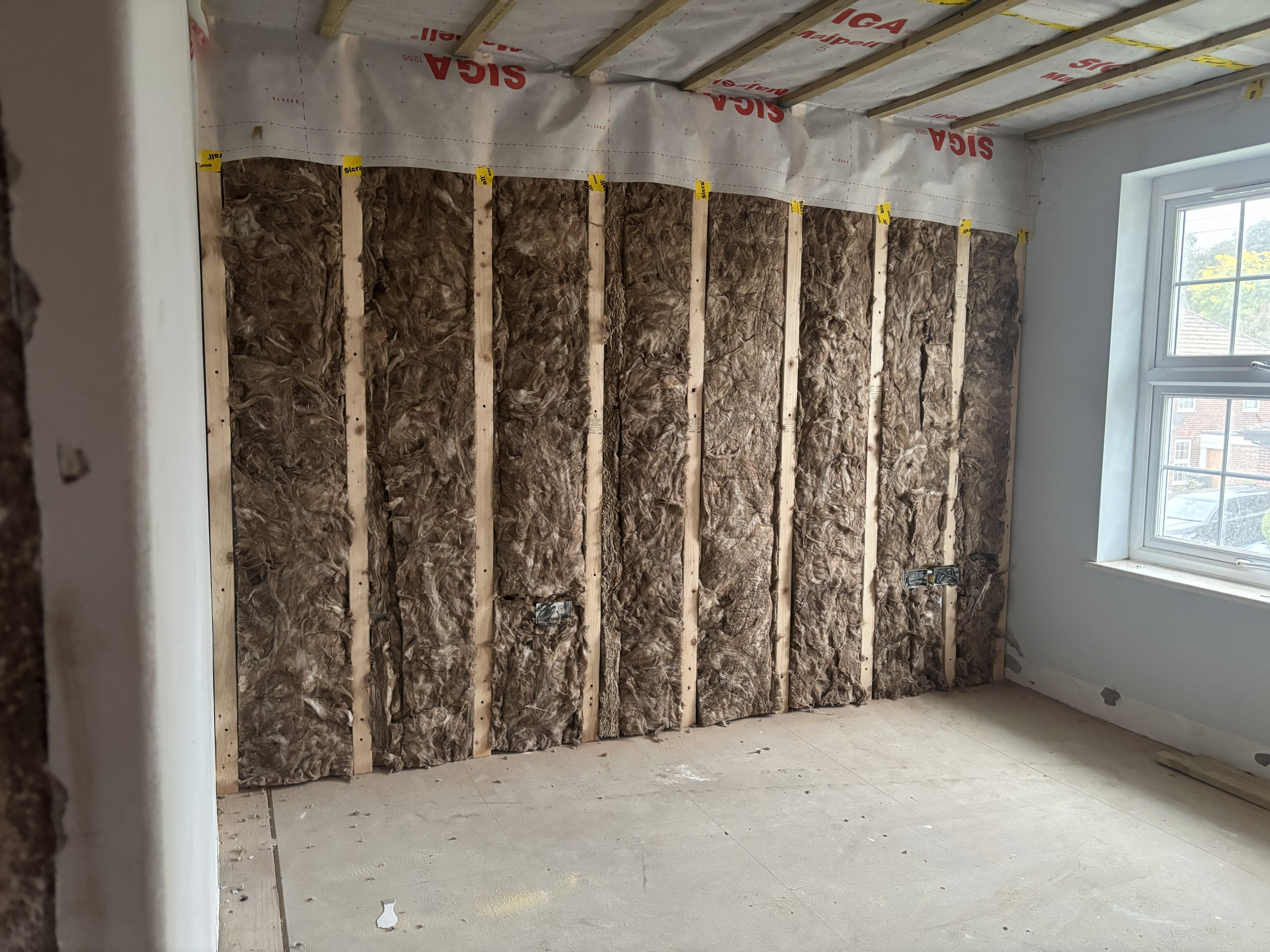

Various different elements of boarding out and soundproofing / insulation work being done.

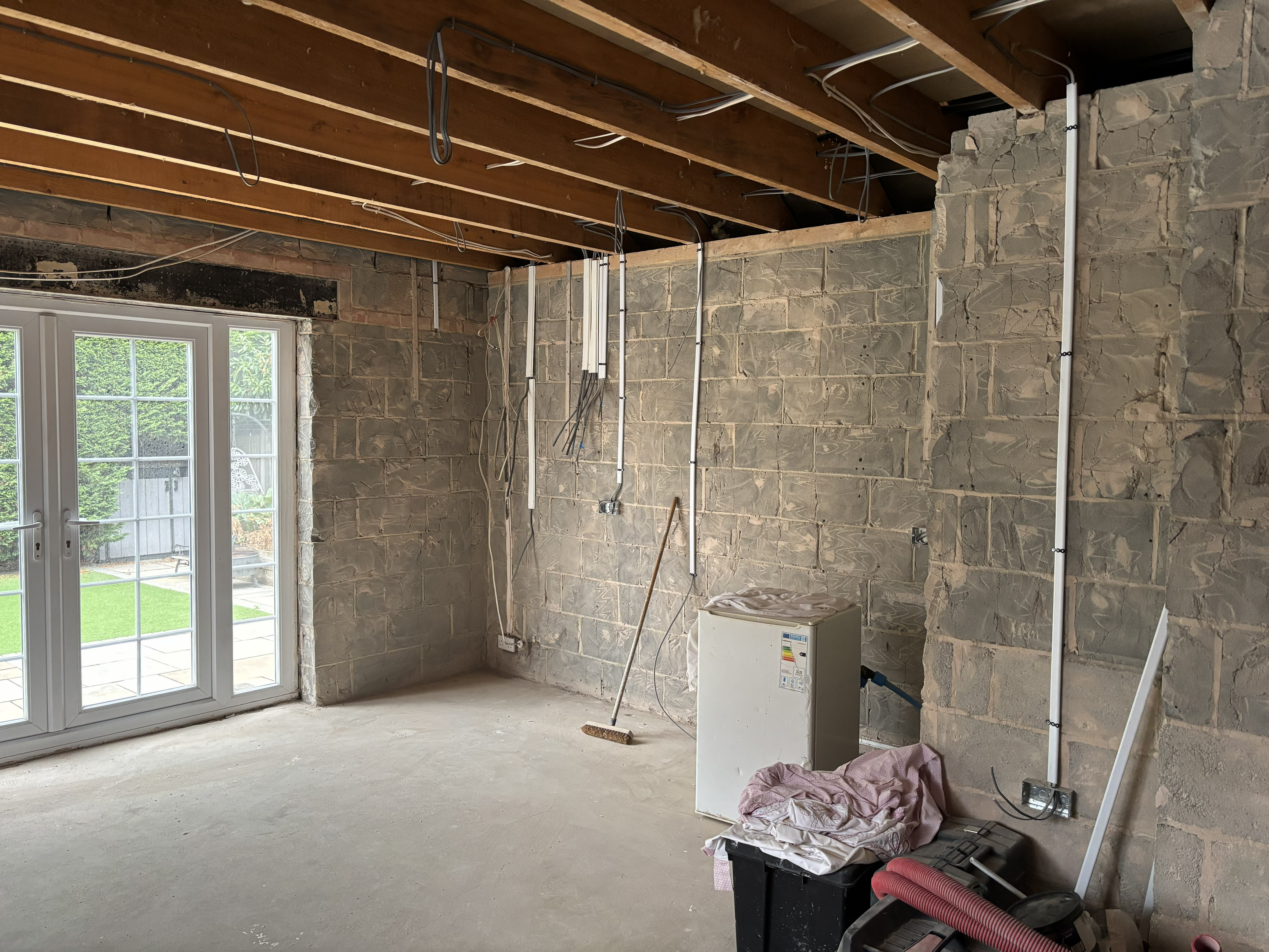

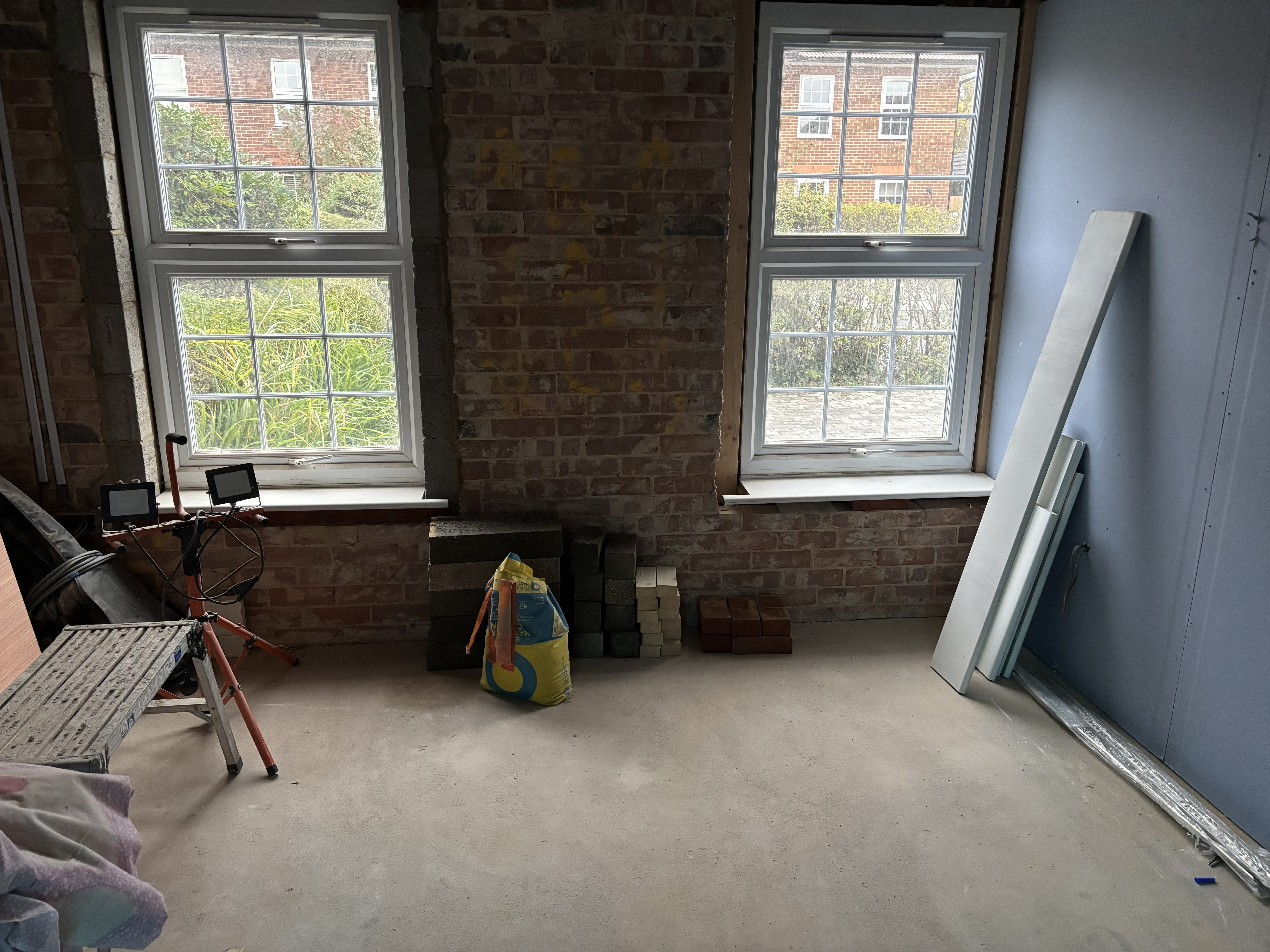

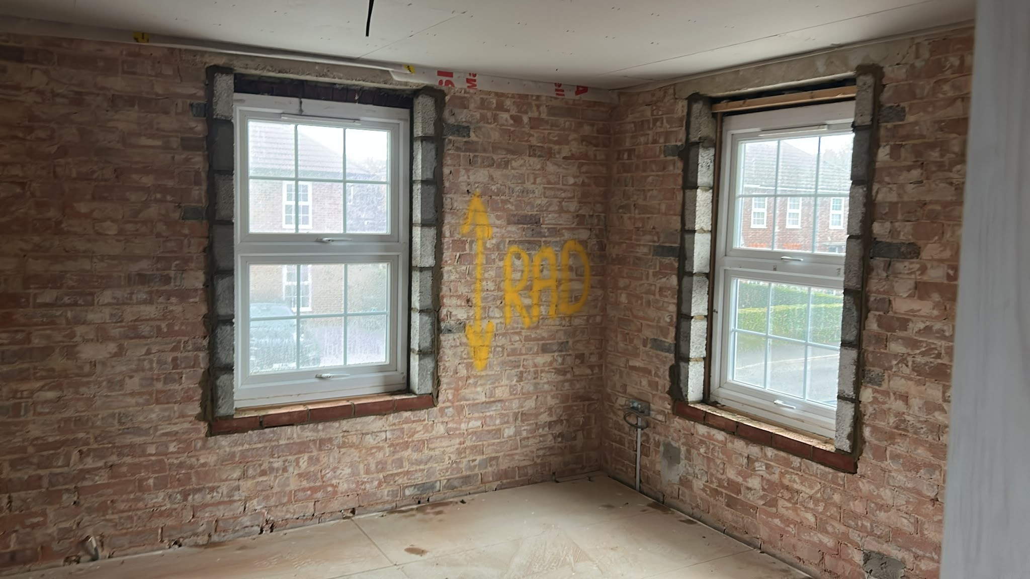

Block work fixing around the windows where previous window replacement from box sash to double glazing only used wooden framing.

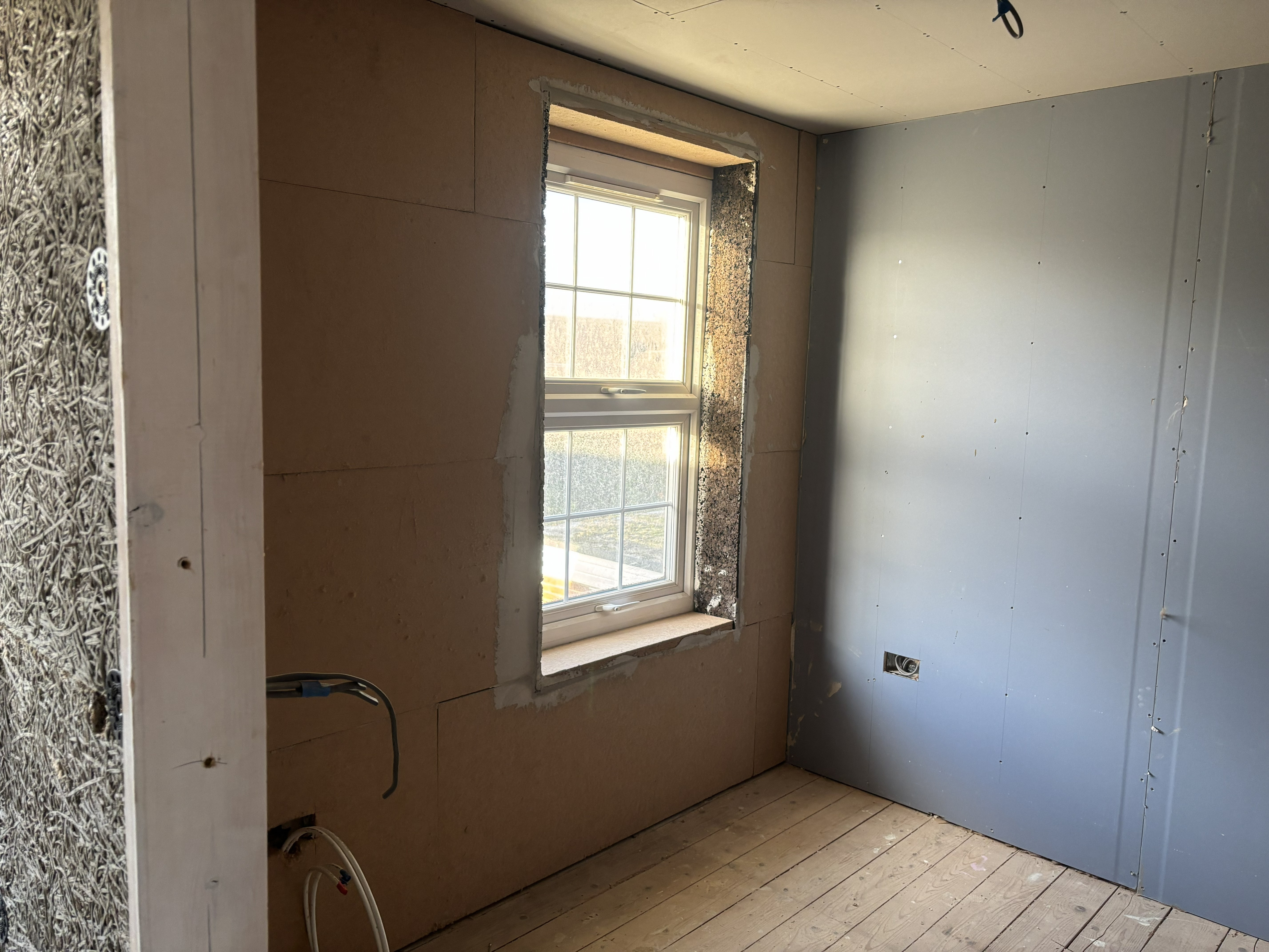

Boarding out with insulating boards

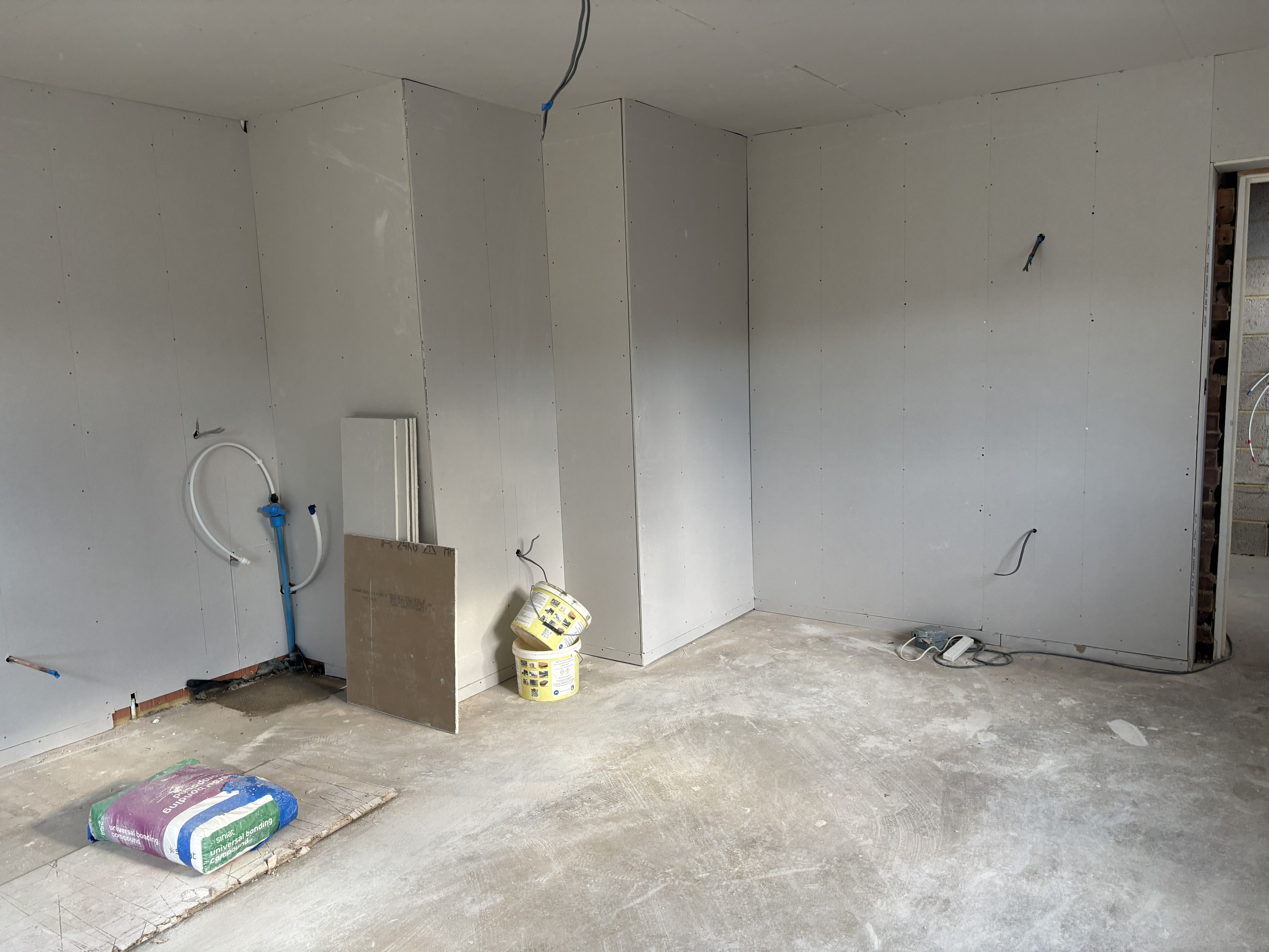

Kitchen boarding out
