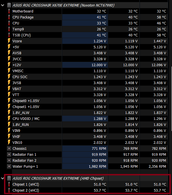

75c is way too hot idle for chipset, check the fan is spinning and clean if dusty. i'm on x670 but my chipset under load normally hits around 64c for both, i know x570 ran warm but thats why they had the fan on the chipset. this is mine idle in windows
