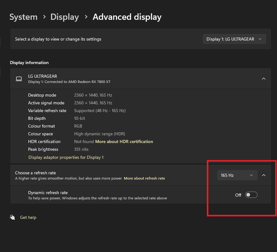

It seems there are people with this issue on Win 11, for science make sure Dynamic Refresh Rate is off, should not be running that anyway you're never going to save a polar bear by reducing you screens power consumption by 3 watts.
And set your refresh rate to 60 Hz, just to see if that fixes it, if it does use Display Port if you can or get a new good quality cable.

I don't have any display ports with it being a tv or support for dynamic refresh but putting the display @60hz seems to have sorted it, Thanks for the tip!
