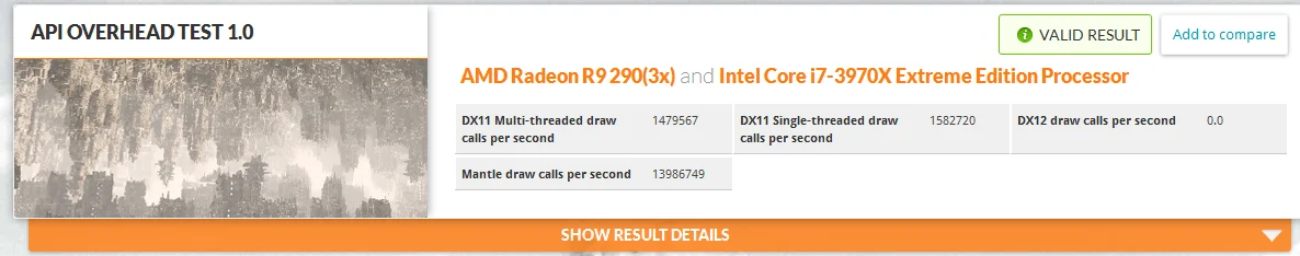

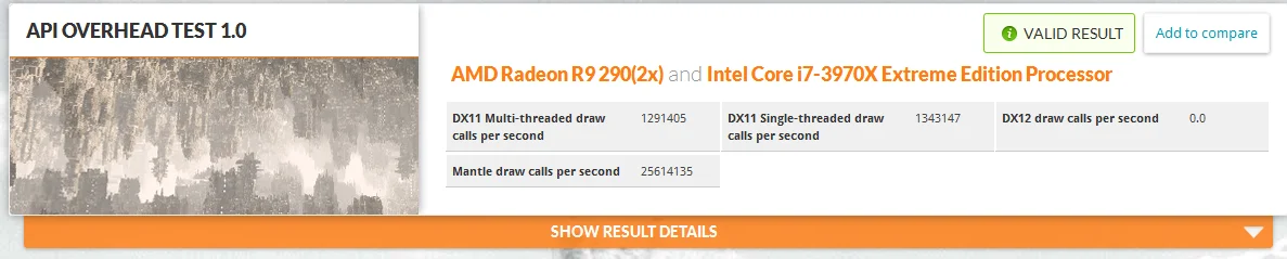

DX11 Multi-threaded draw calls per second 722,498
DX11 Single-threaded draw calls per second 740,868
Mantle draw calls per second 14,133,384
http://www.3dmark.com/3dm/6376119
http://www.3dmark.com/3dm/6376023
