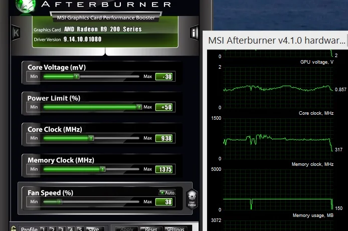

I get stutter on League of Legends if crossfire is enabled. The game uses hardly any power so the gpu usage keeps dropping to idle which causes the stutter. Best way to fix it with a single gpu is to use MSI afterburner or similar and force constant clock speed or voltage so there is no throttling.
