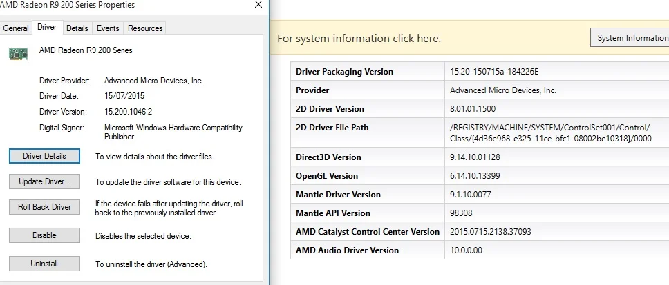

So im running Windows 10 now, as you do
Using drivers 15.7 im getting horrendous framerates in GTAV, anyone else come across this?
Everything else is running al-right 3DMark show shows scores consistent with Windows 8.1
I get really bad framerate with gta v on my 7990, I'm still on the insider build and if i turn the grass to the lowest setting and change Vsync to half it helps a bit.
My GTA5 was running rubbish on the 15.7s from the AMD site.
A driver update through Windows 10 fixed it.
The driver "update" via win10 actually rolled back to an older driver AFAIK.
Use the driver through Windows update - fixed it for me!
