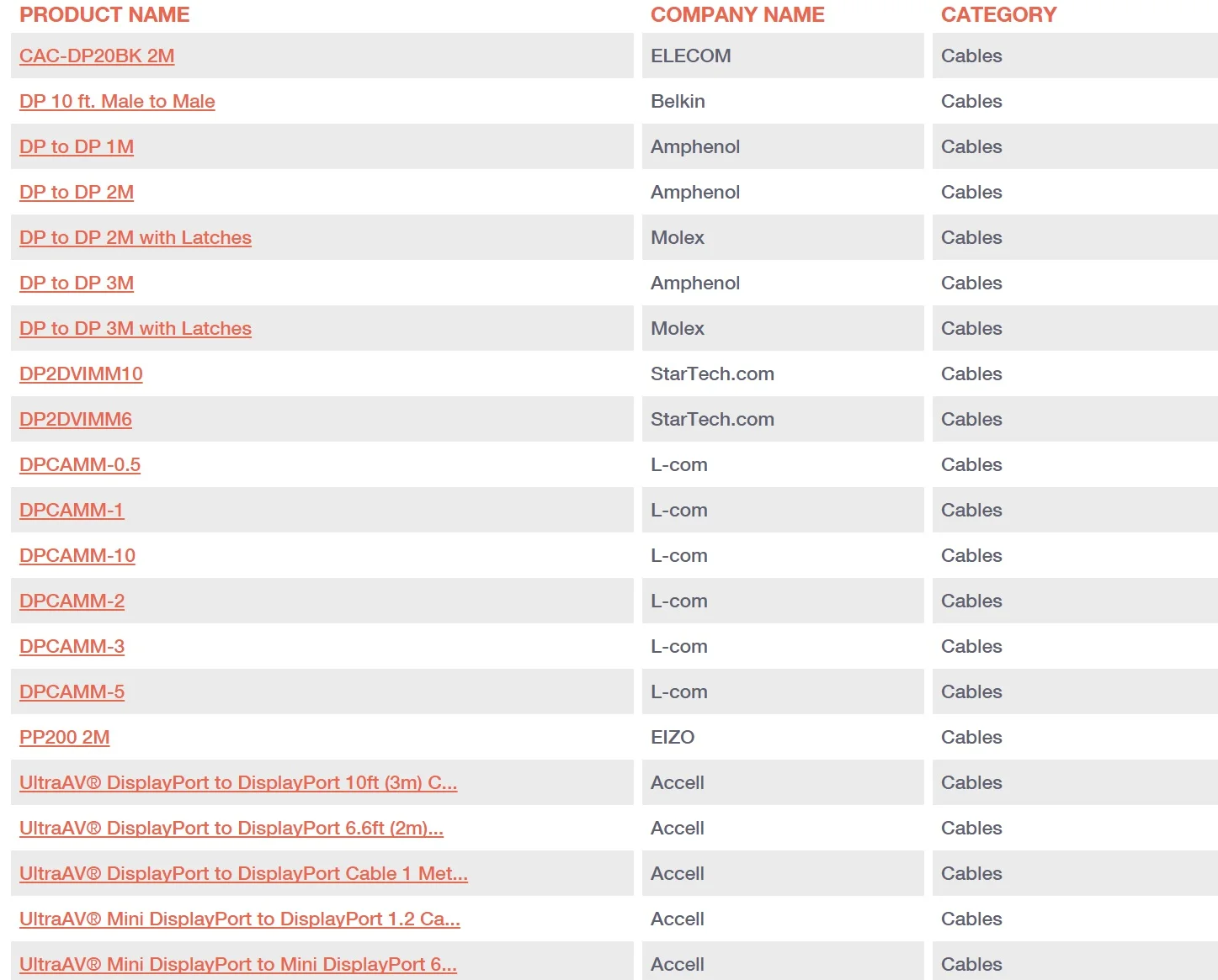

Thanks Panos. If you spent some time searching through my posts @ OcuK or even the AMD forums, I'm forever telling people to use certified displayport 1.2 cables. There's a lot of junk DP cables floating round that often come with the display, i see situations like this every day in my job.
We recommend people use only cables that are on the Display Port 1.2 certified cable list. Is your cable on there?

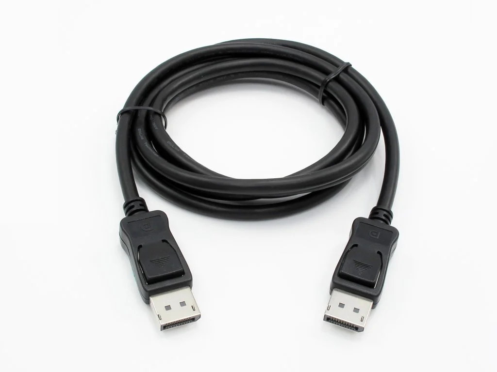

I'm currently using one of these, Accell UltraAV B142C-007B DisplayPort to DisplayPort 1.2 Cable with Latches (6.6 Feet / 2m) which is in the list. :)

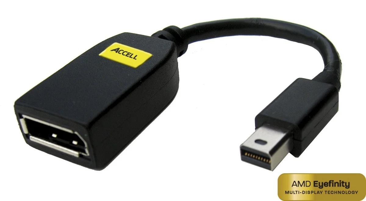

I see yours has a minidp connection on one end. Since getting my 295x2 i needed an adapter too, so i again went with an Accell B112B-001B 10 Inches UltraAV Mini Display Port/DisplayPort(f) Adapter - Black pictured below. This is also on the certified list. :)
I don't have any of the issues you described, so this would be my first port of call. :)
