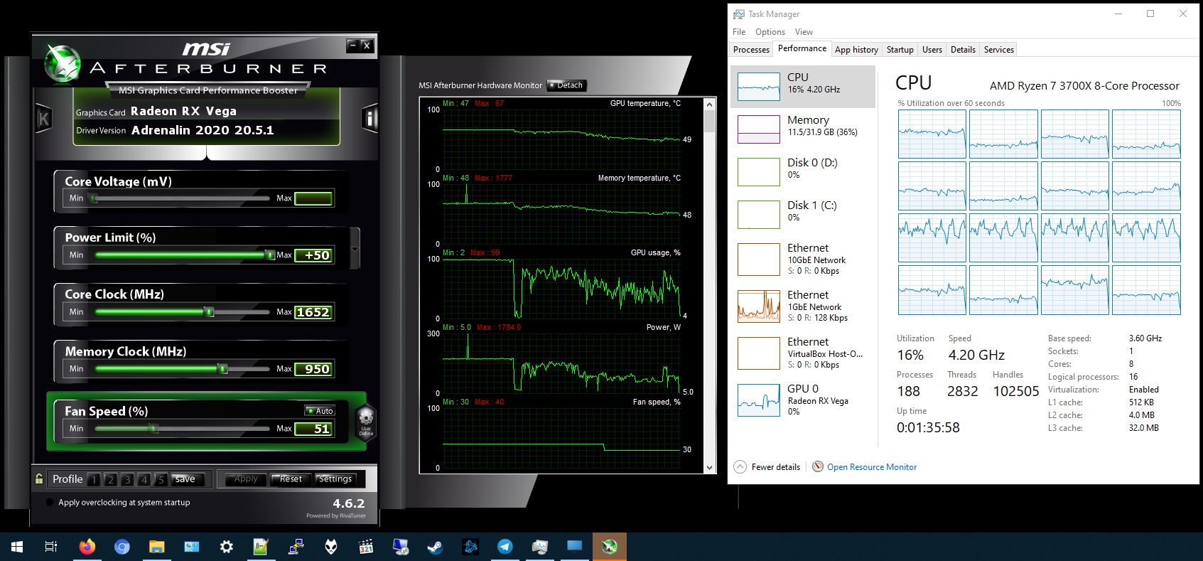

I find it sticks if you don't go too far, I run 1150mv, - 5% power, and 58% fans that sticks, but if I set the volts lower by the next reboot it resets even if it never crashes
it's weird, been no issues until a week or so ago. i can load my preferred profile and it'll bench perfectly fine, will game perfectly fine then it'll just randomly change values......pumps the clock way up and drops voltage down and bang driver crash. heat isn't an issue as it's under water so am totally baffled by this. will have to dig a bit deeper and see what's going on.
It does not like MSI Afterburner, if it wants to do something different to MSI AB it will have an argument with it and crash.
The software seems very protective of the hardware, it seems to react even it appears to be fine, it's a pain because I can fine tune it much more than I have but the software says no.
Ohh ok you might be on to something there, I usually have AB running to display fps, temps and the likes (for no reason other than I’m weird like that) Might uninstall it and see if that makes a difference.
Once I uninstalled it the random quirks went so I dont use AB anymore. I only use OverdriveNTool if I dont tweak in Wattman.
afterburner and discord usually cause issues with gaming thats why i never use em and its been better.
It's overlays that often cause issues even if that overlay isn't currently active, just being enabled can cause problems. Usually disabling all overlays and "toast" type notifications fixes the issue.
