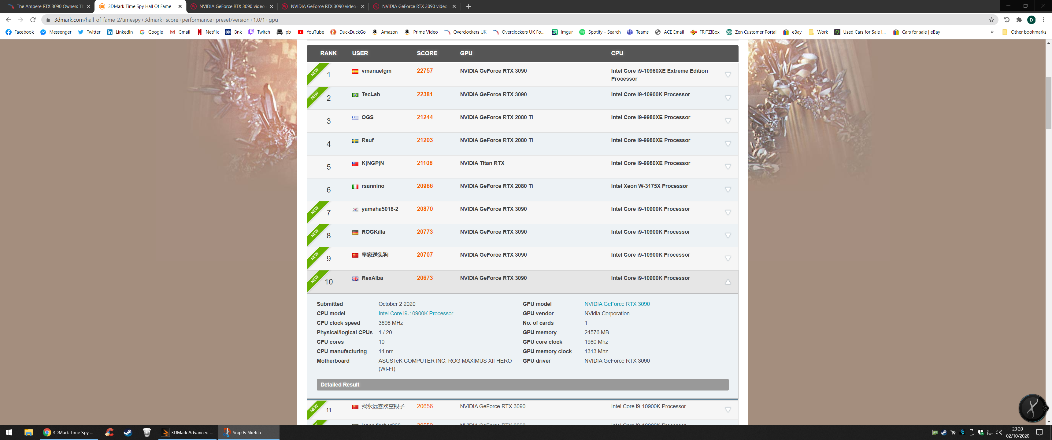

Top 10 in Timespy 0o
Seems I got lucky on the holy trinity - good clocking CPU, GPU and RAM :p
BTW Jay85 My 3200MHz Team Group clocked up to 4200MHz @ 1.5v 16,16,16, 36... wont be leaving it there just for benching.
