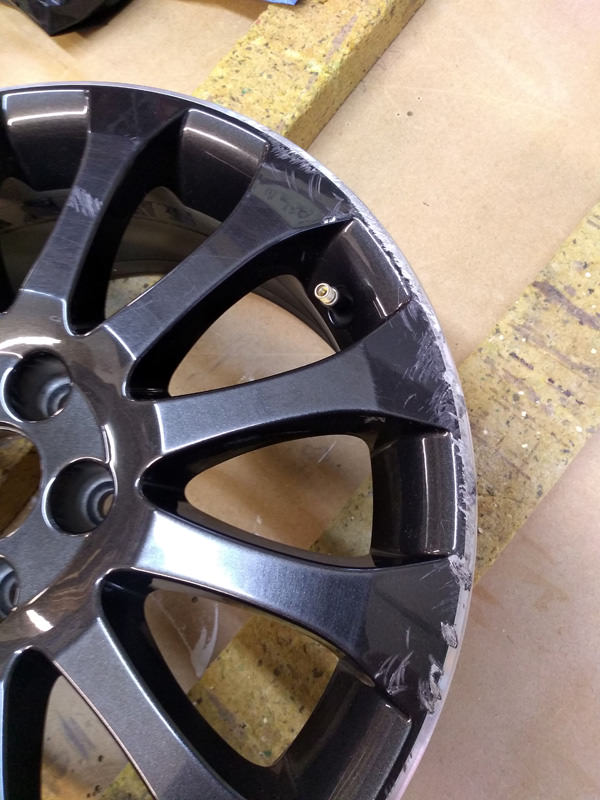

First go at refurbishing an alloy.
Picked a matching one up for cheap from ebay as it had a lot of scuffing.
Some large gouges and lots of scratches

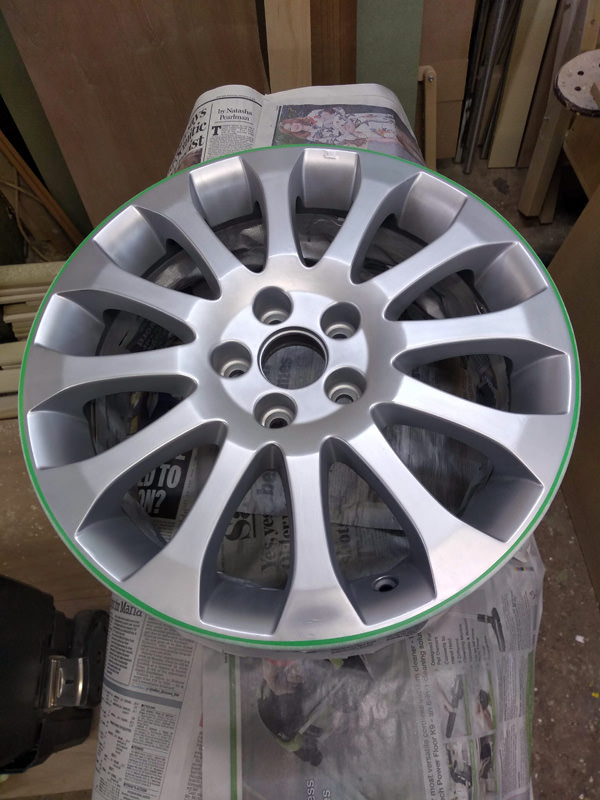

Sanded and filled the damage
then sanded again ready for primer and first colour coat.
used fine line tape to mask off the edge and then put the metallic black coat on

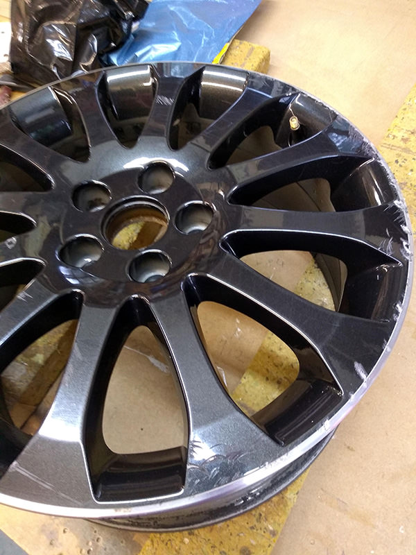

then a few coats of lacquer
and finally used a DA sander with a few sponges and compound to polish the lacquer to a high sheen
It's by no means perfect but I'm pretty chuffed with the results considering it was only rattle cans.
Totally OTT for a spare wheel too but I enjoyed the project and learnt a few things along the way.

impressive, whose primer did you use ? is it acid etch, or an epoxy primer, and (metallic) filler.
epoxy primer seems much more expensive ?
[... I have some work to do on an alloy bicycle, so had been reading up.
seems you have to do some good preparation of the alloy, special wipe (not IPA) and then apply primer quickly .... and time will tell if the layers are well adhered ]
Just used E-Tech PRO alloy wheel paints and primer.
Nothing special about application just a lot of wet sanding between coats. Applied primer leaving 20 mins between coats, the next day I applied colour coat leaving 20 mins between 3 coats and lastly on the 3rd day applied lacquer again with 20 mins between coats. I left the lacquer to harden for a week before polishing.
