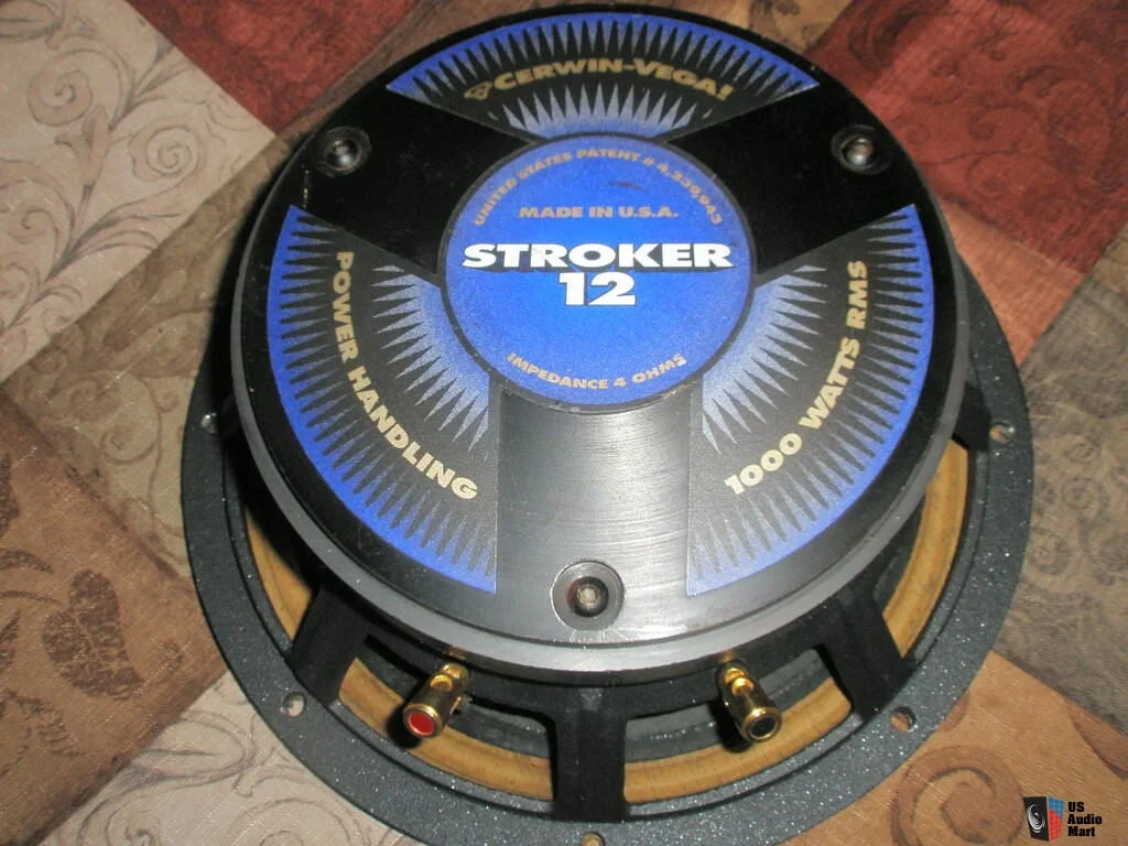

Sadly the woofer I want no longer exists. So this is where it goes into story time.
Many years ago when I was a young man (1990, I was 16) my friend's dad brought home his friend's car. It was full of audio gear. Like, for the time, insane. Four 18s. The guy was selling the car it was all in (Granada estate with a Chevy V8 in it) and wanted all the audio gear removed. In hindsight when I think about it I think he was basically doing an insurance job on it.
So yeah, I became a bass head overnight. Obviously a 16 year old me would love the sub I have now, but 52 year old me not so much. Any way, I fell in love with Cerwin Vega and over the years became very close friends with the owner of it and all of the staff out in Cali. I used to call in every couple of months and talk to one of the engineers who basically thought I was hilarious and thus used to send me stuff to make lots of noise with lol. He found it even funnier when the council turned up at my house and threatened to confiscate all my gear. I then grew up a lot, and ended up with one of these. Note just one, in 18".
It looks kind of strange. Basically in the 70s Cerwin Vega did a lot of research for their Sensurround systems. For the movie Earthquake they set one up in a cinema in Cali. The woofer is very strange in that it uses two spiders. These days lots of woofers have two (the yellow suspension thing) but not in a sandwich. They have them under the woofer. For the time it was revolutionary because it allowed the woofer to remain much more controlled and more linear (and move farther without distortion) and thus it made the woofer capable of taking much more power. Other woofers would literally tear themselves apart. As you can see it achieves this with a metal pole that comes up from the pole piece inside the magnet, and that allows you to clamp on the top spider. It also allows you to tune the woofer by moving it up and down on axis.
There was only one problem. In 1992 this woofer cost £1799 plus VAT, shipping and import duties. A lot. I mean gawd, think about how much that is in today's money. As such it became my dream to own one, and own one I did. That was where I met John Fairchild. The guy that used to encourage me to get into trouble lmao. He told me a model of woofer that was in essence the same only 8 ohms, and then he sent me the parts and cone in order to make it. IE the pole, the clamp, the top spider and cone kit. I had that thing until I moved to the USA in 2001. Obviously taking it over with me would have cost more than it was worth. I figured once I got out there I would hook up with John and get another one sorted. Sadly around that time the owner of the company, Gene Czerwinski, retired and sold the company to Stanton Group. Who just so happened to be an unfriendly bunch of swear words I can't say here. They also fired John Fairchild, so I never spoke to him again /sad face.
A few years ago a friend of a friend of his told me he had passed away. He did live to be a ripe old age but yeah, for me it was very sad. I still hear his raspy American voice calling me a crazy bar steward.
So all that said I remembered one thing John said to me. A very, very, closely kept company secret. The Stroker, whilst made in the USA, was not entirely American. In fact, the actual cone of the speaker was made by a company called Fane, who just so happen to be British. And thus I found out that a few years ago Fane had released a 50th anniversary woofer.

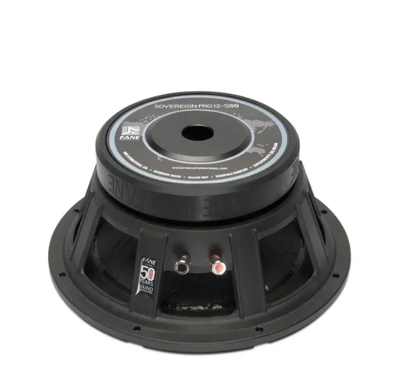

Which brought me back to something I did in the mid 90s. I converted a Fane woofer into a Stroker using parts my friend machined for me. The only thing I could not get easy access to was the top spider. See, a usual spider looks like this and is glued onto the voice coil.
Which sadly is useless. However, after many hours of searching I found exactly what I needed.

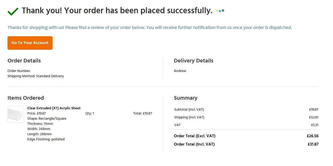

Now the reason I wanted that is so that I can put this in there instead of a wooden top panel.
Yup. That is one serious lump of acrylic :D 15mm thick, which I know from past experience is more than thick enough to handle it in a ported box. This also means I need to paint the entire inside of the cabinet to finish quality. A lot of work. However, that work will be reduced by my choice of outer finish. Given the woofer will be on full display through the top panel I got these.

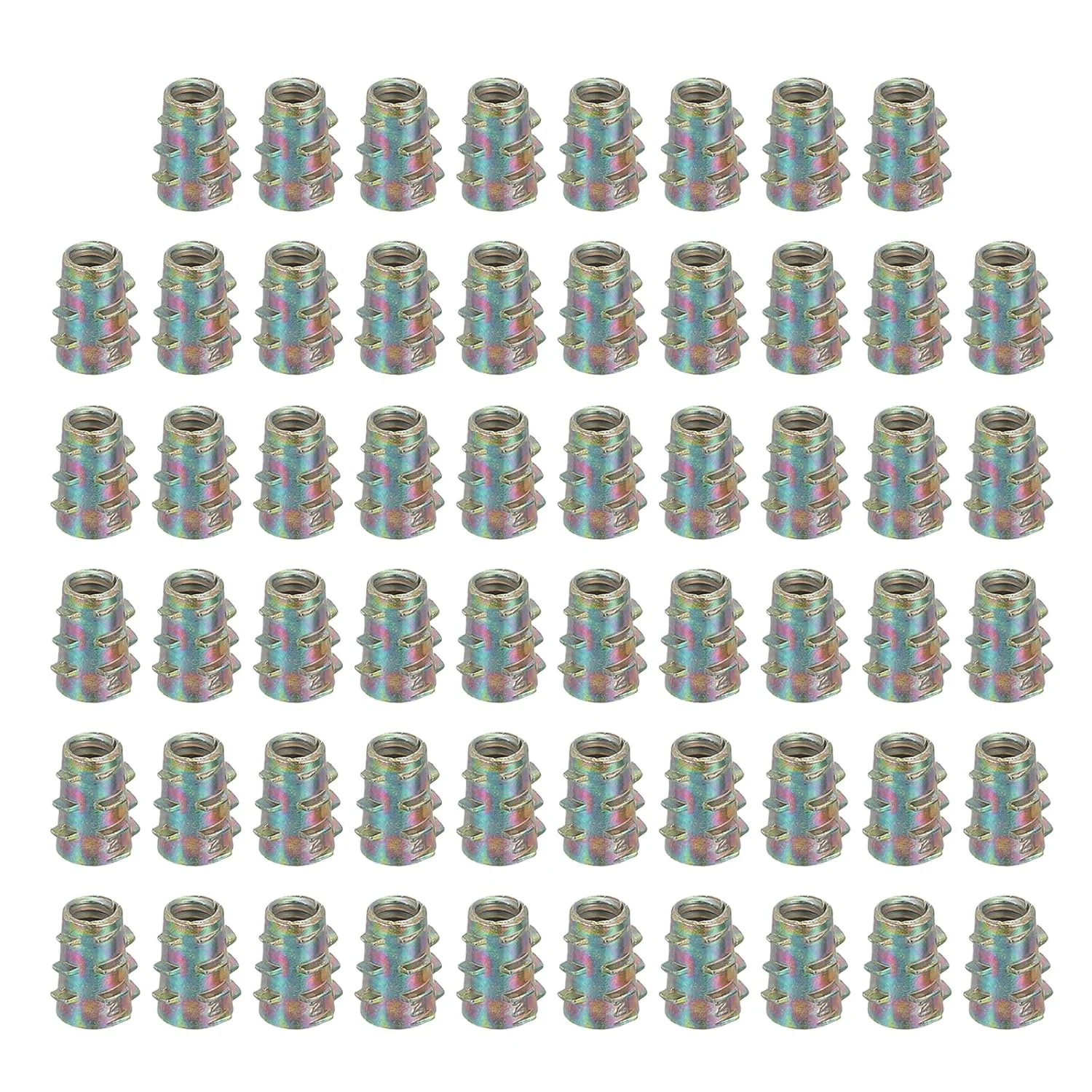

They are M4 threadserts. I also will need to use a full gasket, so I bought some silicon sheeting.

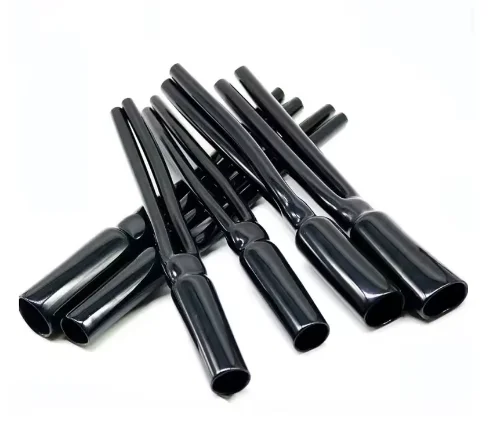

I then bought a meter of very expensive wire.

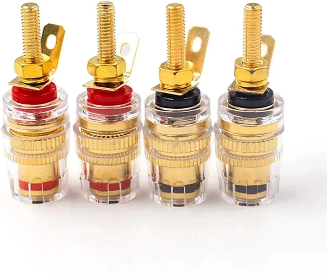

Again this will be fully visible. So I didn't want it to look bad. I remembered that on the very expensive wire kit I got for my main speakers they had these silicon end splitter things. Took me about an hour to find out what they were, but find out I did.
So that should give you an idea of the sort of detail I am going into here. For the finish? I want it to closely match my white JBL studio speakers. As such I got enough of this to do the sides and bottom.

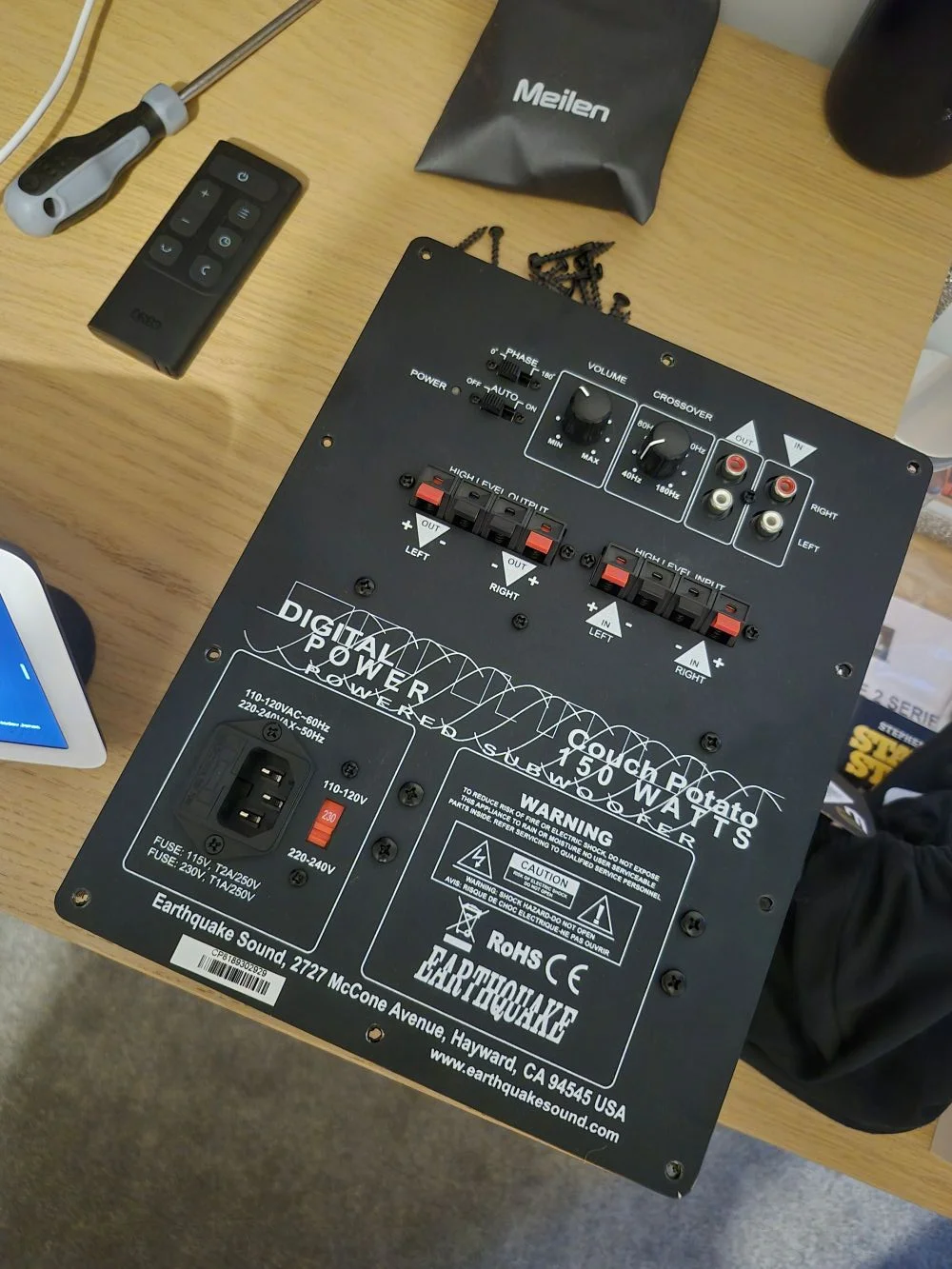

OK let's briefly cover the amp.
I had an 8" sub I started with. Didn't use it for long. I decided it was better to strip it than the current 15" sub. That way I can switch back to it if I want to. I doubt I would, but it cost far more than the Earthquake. 150w should be more than enough really, but as I said I am not opposed to buying a audiophile grade monoblock at some point. Problem then though is I would need an active crossover too. Now like I mentioned I am not cutting it into the box. And you can not run it like that as all of the electronics are hanging out of the bottom. So I got this for 20 quid.
And will just cut it into the top.

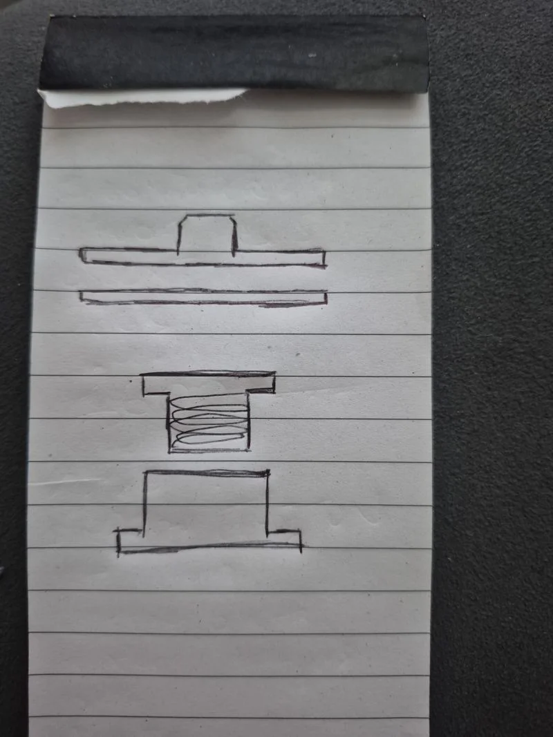

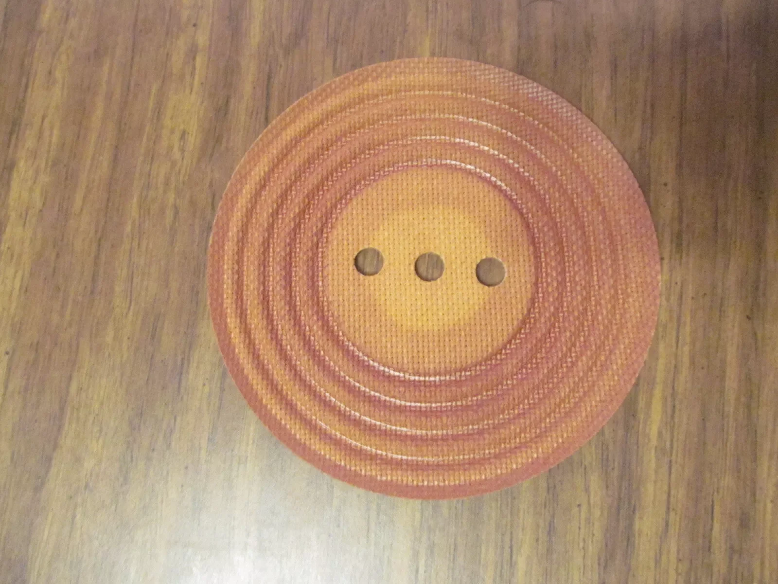

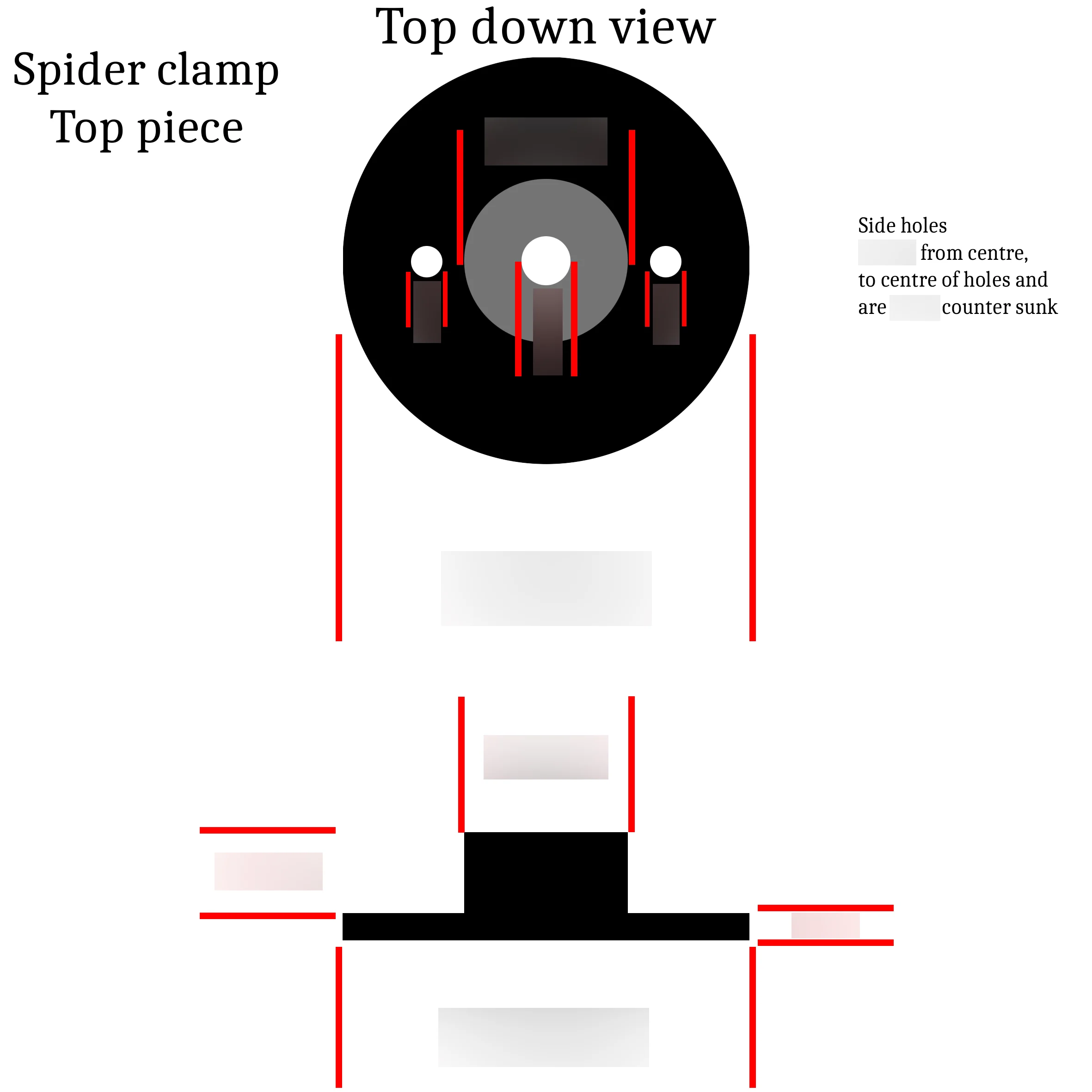

I just received noti that the sub is coming tomorrow via DPD and the spider from the USA on weds. I also forgot I drew this a few days ago when trying to explain it to my engineer friend what I wanted making.
So basically there is the top clamp made from two pieces at the top of the pic. This clamps down over the top spider. Then the thing at the bottom is an aluminium slug that clamps into the centre of the magnet. Which is then threaded and has a bar (not drawn obs) that comes up out of the speaker that the top clamp bolts to.

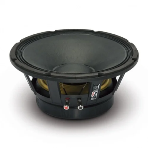

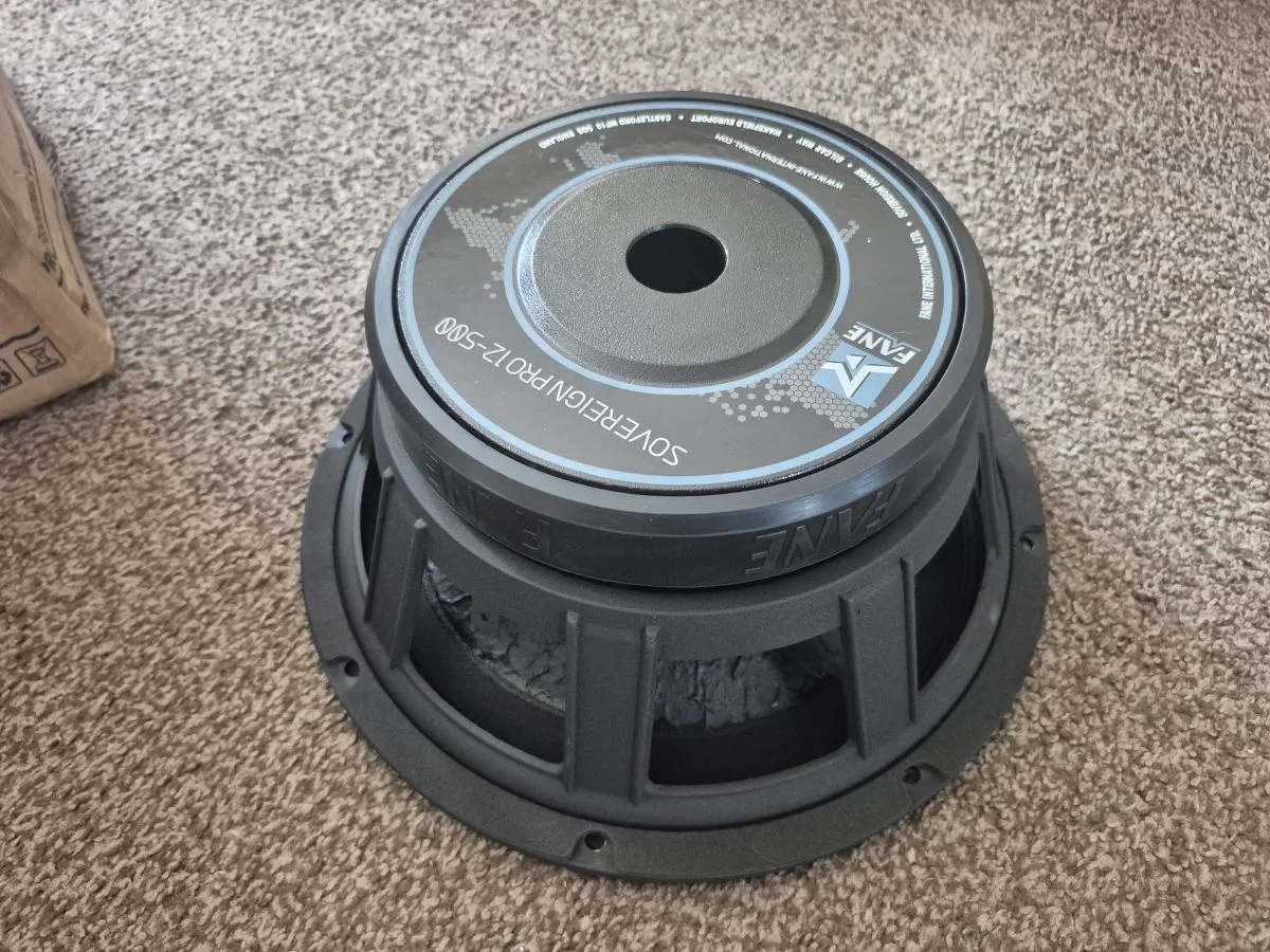

The woofer hath arriveth. And I think unit sums it up well lol.
The funny thing is the basket is almost identical to the original 12" Stroker too.
And the magnet. A whole lot arrived today. Mostly small bits I won't need until the cabinet is built. I have also ordered some surgical scalpels so I can remove the dust cap without making any mess.

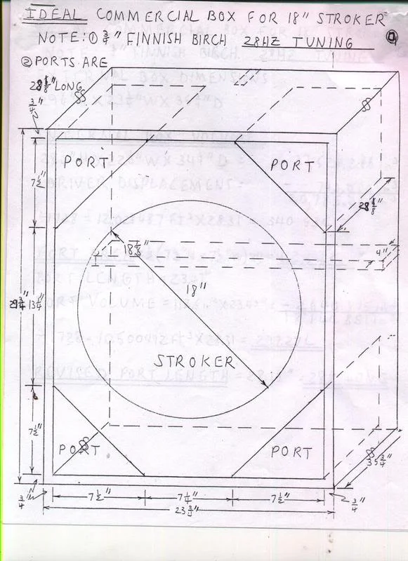

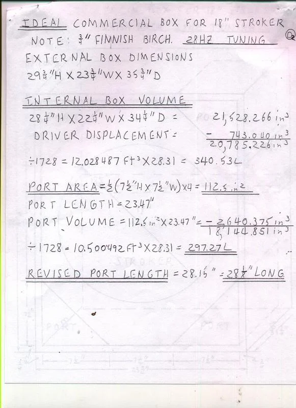

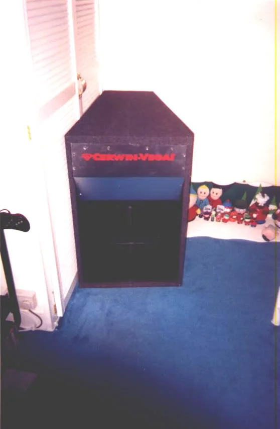

Horns are fun too. I built the best horn ever made, the Cerwin Vega Intense. Again with plans from John (he could have gotten fired over that). My Stroker 18 went in there before I sold it in 1999 to move to the USA.
This is what I had it in tuned to 28hz. That was what got the council outside with mics on tripods. And then lots of legal threats. So like now I put it in a horn which goes deep, but is also far more accurate and plays better at lower volumes.
Yes, a monster.
That is John's handwriting BTW. He drew those plans up in the 70s when they invented the Stroker for Sensurround.

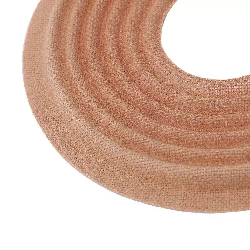

The gold wrap just arrived and loads of other bits are coming today. The 15mm perspex has shipped too.

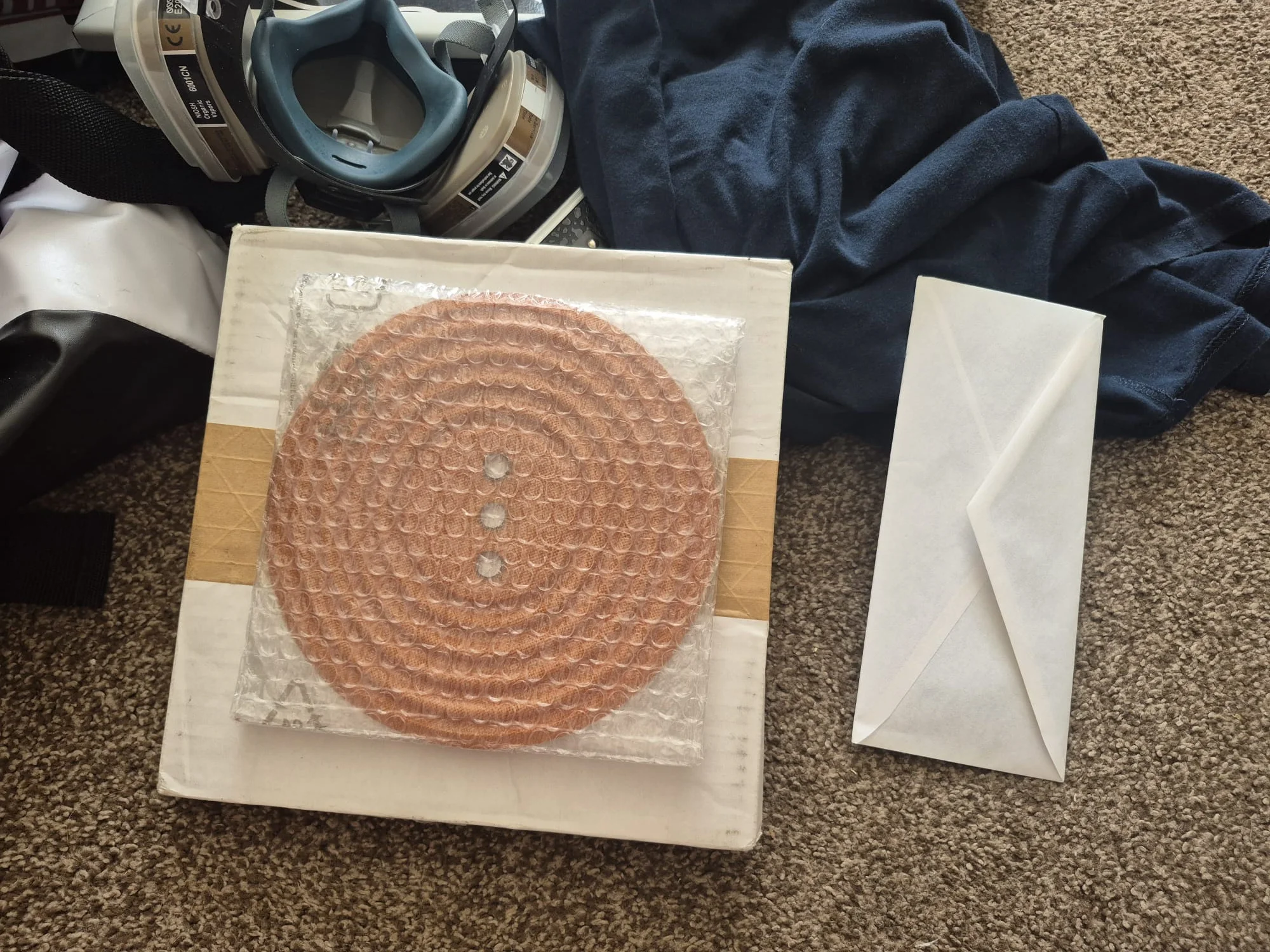

Best part is coming today also, the top spider. I can really get into the design stuff then.

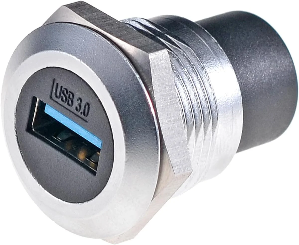

Obs it dawned on me I need to get USB into the cabinet for the lights. I ordered a few A to A cables ages ago without realising they weren't what I needed so I have those already.
OK so how to make the inside look super clean? these.

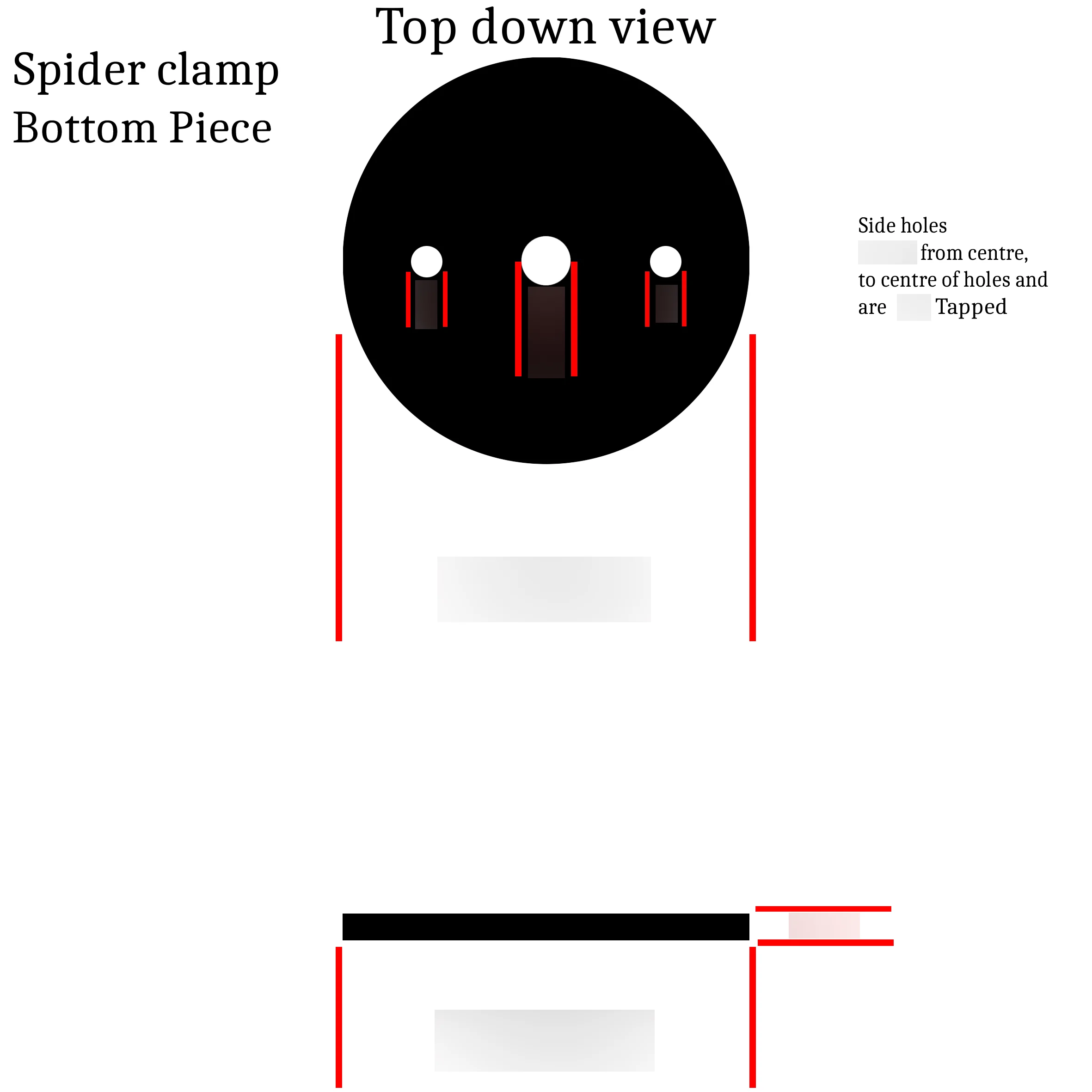

OK so with the spider here I can start designing the clamp that holds it. Sadly I am going to have to blur out all dimensions because it dawned on me earlier that the reason no one has copied the design is 'cause it's patented lol. So I want to play it safe. I will post pics of that in the next update.

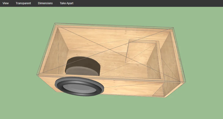

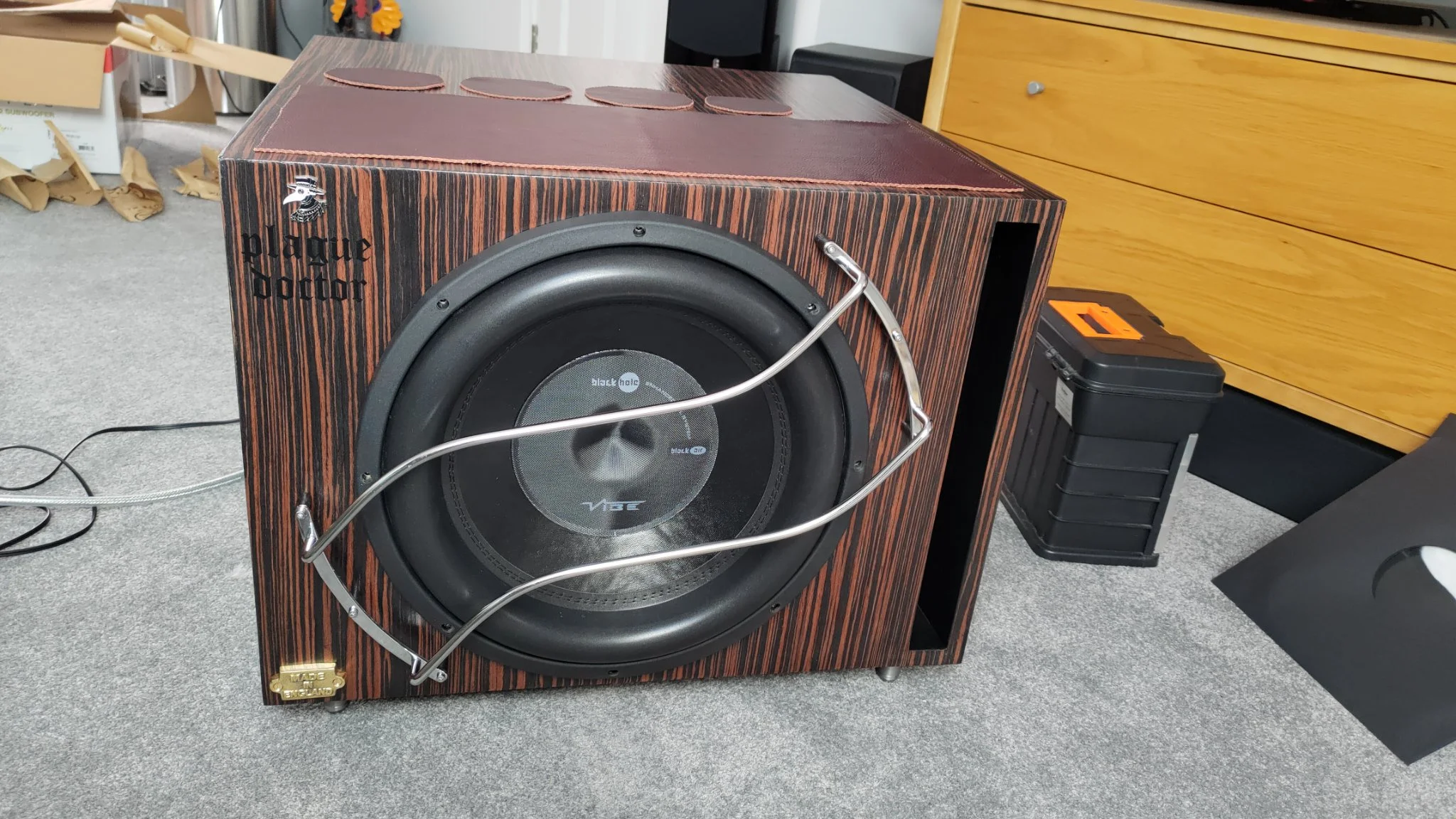

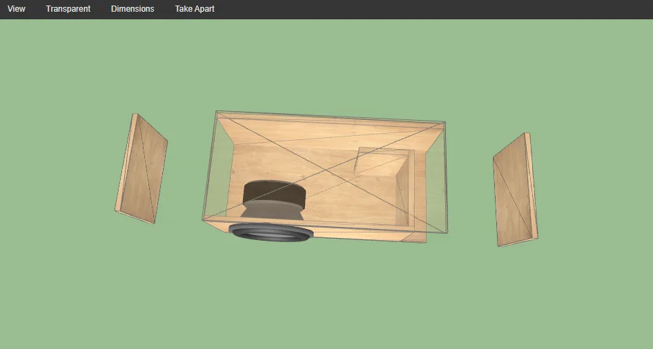

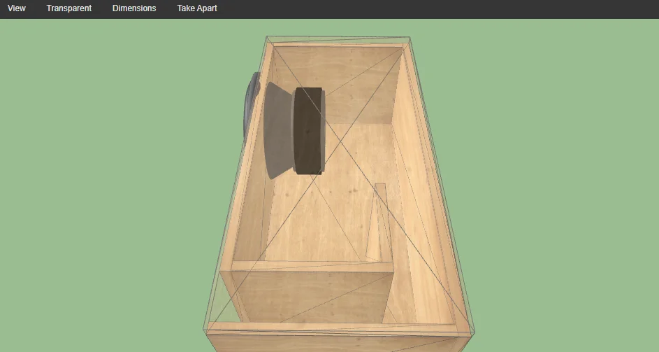

I found a box on here.
And then tweaked it. Firstly because it was not big enough to house the woofer properly, but secondly because I am adding stuff inside that will remove from the internal volume. So I've added it back :)
