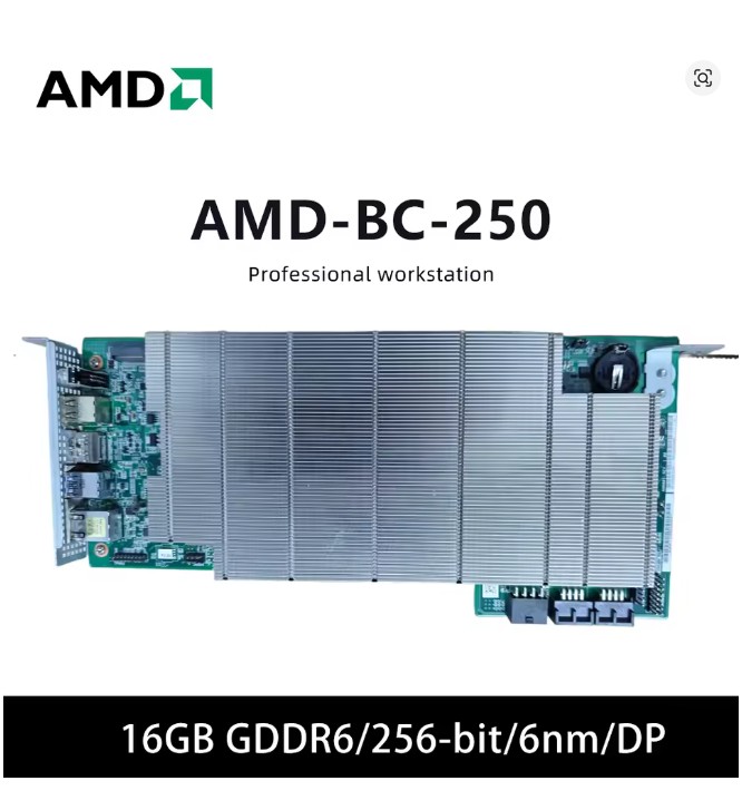

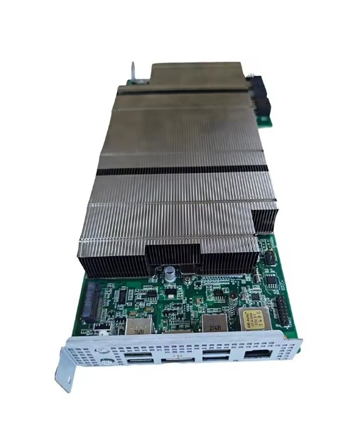

However, yesterday he posted what is, IMO, his most interesting video yet. Basically he got hold of a back plane that was built for mining that contains a Ryzen APU (most specifically the one from the PS5) as well as 16gb memory and etc. IE, a whole PC on a back plane. This.
It is dual slot and about the size of a GPU. Yet, it is an entire computer on a single board. Couple more pics.

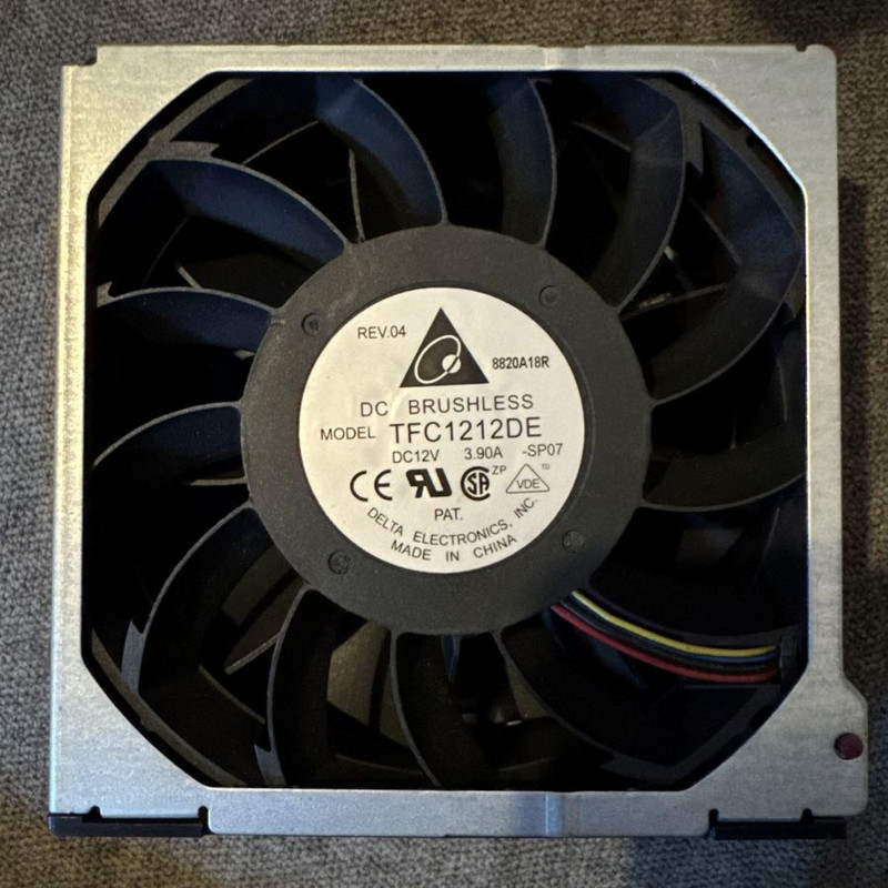

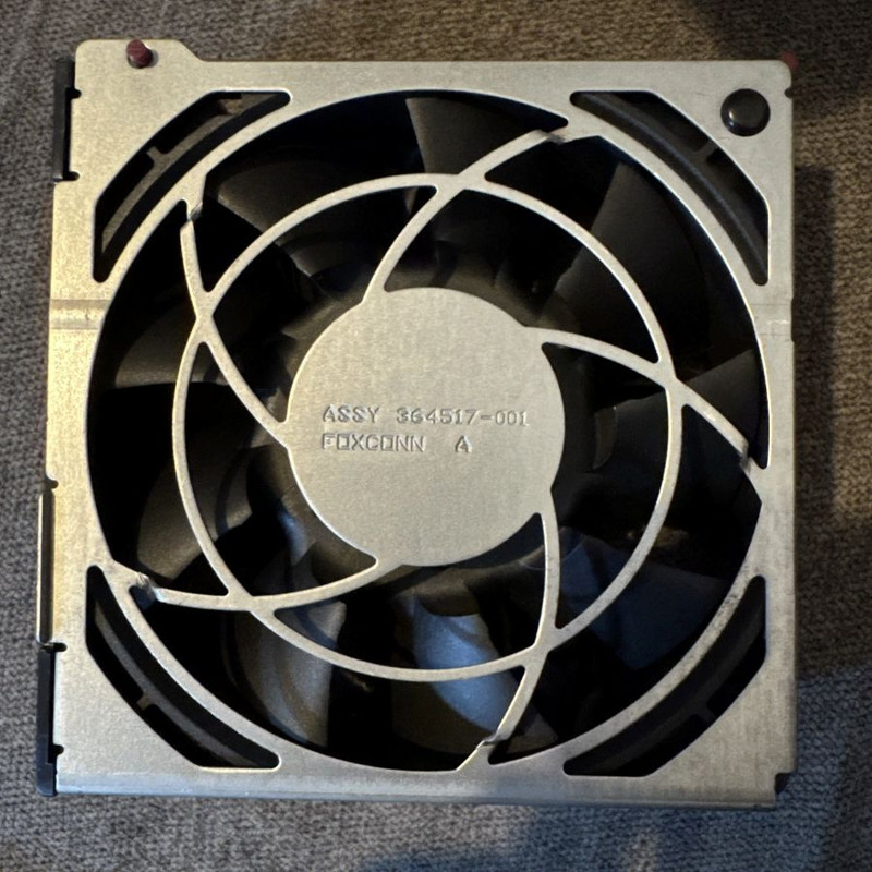

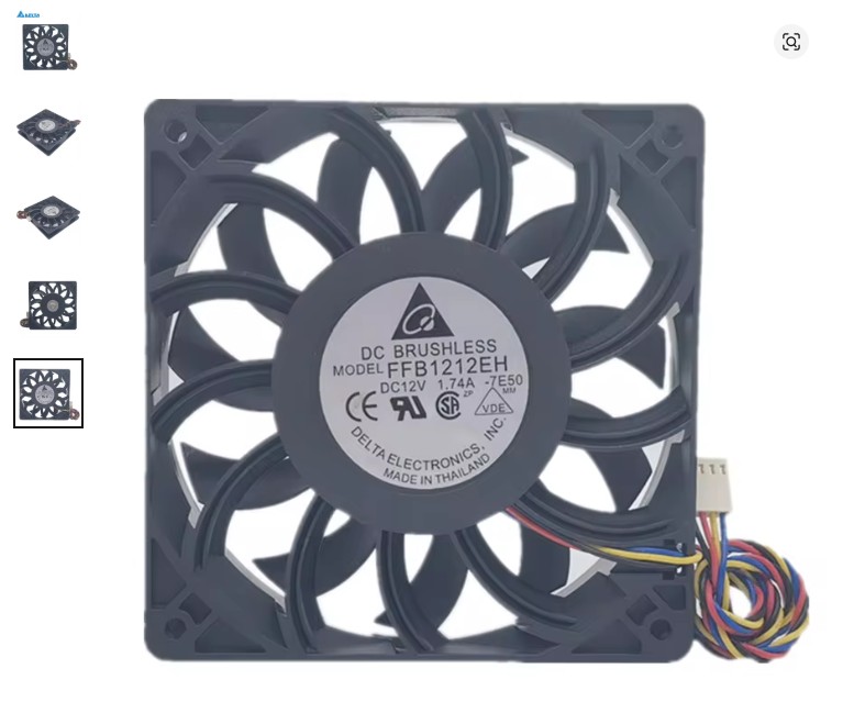

Now these are known for being noisy. However, I have two options. First one is to put a Noctua fan in it. Which will make it silent. The second option? remove the fan completely. This may sound sketchy, but the design of the unit will be such that it will get tons of air shoved through its bottom just like the plane. How? Well, imagine a PC with a front panel that is, IDK, 130mm x 130mm square. With a nice powerful fan in it. Then imagine the PC being the depth of the back plane so you can connect things to it. This design is also known as the wind tunnel. Which, amazingly, is how the server it once lived in would operate. Hamish stuck a fan to the top of it, but that is not how you would go about cooling it.

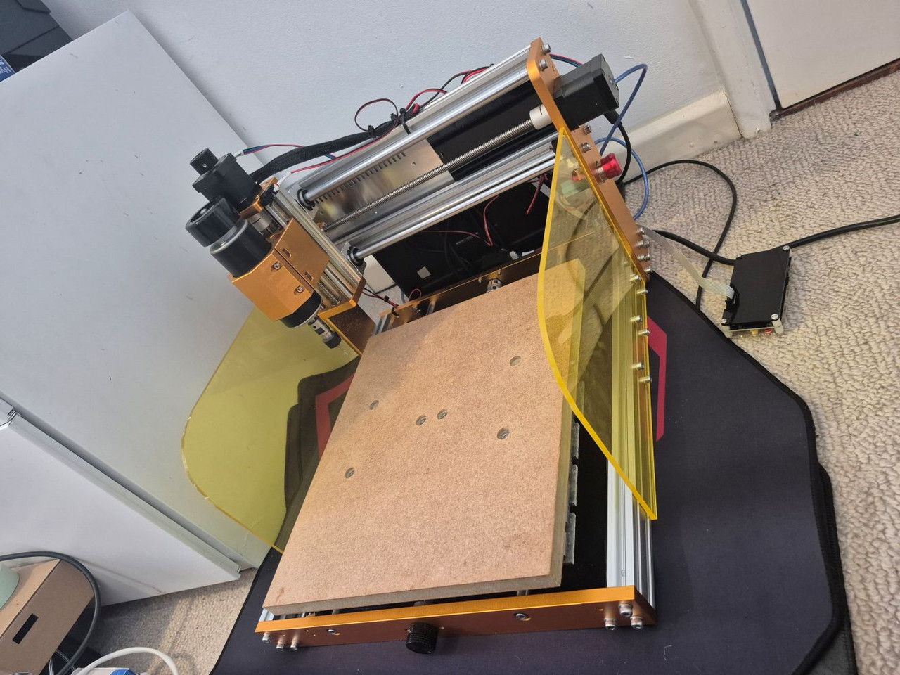

Machine the entire machine from 5mm acrylic, in the Vault Tec colours. Only unlike Modular I will not be relying on these pieces of acrylic to be straight. That was where I went wrong last time. This time around not only will I machine out any vents, details and logos myself but I will also cut the entire panels at the same time using the machine so I know they are all perfectly straight.
The cool part of this all is that it should cost less than 200 quid all done and running. I have been waiting for a project idea for my new CNC since I got it. So far it has machined out a few parts but nothing on this scale.

OK so that is the cooling sorted. I ordered this. Cost me 11 quid. New, too.
At the amperage it should be easy to run on pretty much any fan controller.

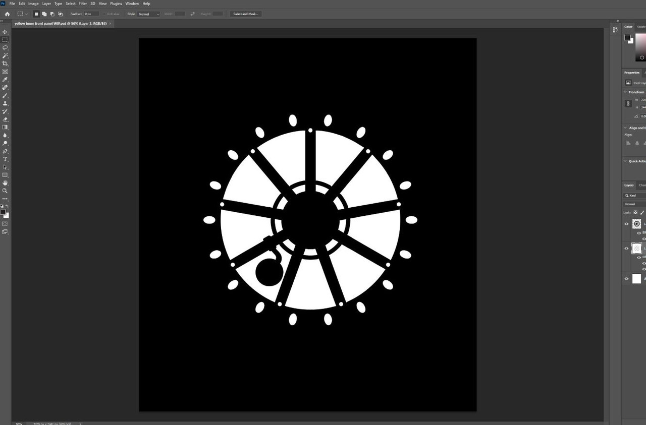

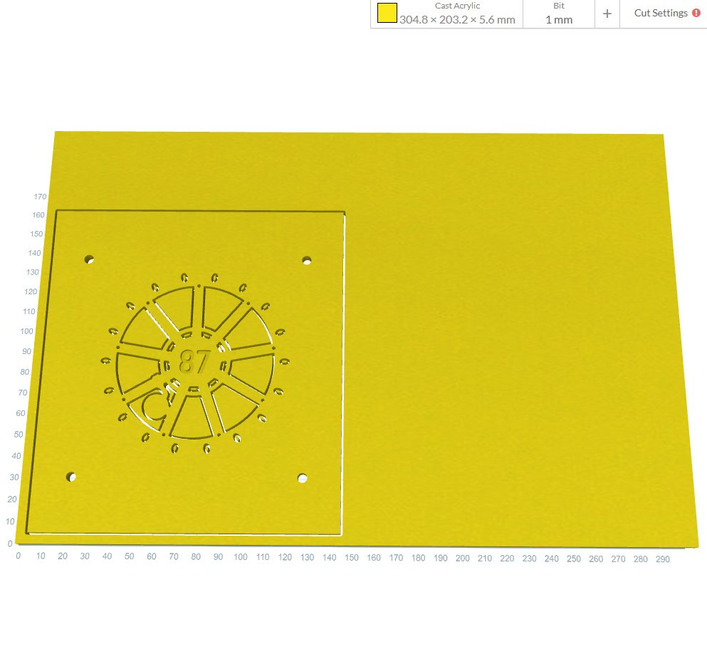

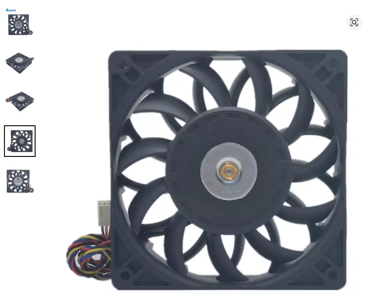

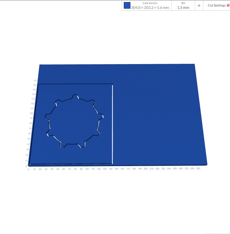

OK guys, so here is where I am at. I am unsure of the depth needed yet. I may as well wait until it arrives. However, I looked up the data sheet for the Delta fan, and came up with these. I also figured out how I want to hold it all together. I want to use M4 bolts, tapped into the plastic. However, for that you need some thick plastic. As such I decided the front and back will be doubled up 5mm acrylic, plastic welded, giving me 10mm to tap into. I should have done this with Modular, but figured I could glue it. Nightmare that was !

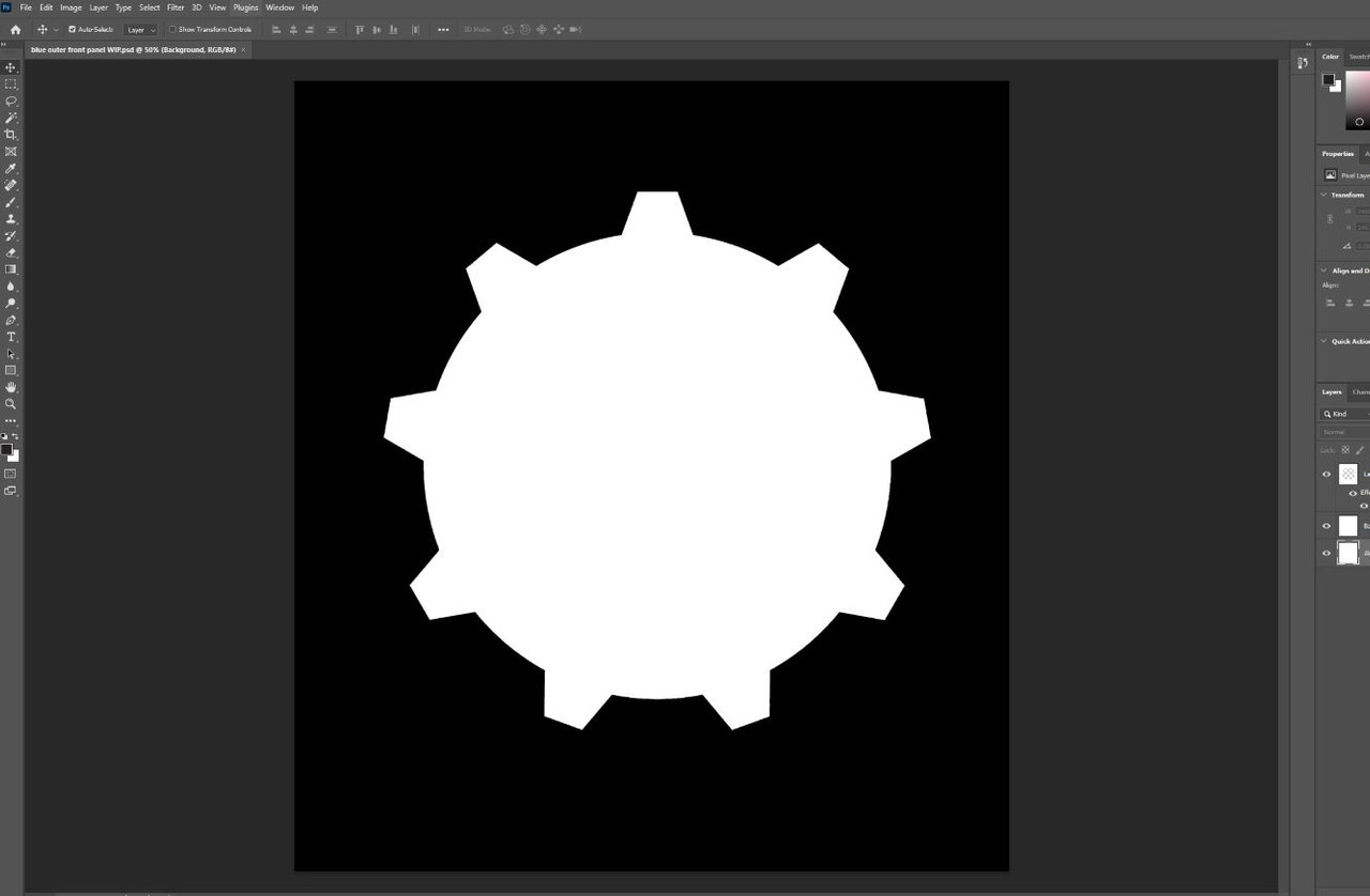

So this one will be the outer panel. It will be blue. I will put these into the CNC software soon and post some images of what it should look like as a piece. However, for right now just use your imagination.

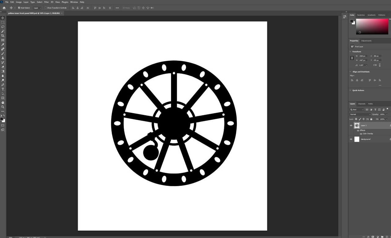

That part was reasonably easy tbh. Just find an image, trace it as a vector, put it back as a EPS so I can work on it in Photoshop and yeah. 10 min jobber. This one on the other hand started out life looking nothing like this. Had I ran the machine it would have fallen to bits. As such I had to basically draw in a load of pieces to attach it making it one solid piece.
And then I could fill it in.

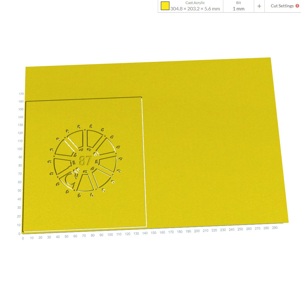

So imagine that the first pic will be a piece of 5mm blue. The piece above in the last pic will be in yellow, and will be plastic welded directly below the blue layer.
Don't worry, I will be putting a vault door number in the middle (87...) but that will come later, as anything in the image right now will machine all the way through. Again this would cause the number to basically fall out (pardon the pun !) so I need it as a separate object I can engrave in, rather than cutting out.

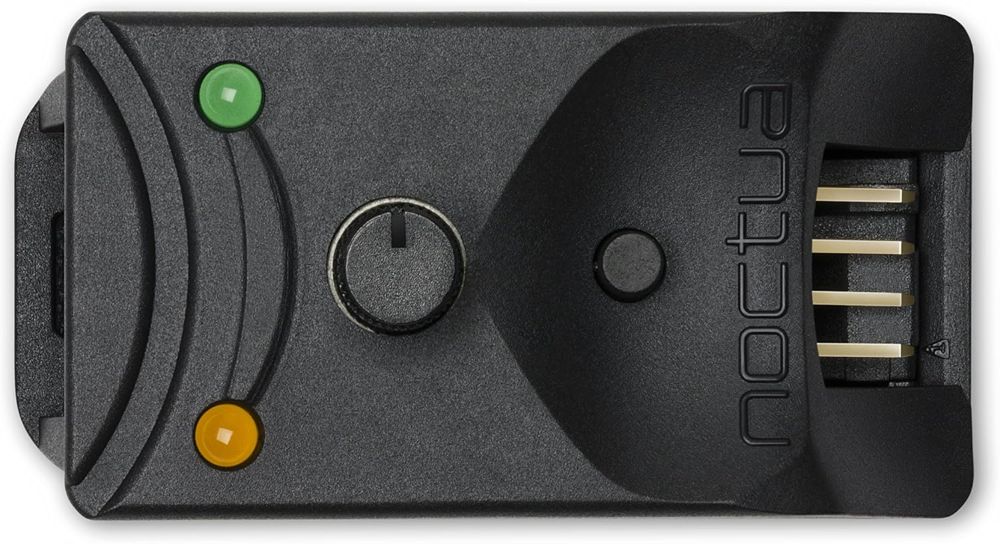

I have also been looking into ways to tame that beast of a fan. I found this. It is 3a capable, so more than enough to run the one single fan.
I can then manually set it. I also just ordered one of these. Again, this will be part of the wind tunnel. Overkill absolutely but it was cheap (11 quid) and will work very well.

Now you may be wondering what the heck that has to do with anything. Well usually I use a special (and expensive) double sided masking tape called Kipp. It's awesome. However, I usually use old brown card envelopes from that place on the internet you buy crap from. Problem is they can be uneven etc. So I finally decided to buy something suited.
Basically it should be about a mil thick. You double side it down to the bed, and then double side the top to hold down the acrylic. It gives you some breathing space when you go through the acylic without dragging the bit through the spoil board. Which would, over time, reduce the ability to stick things down fully as you would have air channels.
Having looked at the yellow piece.... I was a bit concerned about the air flow. So, I changed it around a bit adding more holes.
Better.

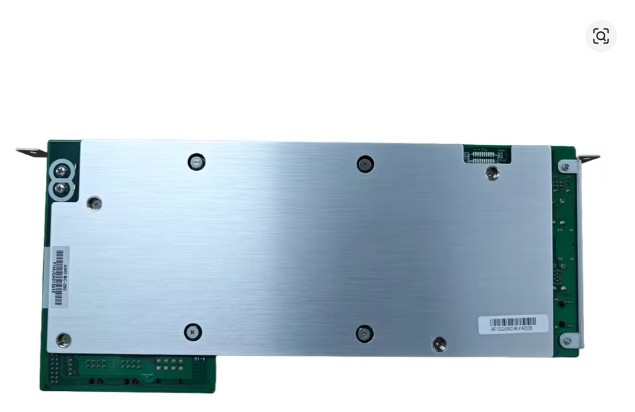

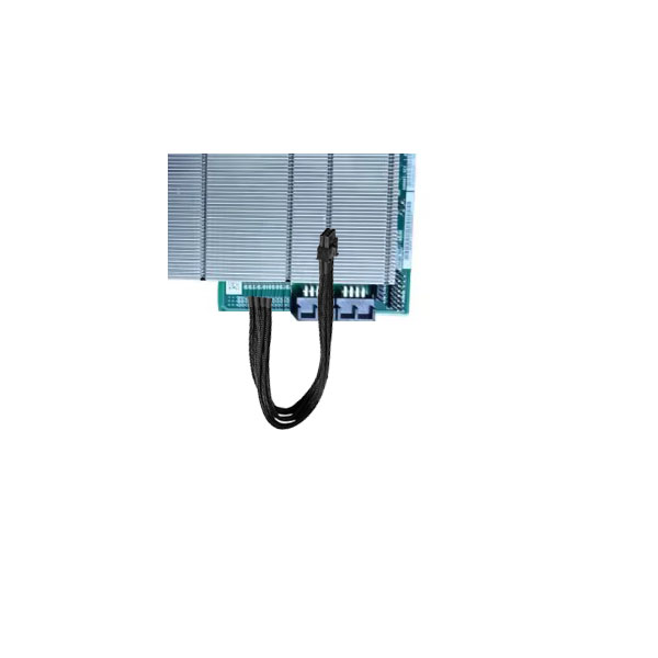

Any way Ive been doing more nerding and etc. Im going to fit a heatsink to the back plate where the GDDR lives. Im also going to remove the 8 pin connector and solder the wires on a pigtail. Otherwise it needs to be 20mm larger inside and then treads into heffa territory.

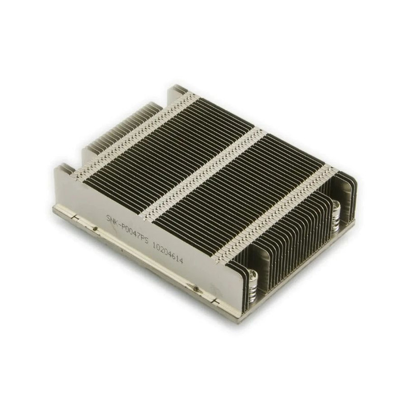

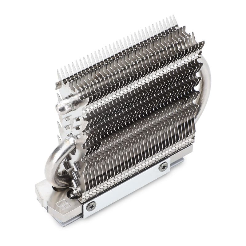

OK so I bought one of these.
It is a 2011 Supermicro cooler. I am going to remove the bolts and their C clip things and just thermal epoxy it to the back plate right behind the memory chips. I could have gotten a larger one for a bit more, but the fins were the wrong way around to allow air to pass through.

I am going to remove the PCIe connector from the modular cable that comes with the PSU.
See dude? the one next to the 24 pin. I am then going to solder the wires into the board after removing the 8 pin socket so they come out of it sideways. Otherwise? the socket with a plug in it will add 20mm to the height of the computer case. I don't want that. As such the plane board will have a pig tail hanging from it that plugs into the PSU directly. I will be making up my own wires for that in blue and yellow.
