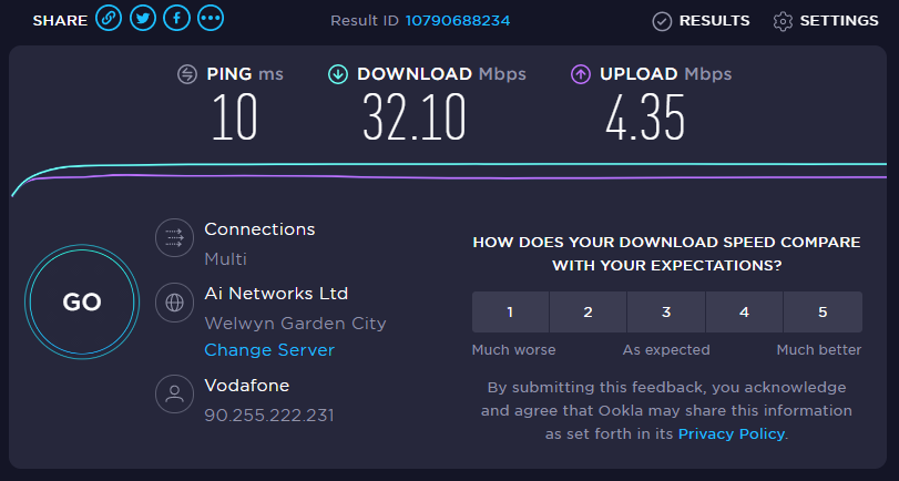

Background: My house has a BT Openreach FTTC connection, and that's it. No Virgin media, no FTTP. Current sync rate on the Vodafone FTTC is 32mbps, but I've had a struggle getting that. Over the past 2 years the line from house to telegraph pole has been replaced along with the master socket, and a fault at the exchange fixed. At times it's been under 20mbps.
Virgin Media did a big expansion to within a few hundred metres from me, but stopped there, and with no sign of them coming to my street any time soon, I started looking at options.

Quick update. With much better weather, and some fine tuning of the location (I actually carted the thing all over the house before finding the original location was almost perfect), which turned out to be around 2-3ft away from the first spot, I'm now seeing 160-180mbps down, occasionally 200mbps, and 10-15mbps up.
Bear in mind this is my FTTC connection:
Last week I downloaded COD Zombies which was 58GB on the PS5. The estimated time to download was 8-9 hours.
I've just set off Doom Eternal which is 63GB and it's sating around 50 minutes. I'm flabbergasted. I timed it taking 45 seconds to download 1GB of data.
