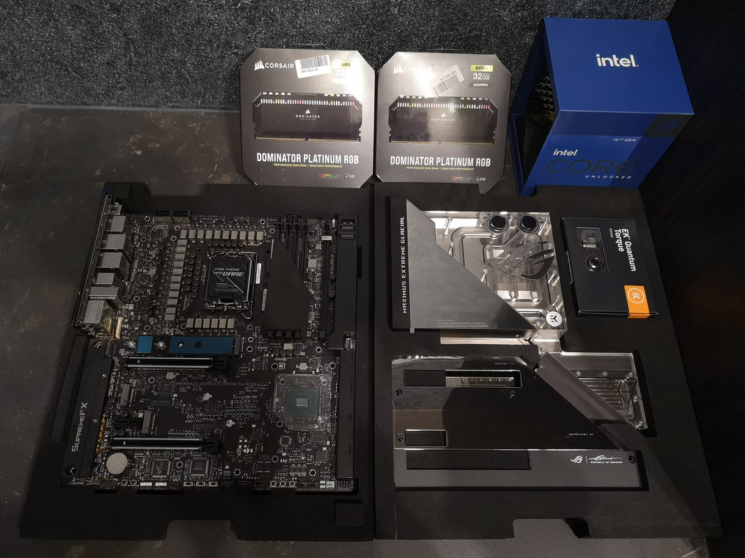

Well today it turned up.
What an absolute monster.
This feels weird and wrong, 2 of the m.2 drives (2tb SN850) have to be placed face down, so any cooling is only on the back of the drives
Aha, so a bit later on in the instructions you actually remove these 2 bottom NVME drives, put the monoblick under them and then a second plate on the back, ok :)
You do know that top M.2 slot shares PCI lanes, so the bottom x16 PCIe will be disabled and the top one will run at x8?
Just closed my eyes and entered the credit card information while sobbing quietly.
Oh, this the one at £1,669? Still a lovely looking board. I assume the processor cools a lot better with a monoblock since it has a much larger surface area even with the VRMs to cool... Instead of the processor block standalone.
Good point, but from the benchies ive seen the difference is going to be imperceptible.

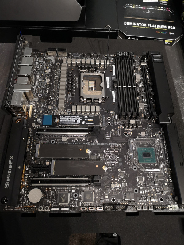

However, bigger issue, cpu code 00 :(
Could have a dead cpu, that would suck.
Ahhh man :(
Reseat it, and remove the BIOS battery for a bit and try again.
Re-seating no dice, 1 stick of mem no dice, all nvmes removed no dice, diff stick of ram, no dice. Battery remove, cmos clears no luck.
Thought id try one last thing, change the battery out.
We have life :)
We have life
Funny how the simplest of things can be a real pain. Imagine you never had a replacement cr2032.
