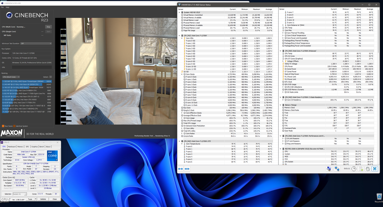

Defaults usually mean adaptive vcore. Have you not tried an offset..? Something like 0.070v as a minus value..?
If I ran my 12700k at default it would throttle in Cinebench R23. By adding an offset value, checking for stability, it will reduce the vcore enough to reduce those temps without throttling. Take a look at my 12700k at 5.1Ghz P Cores and 4Ghz E Cores....
That has a 0.060v as an offset. It uses 1.275v when under 100% load for the vcore.
Thought I'd settled for an all core overclock of 5.1 and 4.0 on the E Cores, adaptive voltage, 1.280 under load.
.decided to see how far it would go on 1.300.

With my MSI BIOS, guessing the same, you would want adaptive+offset.
That way the adaptive voltage still changes with the processor speed range but you are introducing an offset to those values.
The - 0.070v is a guestimate that you'll need to fine tune on how stable / cool it is.

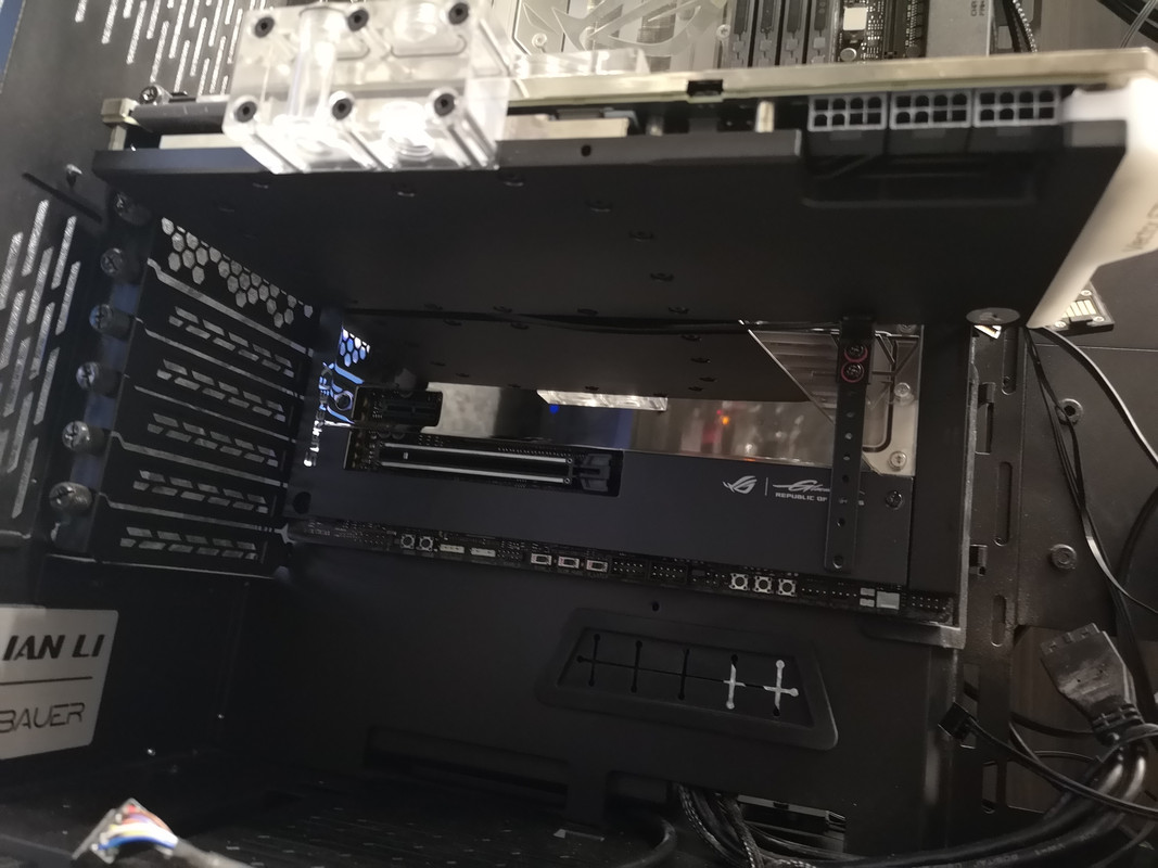

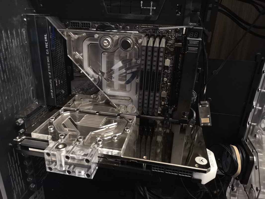

Graphics card in, 3090 FTW3 with black acetal bottom side (to match the black at the bottom of the mobo) and nickel to match the top of the mobo for an active backplate.
That boards a proper work of art, I have mine on the test bench at the moment and if all goes well ill install it tomorrow.
BIOS installed, nothing of note so far but I simply restored the saved settings lol so not flicked to XMP and still using manually set RAM settings. If it still doesn't work I cba with opening the case up to clear CMOS.
