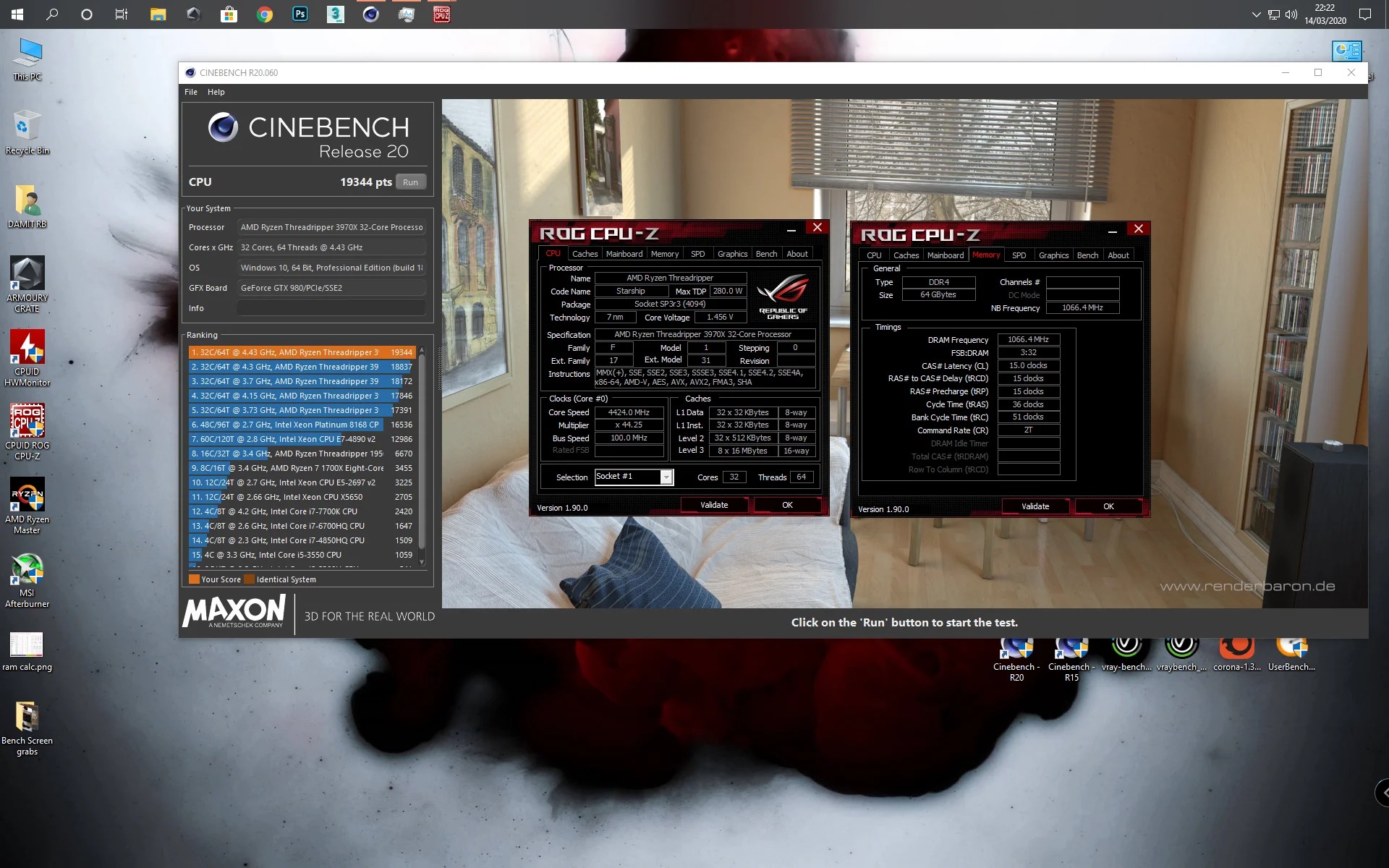

Hi all, Just completed building my new PC a couple of days ago https://forums.overclockers.co.uk/threads/the-render-box.18880098/ currently in the process of testing out its capabilities.
This is my first go at overclocking on AMD. Up till this year I've always been an Intel fanboy... so I'm sure I've still got a lot learn. Managed to get it up to 4.425GHz all core but its not the stabalist when running Cinebench at this speed.
Here's my result so far.

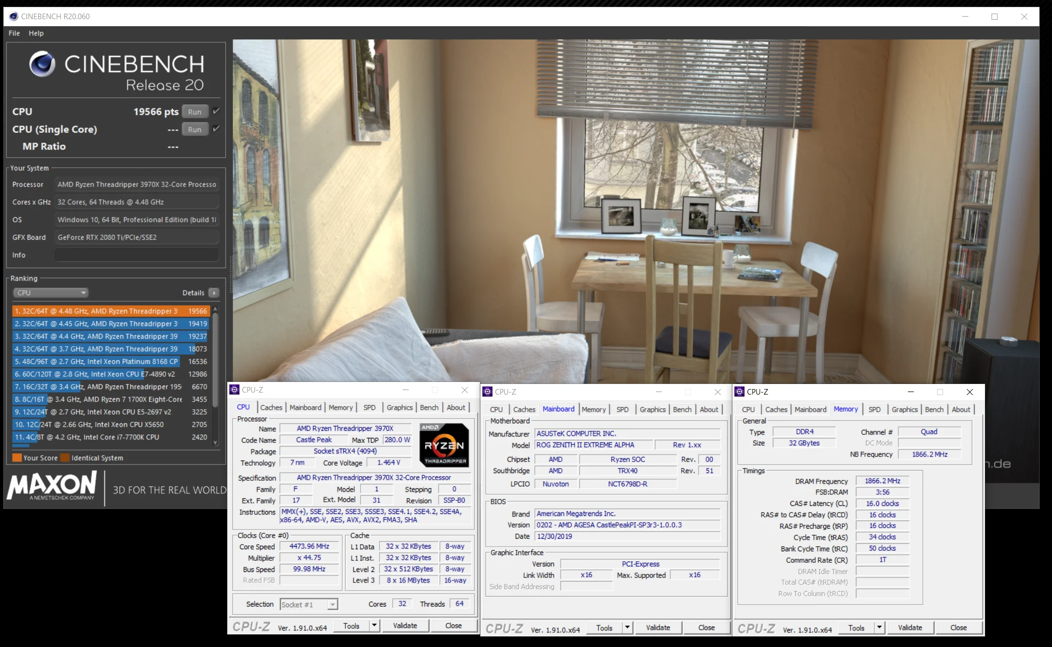

@NoPost Well I gave it a go at 4.5 but I just couldn't get CB stable enough to get it to complete its render. Looks like your safe with your top place for 3970x..... for now ;)
I may give it another go when I get to grips with ryzen a bit more but I'm sure that wont be for a while.
on the plus side though I was able to find a good stable 24/7 speed/voltage/temp setting through doing all this. 4.3 @ 1.275 and sub 70c is good enough for me.
and for anybody wondering, Cinebench or any other cpu based 3d renderer that I know of at least doesn't really care about ram speeds... even on ryzen. RAM is basically just used for storing the assets in the scene eg. textures/meshes etc.
