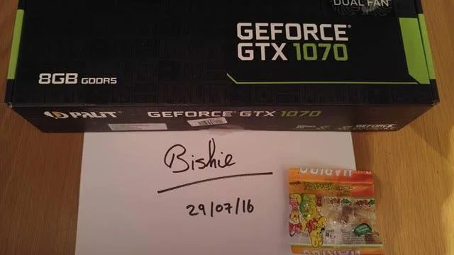

Welcome and on TROH.:)
The Roll of Honour.
Date 29/07/2016, Make Palit Dual Fan, heatonpkmassive, Link

To get on the Roll of Honour all you have to do is post a pic with your user name on it of your GTX 1070.​
