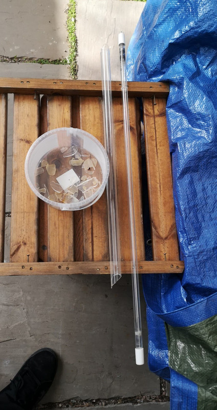

I'm eyeing up a 40W amalgam bulb that I would fit into a separate removable airlift in the anoxic filter. That would allow me to kill off blooms at a higher flow rate. In fact I could put the UV in a replacement tank for the bio at a later date and the entire flow rate would get UV'd. In the past I've not had a problem with blooms once the pond was matured.
Just be aware that amalgams are corrosive to most pond plastics as they run at a slightly different wavelength. The best way to really make them work well is to get a stainless tube to hold them in that the water passes through, it effectively doubles it up to an 80 watt unit from the reflection.
yup UV degrades plasic, even those such as UPVC with UV stabilising additives. I was thinking of having the amalgam in a separate tube to the main airlifts. Others have used them in the drum but the seals perish.
