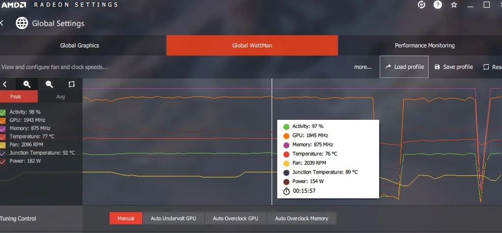

How are you guys getting on undervolting your 5700 XTs? I've been able to reduce mine down to 1060mV at the stock max-clock of 2059MHz and 786mV @ 1429MHz without any artifacting. Can't really say if it's drastically reduced temps but I've also already done the GamersNexus washer & paste mod.
Card now gets up to 78℃ "temperature" and 95℃ "Junction Temperature", hovering at about 1700MHz

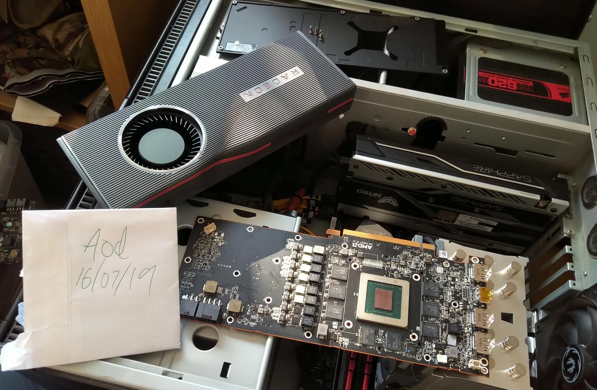

Oh, and here's it getting a little naked time while I was doing the GN mod:

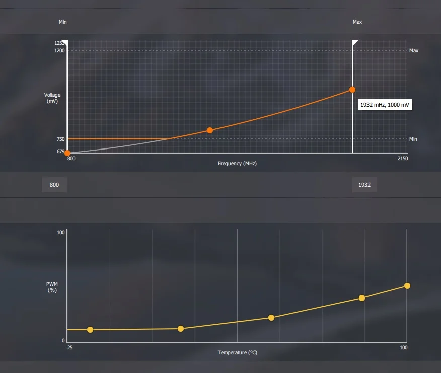

I have an undervolt that matches my stock timespy & firetsrike graphics scores:
power limit +10%
Results after about 20 mins of Metro without any crashing:
So heading in the right direction!

Nice work Doc, good results. :)
Bit confused though you say 2063Mhz but your WattMan shows 1932Mhz and the histogram shows a peak core clock of 1943Mhz.
Ah yeah what I meant is that I tried 2060/1100 last night & that worked okay in-game.
So this morning I tried a different undervolt - 1932/1000 & thats the one in the pics :)
