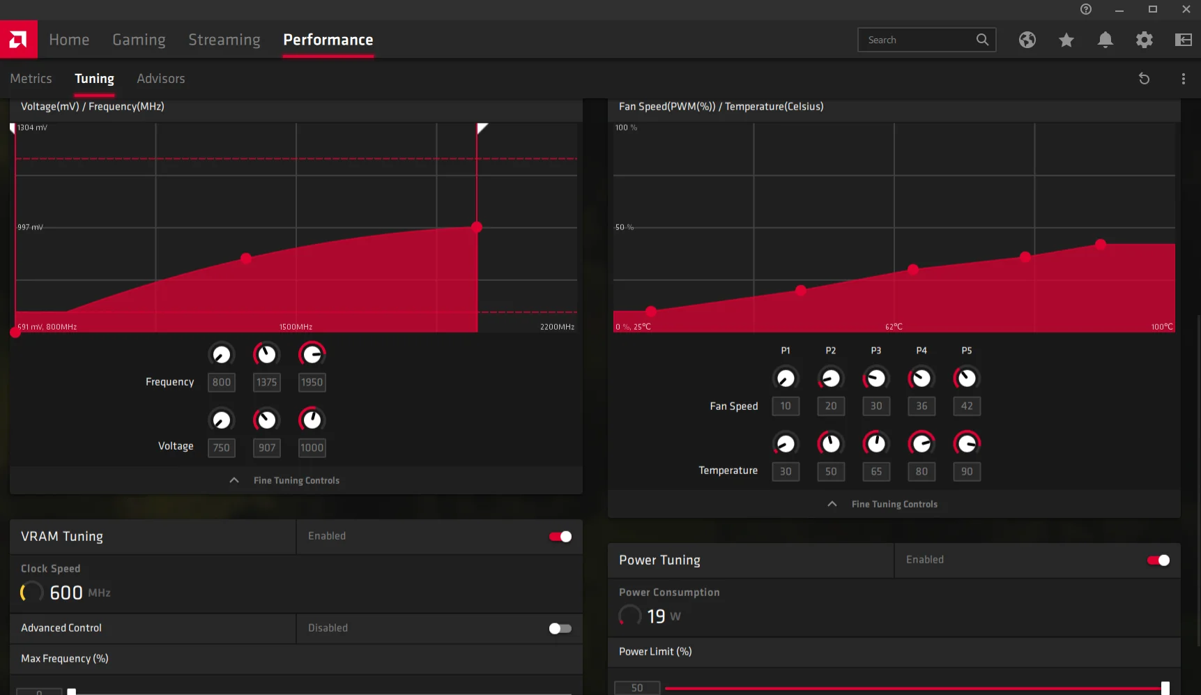

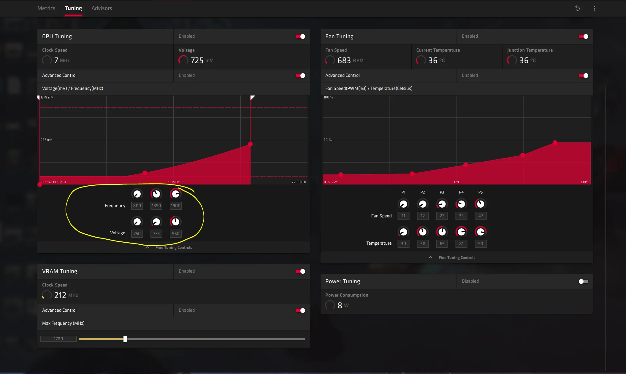

Use the Advanced toggles and you can manually enter values, simples.But what does all that mean?? I'm used to a simple clock and memory slider ha!!
Been lazy and used to MIS afterburner, what does mV have in relation to MHz? and why the graph? I understand the need for a fan curve but I have no idea what the toggles do? I see GPU Power is in W so to me its a bit confusing no?
1850 VRAM on 5700XT?
mV refers to voltage, which you can enter in the values shown on your screenshot.
If you click the chevron where it says fine tuning controls you can control fan speed. by setting values at a given temperature.
