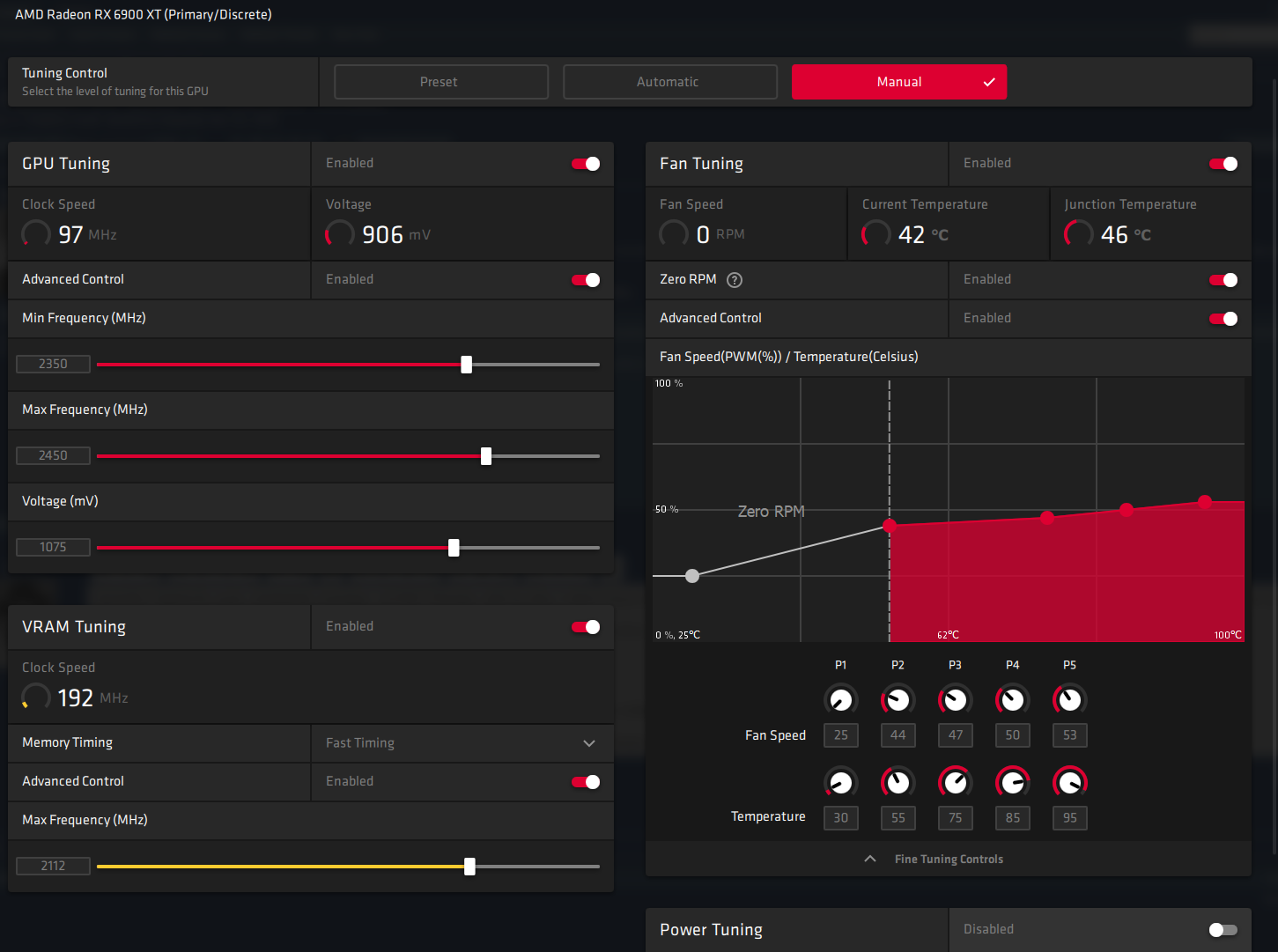

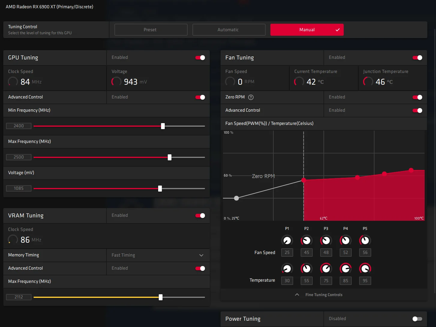

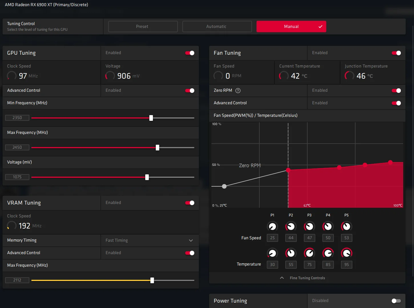

As i said, just just use MPT to adjust power limits and max soc voltage to 0.912v. Leave voltage changes to Radeon Software.
I am attaching two of my personal tuned 6900 XT profiles you can try. Be interested to know if they work with your sample, just download them and load them into GPU Tuning. MPT was set to 325W, TDC 360A, Max SOC at 0.912v so you want to use these values for now.
Profile 1 - 2375Mhz / 2112Mhz @ 1.050v Silent Profile
Download - https://www.sendspace.com/file/w0sjrg
Profile 2 - 2425Mhz / 2112Mhz @ 1.075v Quiet Profile
Download - https://www.sendspace.com/file/z1dtxm

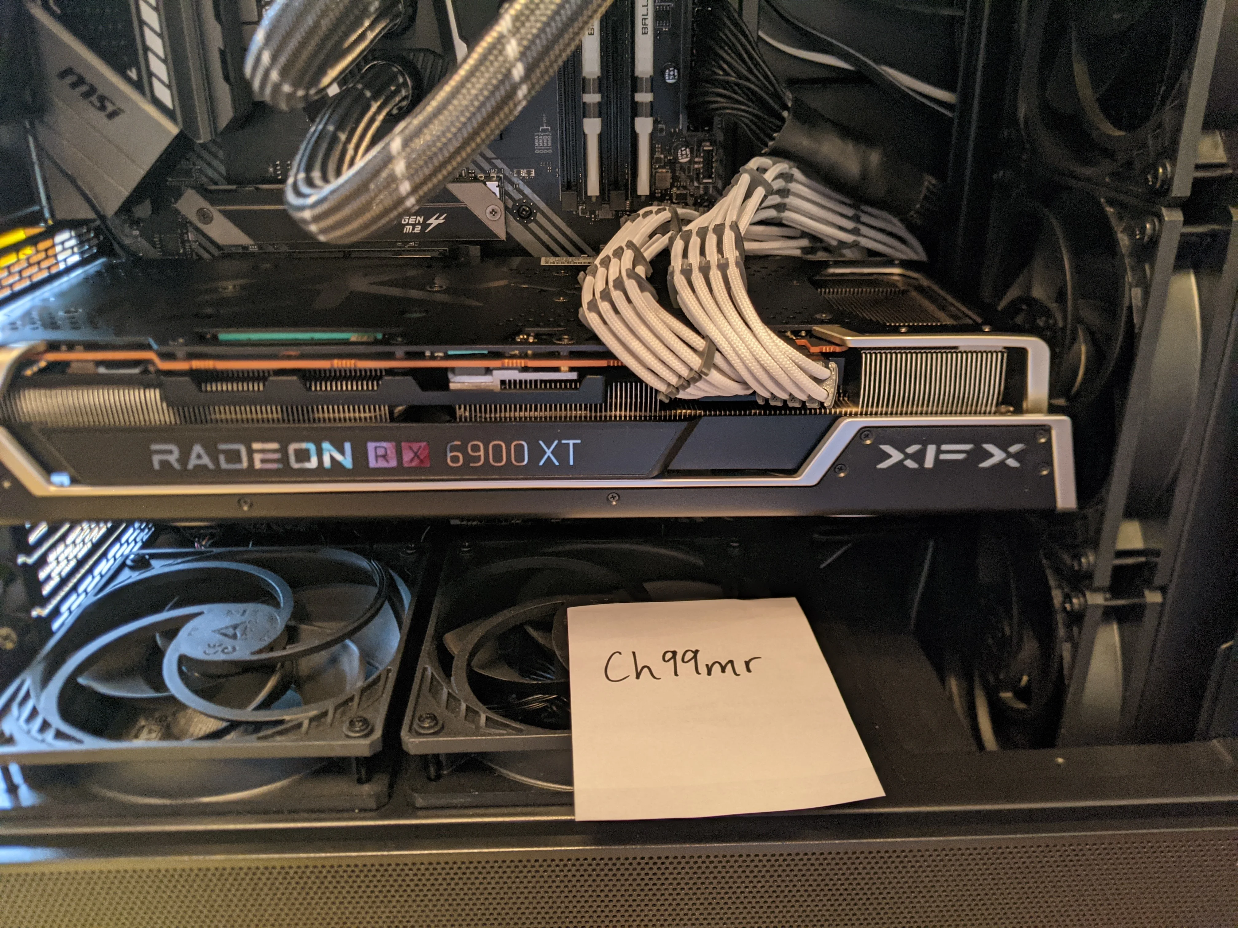

To update on my coil whine (reference card branded by sapphire), it was returned and the retailer agreed it was faulty (the whine actually got worse and was audible at idle). They refunded me as they had no more stock and no idea of when more stock was due. They actually got more stock a few days later but at a higher price so I left that. Then these showed up yesterday at +£49 over what I paid for the reference card so I went for it...........
Please ignore the cable mess, the card is huge and I've had to move the radiator and the cable tidy thing off the rear as it just wouldn't fit. I think I might go back to the fractal R6 as that has a lot more room. The card is nice a quiet and runs really cool. I haven't had much time to mess around with it yet but it seems like the performance bios on balance settings gives better results than the stock card and runs around 15 degrees C cooler. The performance bios doesn't like undervolting though.

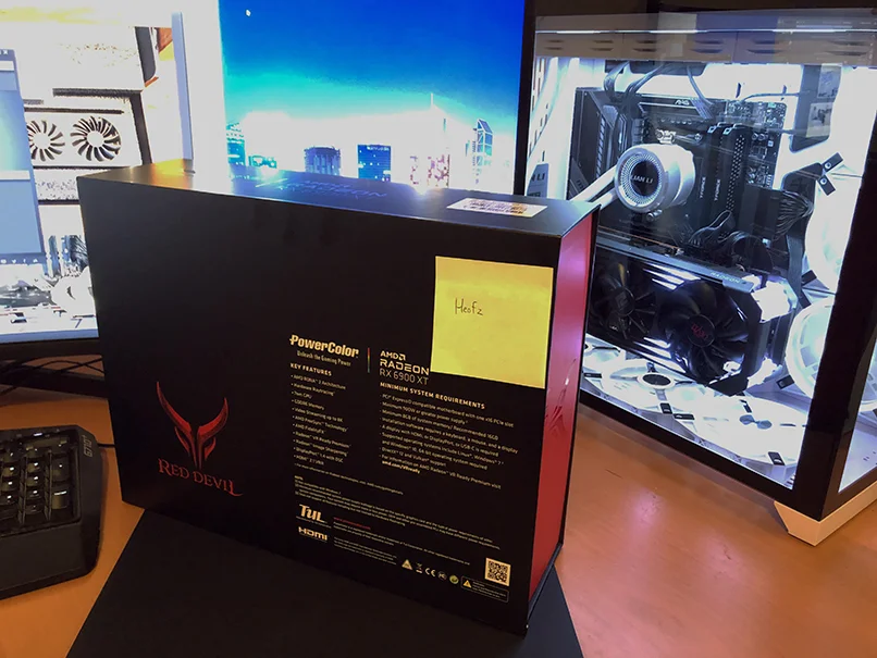

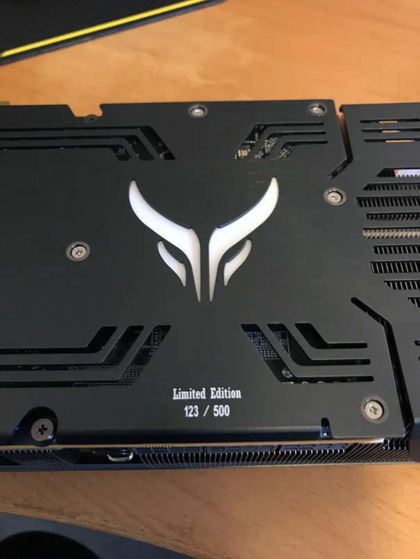

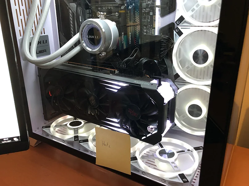

Finally :D
Red Devil 6900 XT Limited Edition (123/500):

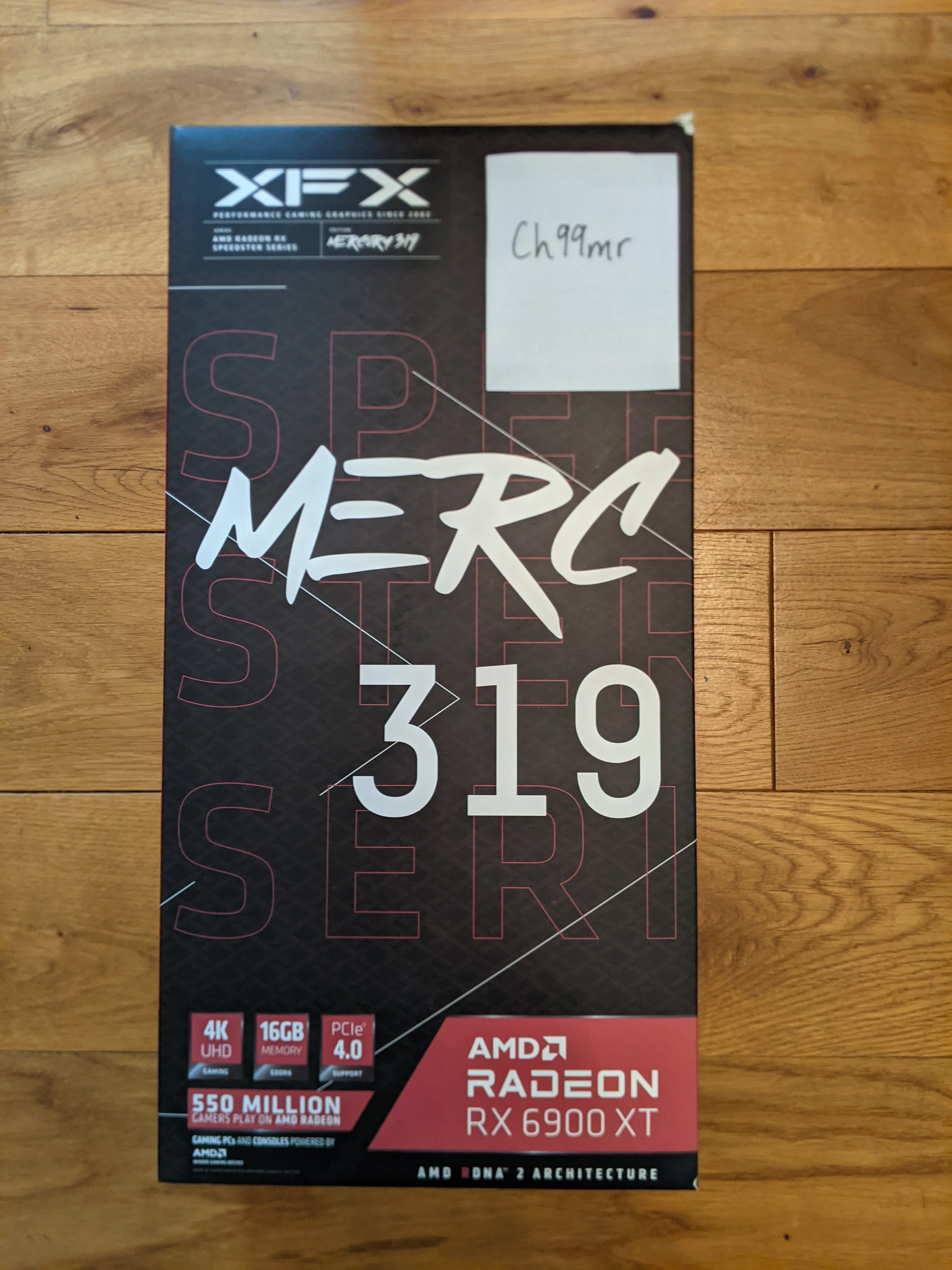

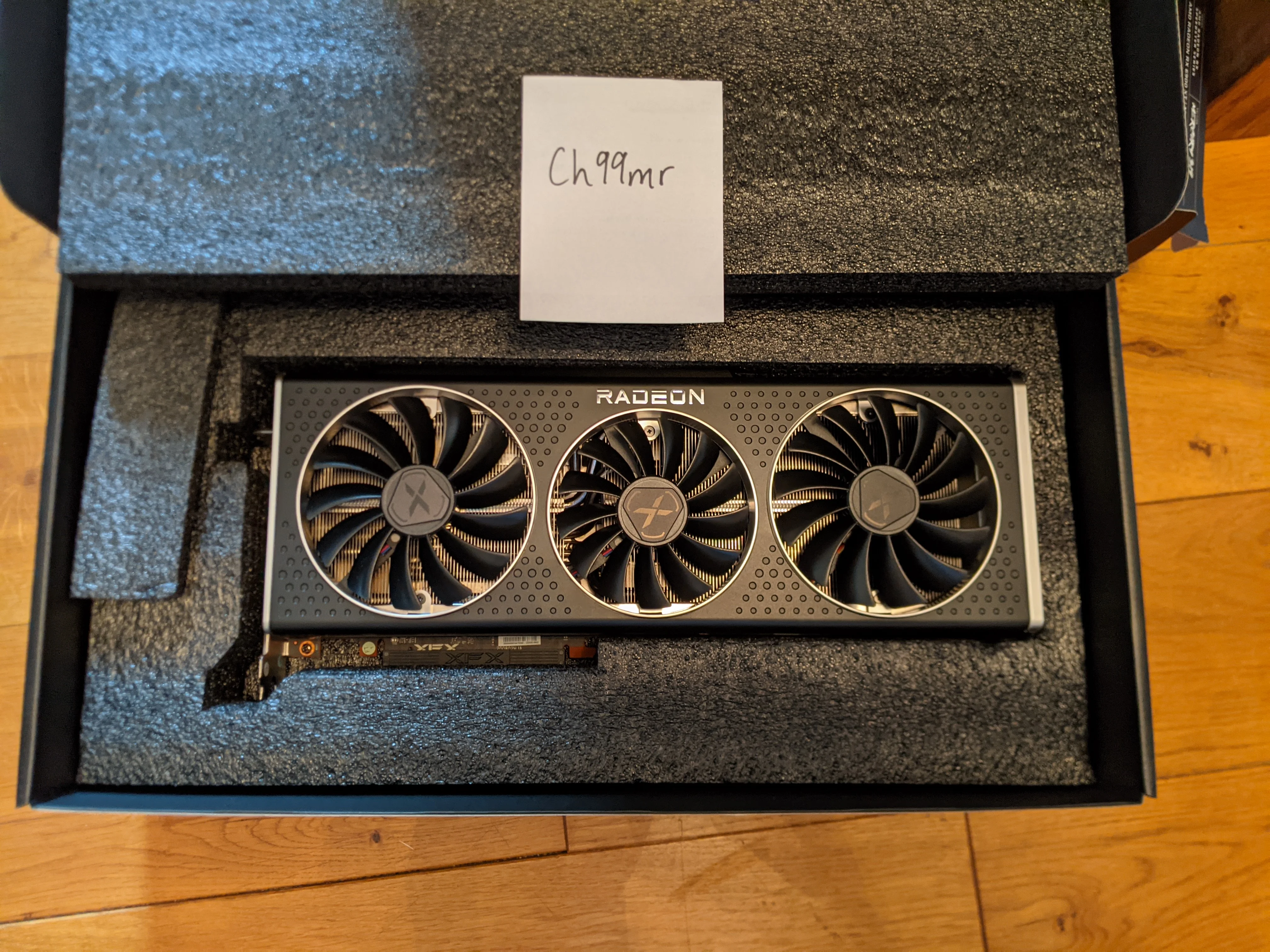

I am so curious where you managed to get a XFX Merc 6900 XT in the UK!
Sadly from the Overclockers, Electronic competition.
I have to admit it was only by luck, I managed to snag one.

Just tried out your pro.2 quiet setting you gave me the link for eairler. My isp wouldn't let me dl them so I just used your screen shot. Ran the MPT.
This is halfway through Superposition benchmark @4K optimised. Seems like she likes the settings and is holding up good.
Sorry about the phone shot. It wouldn't let me screenshot from within the program.

I’ll upload them to my one drive tomorrow mate, that’s some weird ISP you have. If you don’t use my original profiles the voltage might be wrong.Hard to tell. You’d need to display the voltage on your OSD. It’s not available yet in Afterburner if that’s what you are using. HWinfo64 can show you the voltage via OSD.

Yeah, its Vodafone. I`ll try HWinfo, already have it on here.
Thanks. any particular Game/Benchmark you`d like me to run??
Been on Pubg about an hour and a half now.
Card never really getting above 67c
Junction 75c.
2437Mhz GPU 2102Mhz Mem.
Not dropping more than 130FPS at 1440p Ultra Maxed out.
(LtMatt's "AMD Profile 2. Quiet")
(MPT settings enabled).
GPU-Z Showing Max Power draw 297W.

Looks good! What voltage is it using in game?
