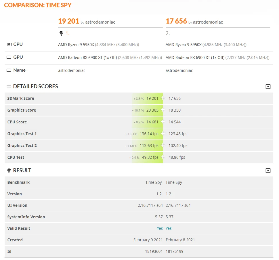

Alright chaps so, I managed to get it to work with the "Write SPPT" method.
Set Power GPU Limit to 350
Set TDC Limit to 330
Left Wattman at 2600 Core clock, 2100 memory def timing, Power +15% and I set the fan curve to a bit more aggressive.
Now the GPU stays at 2600Mhz constant and that's made a bit of a difference
It is true, if you enter values that somehow are not compatible with the Wattman's arbitrary logic, there will be all sorts of trouble, including the core clock stuck at low frequency. Happened to me where it got stuck at 400Mhz.
All in all I'm happy.:)

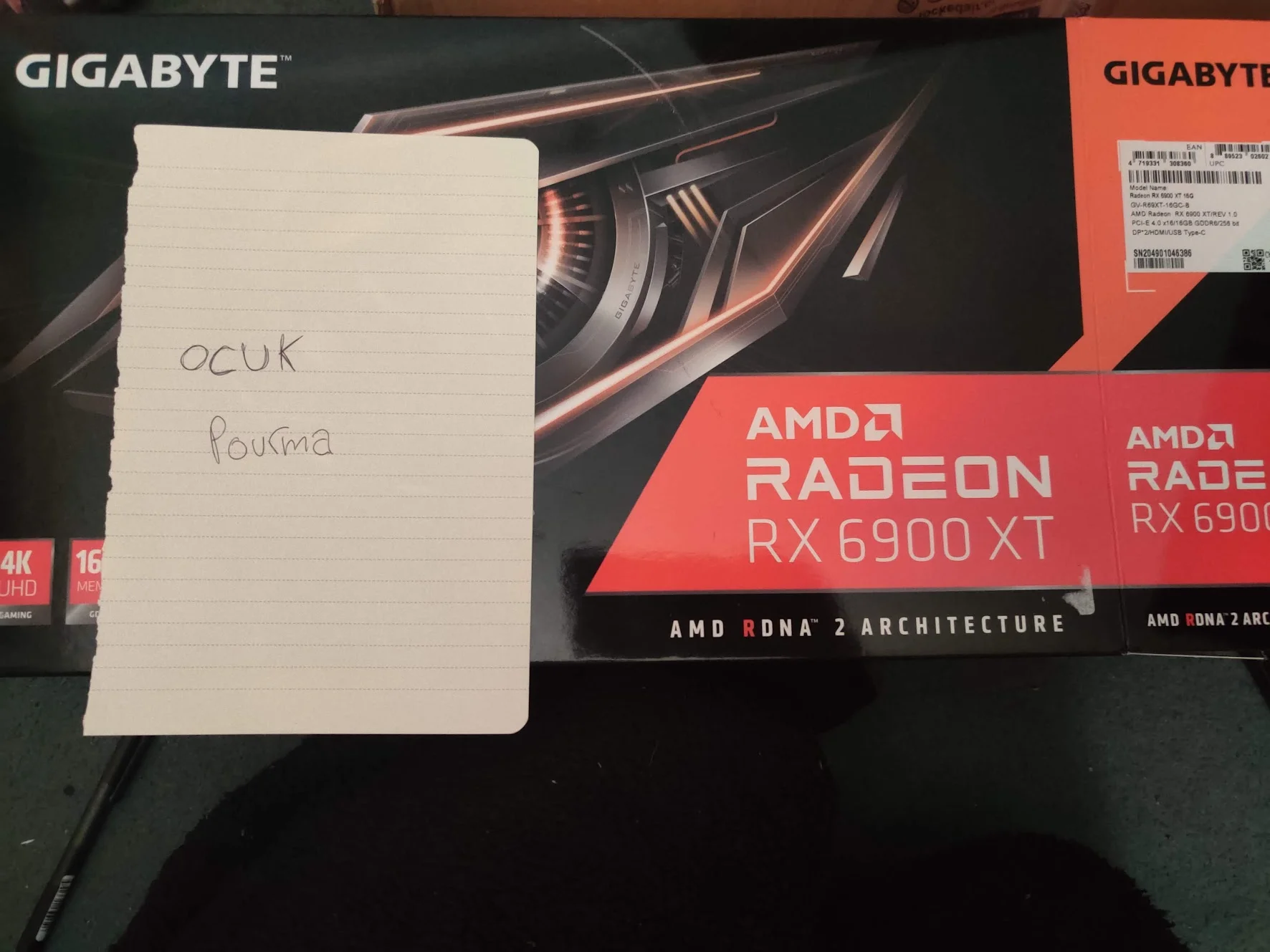

Please can I be added
Image seems to not be working, direct link.
https://imgur.com/a/7A7xZP0
7A7xZP0
Welcome and on TROH.:)
The Roll of Honour.
Date 09/02/2021, Make AMD Reference, Pourma, Link
