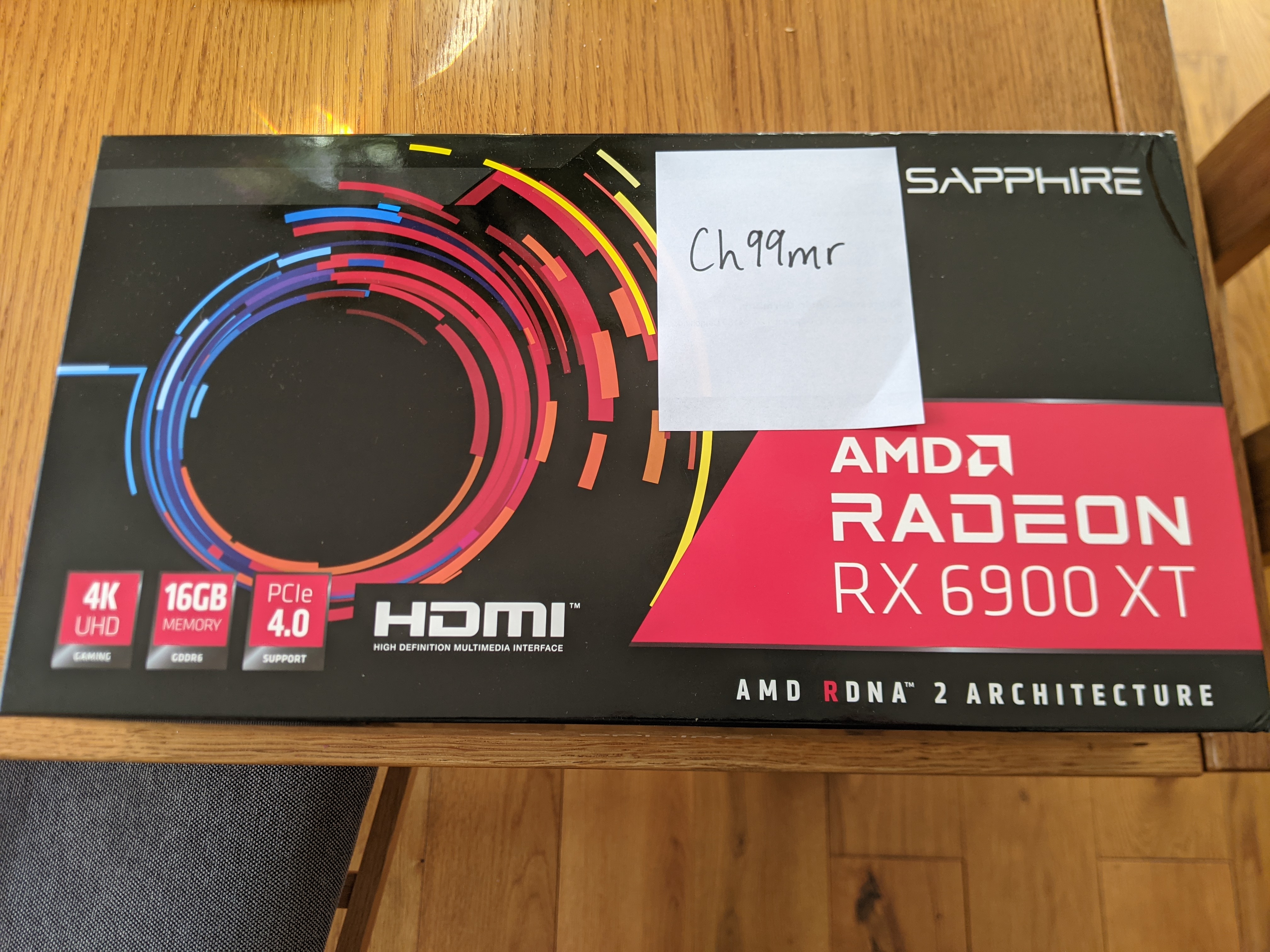

I bought a sapphire 6900xt the other day. It's just the reference card in a sapphire box. I have pretty bad coil whine as well. It has reduced a little in the last few days but it's the loudest coil whine I've ever heard.
https://imgur.com/a/JkyZDSr
