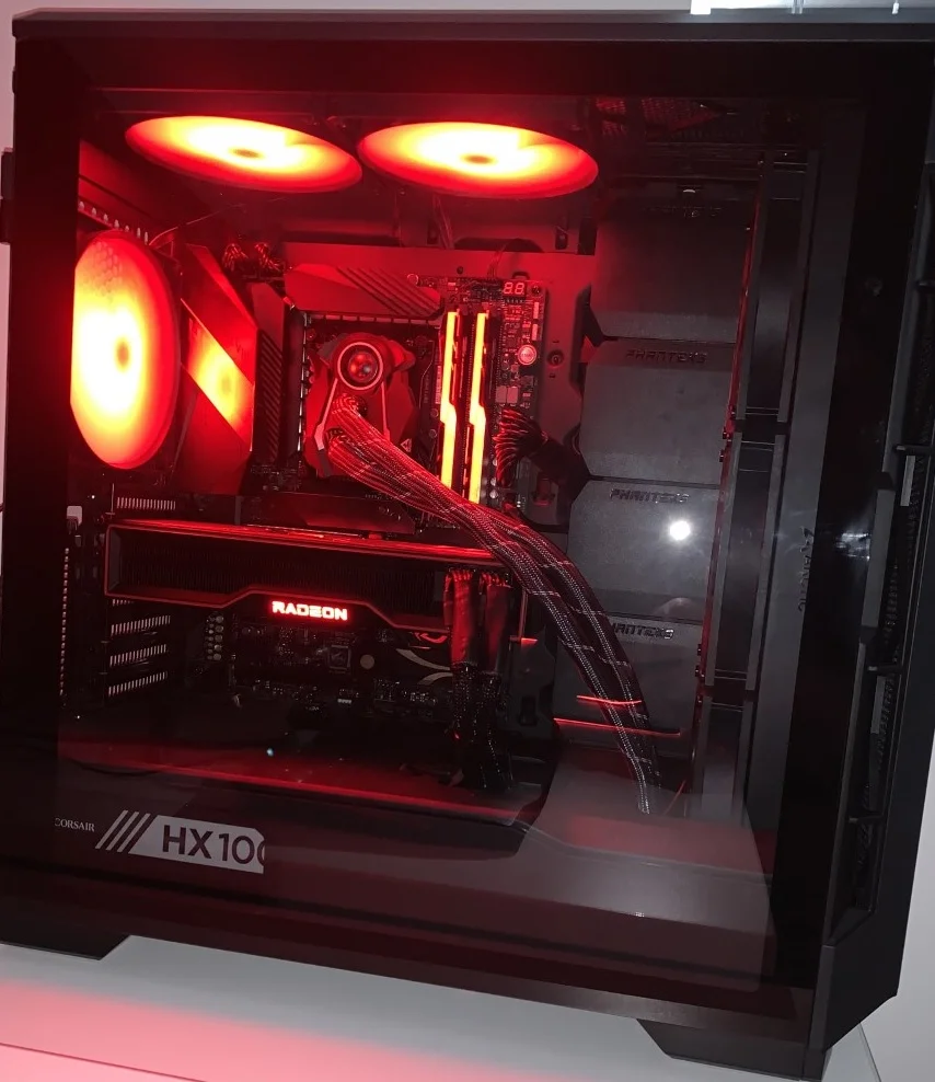

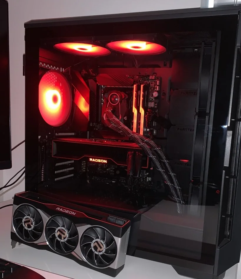

No, I'm using the reference coolers on both. :)
@Kaapstad updated pic for the roll of honour please.
